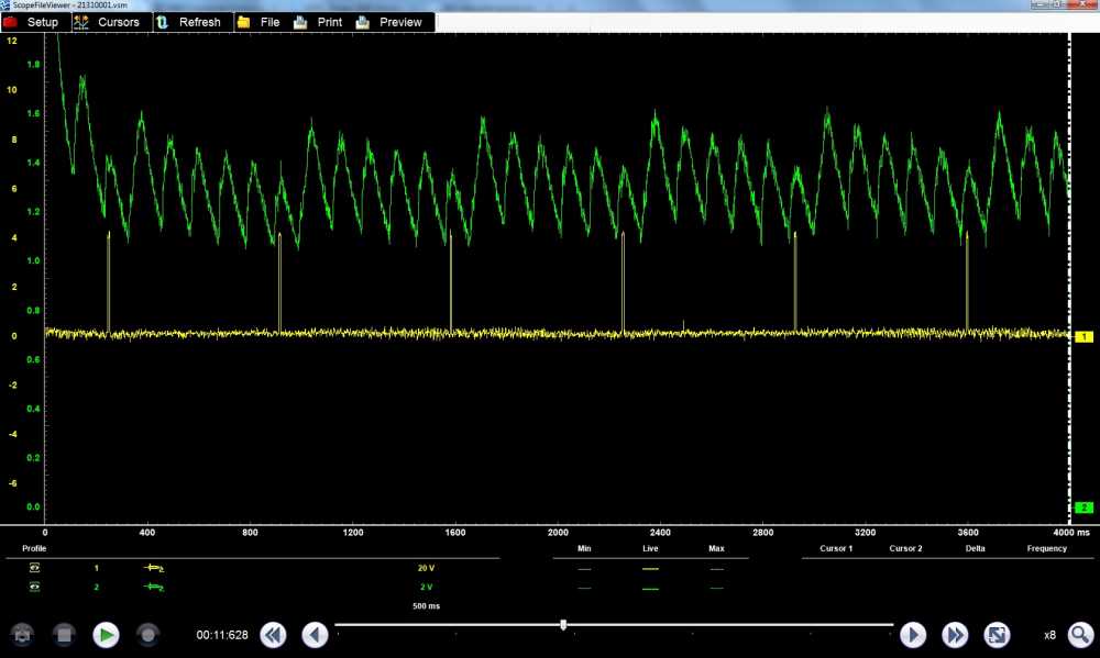

Congratulations on getting your scope! :cheer: Personally, I'd get a low amp probe first, and worry about the high amp probe later (or never). I've always used a low amp probe for relative compression on gasoline engines, and never had any problems. Diesel is another story, due to higher starter current draw.
This is a capture I took off a GM 3.6L, with an AESWave low amp probe .
This was taken with a 2V scale on the compression trace, so no attenuator was required. B)

Thanks for the speedy reply. Could I ask what a compression trace is?

Sorry if I wasn't clear on that one. :blush: Was referring to the relative compression scope trace, the green line on the scope capture.

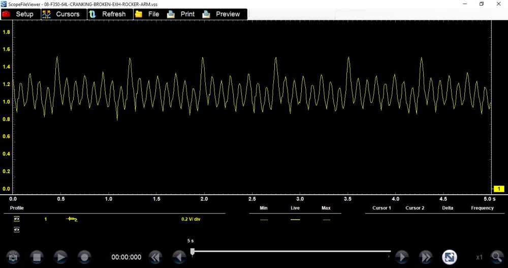

I've used my Snap-On low amp clamp a few times on Diesels with no problems.
The above was taken off a Ford 6.4L with a broken exhaust rocker arm. This is how I test compression on all the Diesels I work on, I don't even own a Diesel compression tester. Just use the relative compression test.
