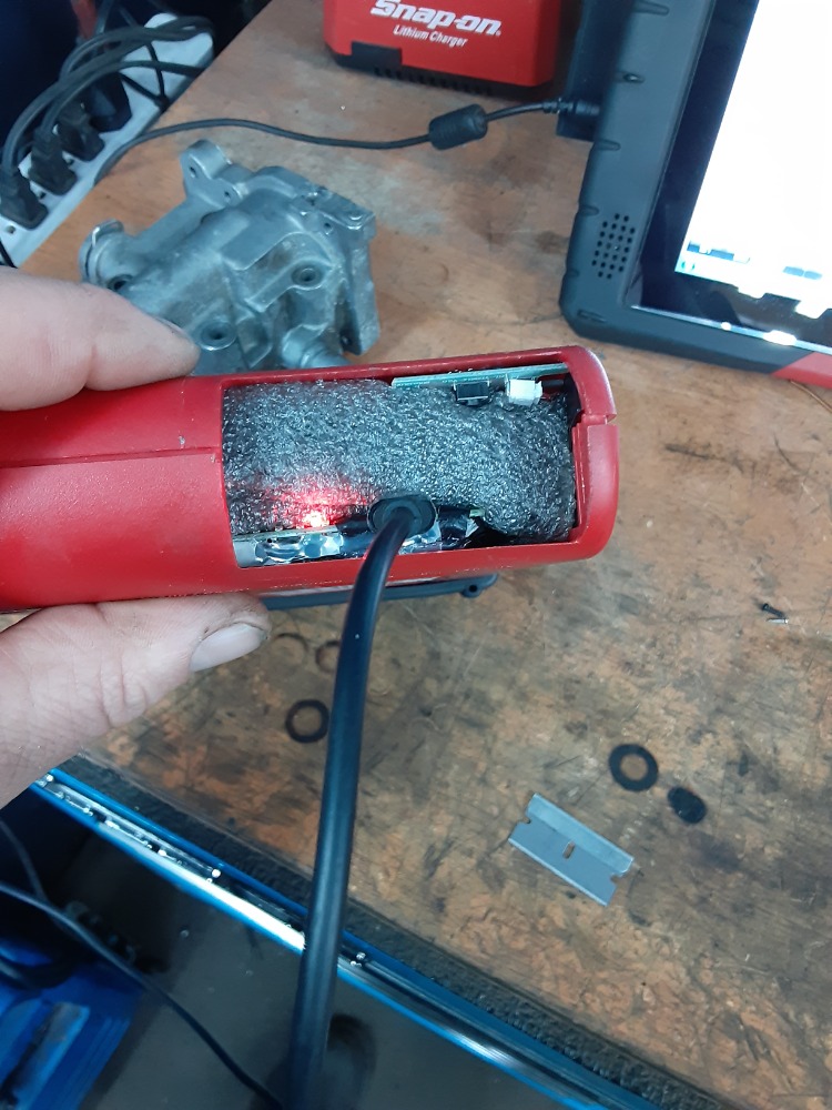

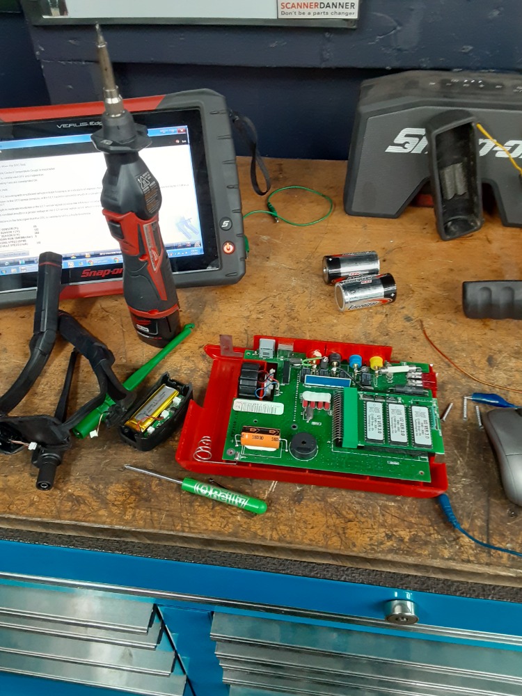

So my MT2400 was crying for new D batteries AGAIN.
And I had a broken, taped together Snap-On neck lamp hanging around.
So I repeatedly smashed them together until the two tools were integrated, resulting in an abomination that is now rechargeable (and two D cells lighter)
Still in proof of concept stage so to speak.

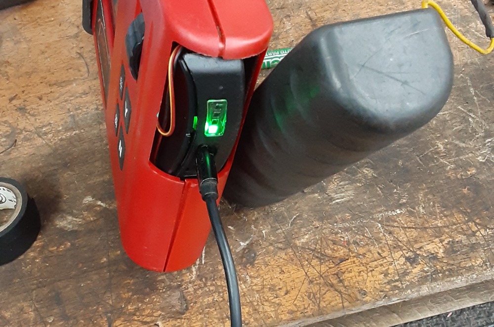

5 years 5 months ago - 5 years 5 months ago #48056 by Noah
Replied by Noah on topic Keeping The Vantage Alive!
It will probably stay like this for the foreseeable future.
Gets about 6 hours of on-time.
Not great but more than adequate considering I can charge it between uses if needed or even use it plugged in.

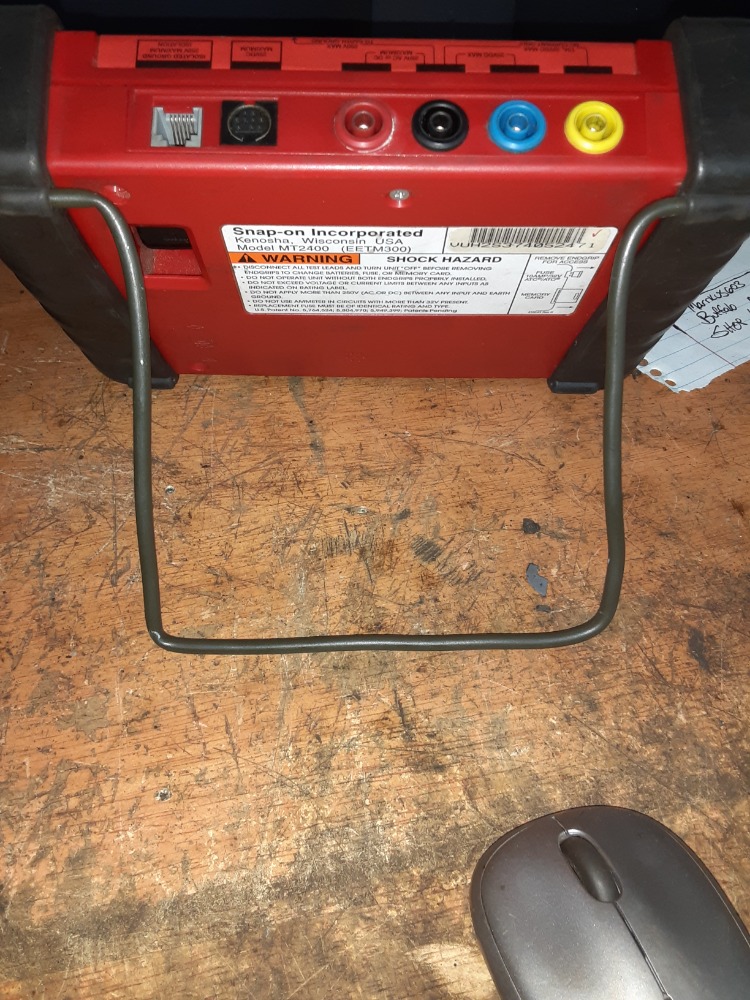

5 years 4 months ago #48284 by Noah
I gave it a fancy kick stand too with some 3/16 brake line.

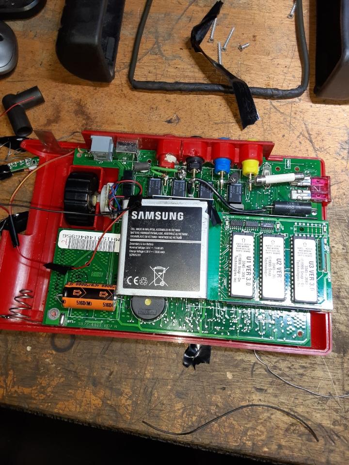

4 years 10 months ago - 4 years 10 months ago #52359 by Noah
Well, I kilt it...
​​​​​​ Got six months out of that crap ass flashlight battery.
Eventually I'll (begrudgingly) spend money on some new rechargable battery set up. But until then, I have a cell phone with a broken screen and a perfectly good battery!
You know the trick, smash them together to the point of integration....

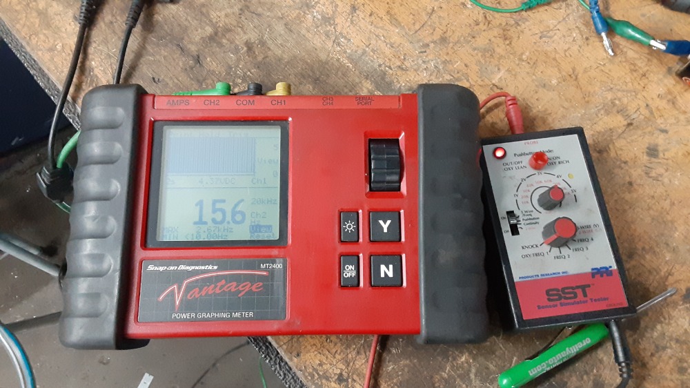

4 years 10 months ago - 4 years 10 months ago #52363 by Noah
I have questions! :woohoo: Dead sick and tired of feeding D-cells to my Vantage every week.
What's the voltage requirement of the Vantage? What's the output of that cell phone battery?
I've thought about buying a rechargeable 18650 cell and making it fit into the Vantage case. Any reason this wouldn't work?
I don't know! Noah smash!!
​​​​​​One D cell is 1.5v so 2 is 3v and the Samsung displays nominal voltage of 3.8v. Fully charged it measured just over 4v and ran the Vantage while measuring it's own battery voltage in graphing mode for 6hrs 45min.
Still using the charging board from the Snap On neck lamp.
