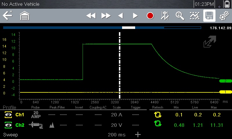

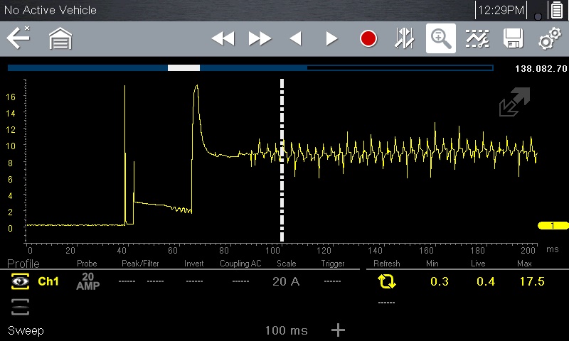

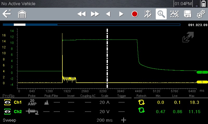

5 years 10 months ago #45811 by Tyler
HID module known good:
HID module cut bulb:
HID damaged module:

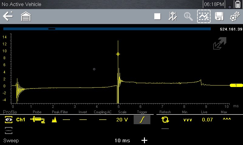

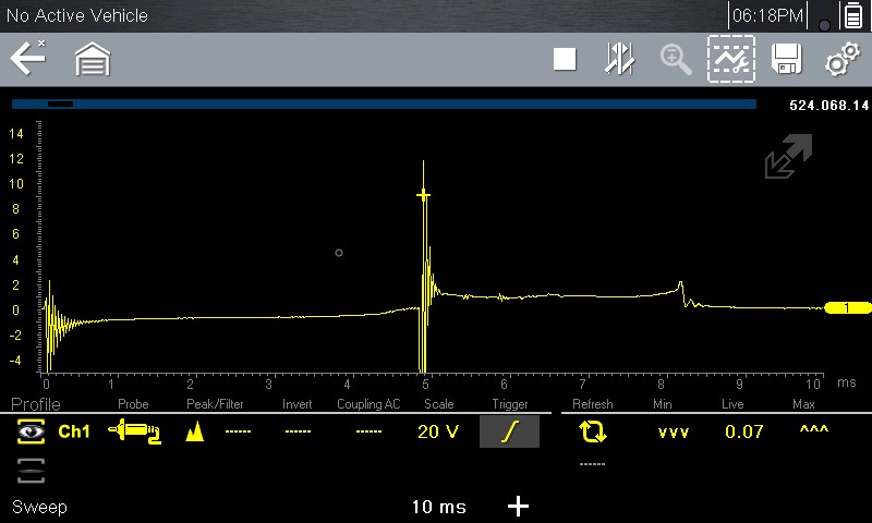

5 years 10 months ago #45930 by Tyler
Replied by Tyler on topic Re:Re:Video Chat Diag Meetups
OEM NGK plug:
Autolite plug:
