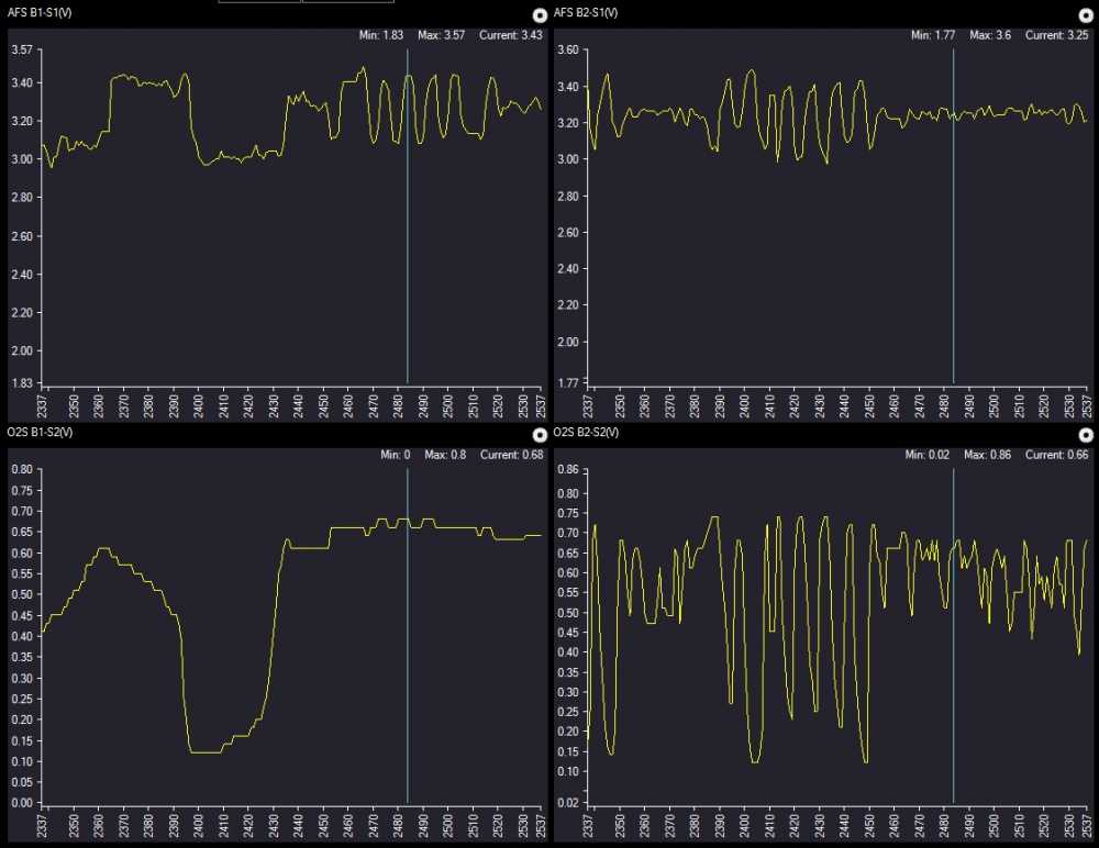

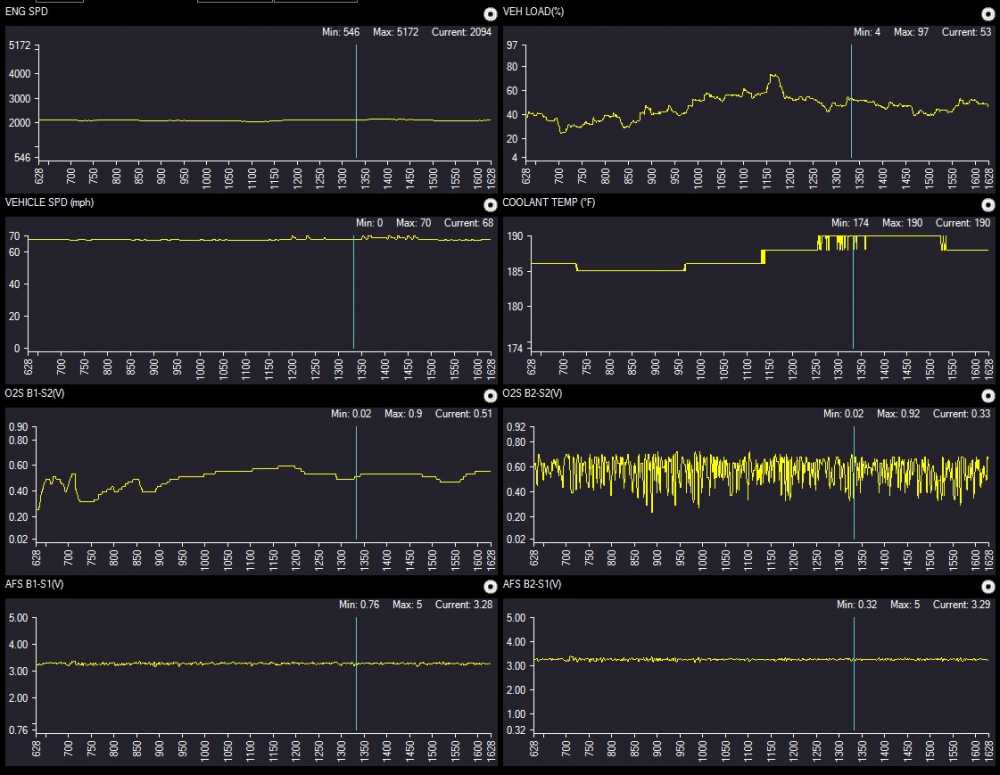

9 years 9 months ago - 9 years 9 months ago #5710 by Tyler
Hey John, welcome to the forums! I moved this to the Diagnostic tools & techniques section, FYI.
About your Odyssey... I can't say I can think of a way you could have been more sure about your sensor replacement call. :unsure: Obviously, the PCM was happy enough with their performance (no codes), but there was clearly an improvement afterwards. I've seen A/F sensors stick full rich or full lean, but never one that simply became... skewed? That's the best word I can think of to describe it. :lol:
It may be that, like conventional O2 sensors, that the sensor element degrades over time. Not in it's response time, but in it's stoichiometric reference. I wonder what a five gas analyzer might have told you? If the mixture truly was 10% richer than it should've been, then I'd think it'd show elevated CO readings. Just speculating.
About catalyst testing with A/F sensors, that I can answer! :lol: It's far more straightforward than you might think. The old strategy of watching for the downstream sensor signal switching during a steady cruise still broadly applies. Even though the signal from an A/F sensor doesn't switch lean and rich, it's job is still to keep the mixture at stoichiometric (except for those times the PCM commands different mixtures, but that's a separate issue). Therefore, if the catalyst is dead, then the downstream O2 will reflect the mixture hovering around 14.7/1.
Here's a couple examples. This one is a capture I took off an '06 Tacoma with a stored P0430 B2 cat code. The A/F sensors are at the bottom, and the O2's directly above:
The B1 downstream O2 is very smooth, as it should be, but B2 is all over the place! As another example, here's one of the PCM's active catalyst tests. Watch the PCM intentionally jam the mixture rich and lean rapidly (as seen in the A/F sensors), and look how the downstream sensors respond:
The B1 downstream barely noticed that anything happened, but the B2 downstream followed the mixture changes step for step. Stick a fork in it, 'cause it's done. ;)

Thanks for the scan data examples. It verifies what I thought I'd see in the case of a bad cat on a wideband system. Am I correct in thinking that I'm basically looking for similar switching on the downstream sensor? That's how it appears in your scan data shots. I changed my A/F sensors just so I wouldn't get any personal experience on it! I follow the Odyclub.com and Piloteers.com forums fairly regularly and I see people often get P0420/0430 codes out of the blue (with relatively low miles, i.e. 120K, etc.) and often wonder how that happens without any other codes beforehand. Is it from oil burning, poor quality fuel, or is it from these wideband sensors pushing up the fuel trims, as in my case, and the excess fuel deteriorating the cats. A +20% fuel trim seems high to me but Honda decided not to set a code until at least 25%. I'd just hate to learn about a bad O2 by getting a P0420/0430 first.
