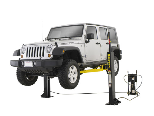

I have the Max Jax 2 post lift. The lift is perfect for low ceiling applications. Best of all you can move it and store it away. If you need it wider or narrower you can make several anchor points in the floor and install it in any configuration you need. It will lift 7000 lbs and allows 4ft clearance with no plates running along floor. It is a great lift!

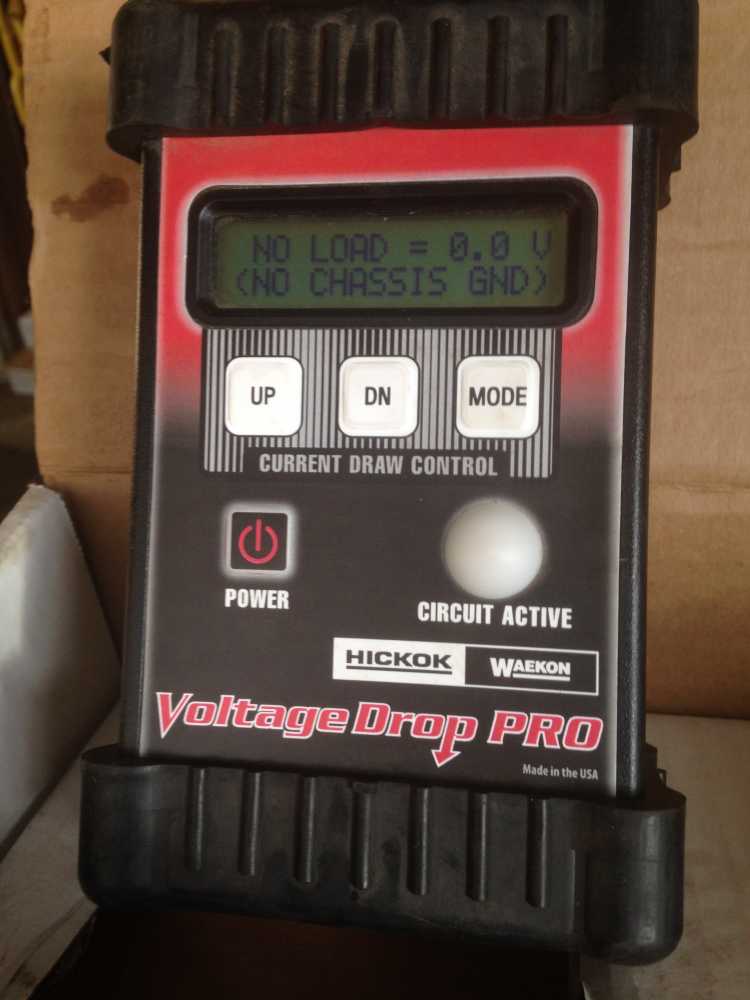

Has not changed my life but a nice tool I use it by removing component and putting tester in it place can select from 1 amp to 20 amp load and use on 3 volt to 16 volt systems

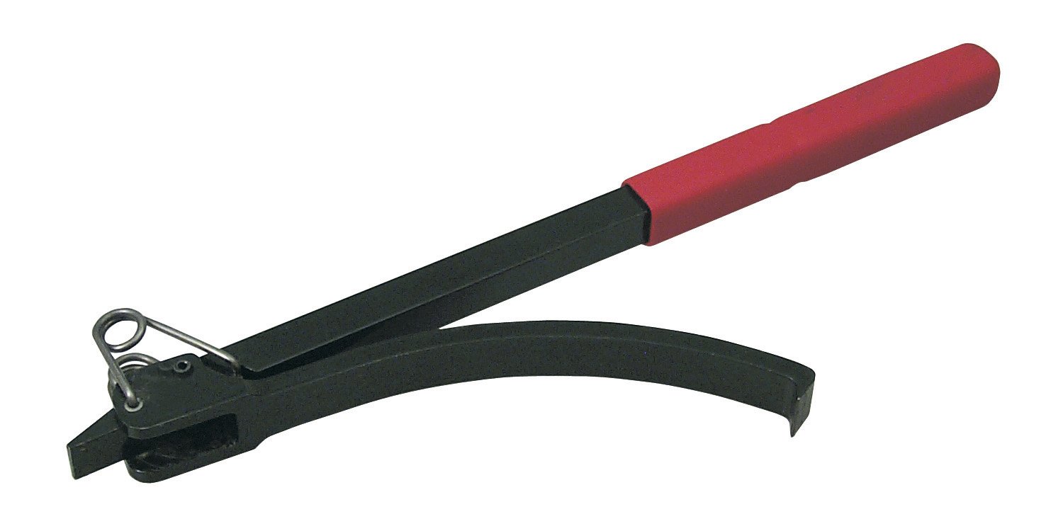

Who knew they made tools specifically for turning flywheels/flexplates? Not me, not until my boss showed me this one:
Light years better than spending forever working the engine around with a prybar. B)

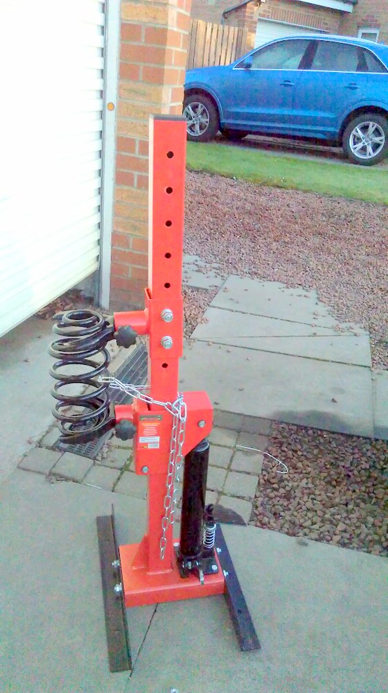

I just bought this I used on a Nissan Note strut, which is a difficult strut to compress safely --- worked like magic a lot of time saved.

Wow. That looks like a super handy tool for struts!

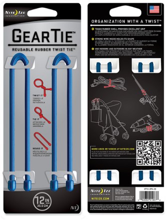

Something I found to be super convenient was these:
Perfect for hanging brake calipers, tying hoses out of the way, hanging flashlights, all kinds of stuff! I keep two on the side of my cart.

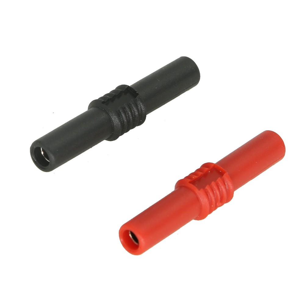

Life hack alert --- my dirty secret is for speed I often use this for checking 5v reference and 12v supply istr it was £5 from Lidl
