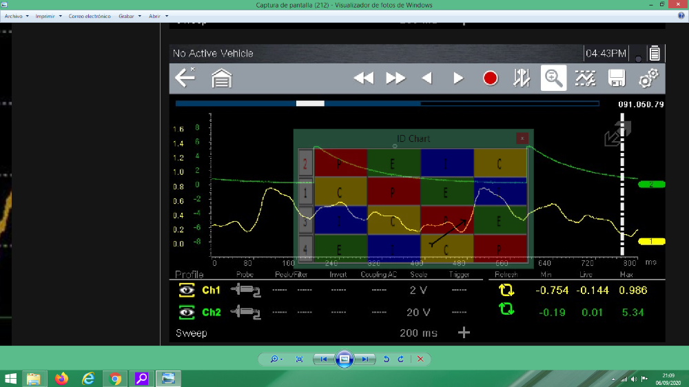

5 years 11 months ago - 5 years 11 months ago #42823 by Tyler
Which cylinder is blown? was created by Tyler

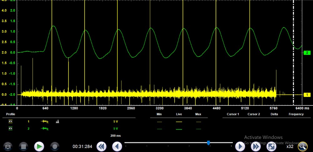

'02 Honda Civic 1.7L
Cody's pulse sensor installed in the radiator on the yellow trace. Ignition coil #1 control in green.
It's pre-Labor Day weekend. It's hot, you're tired, and out of f***s to give. You can pull one spark plug to (hopefully) see coolant in the cylinder and 150% prove the blown head gasket.
WHICH ONE DO YOU PULL?

What scope are you using? I noticed the interface seems a little different to me compared to what I’m used to seeing.
  • Tyler's Avatar Topic Author
5 years 11 months ago - 5 years 11 months ago #42826 by Tyler
Replied by Tyler on topic Which cylinder is blown?
The captures were taken a Snap-On Triton D8. These are direct screenshots. I can post the .VSM files if it'd help.

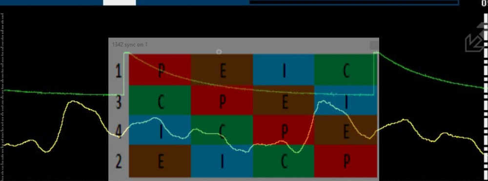

5 years 11 months ago #42831 by Chad
Replied by Chad on topic Which cylinder is blown?
#2
  • juergen.scholl
  • juergen.scholl's Avatar
  • Active partschanger
5 years 11 months ago #42833 by juergen.scholl
Replied by juergen.scholl on topic Which cylinder is blown?
I'd pull #4 as the pressure rise coincides with this cylinder's last 30 to 40 degrees of the compression stroke.
5 years 11 months ago #42837 by Chad
juergen.scholl wrote: I'd pull #4 as the pressure rise coincides with this cylinder's last 30 to 40 degrees of the compression stroke.
You have clylinder #2 as the sync cylinder.
Tyler is synced on Cylinder #1.
  • juergen.scholl
5 years 11 months ago #42838 by juergen.scholl
I misread the sync. With the sync on #1 as in your picture cylinder#2 is the faulty one.
5 years 11 months ago #42947 by Tyler
Points for both of you. :cheer: #2 was absolutely steam cleaned.

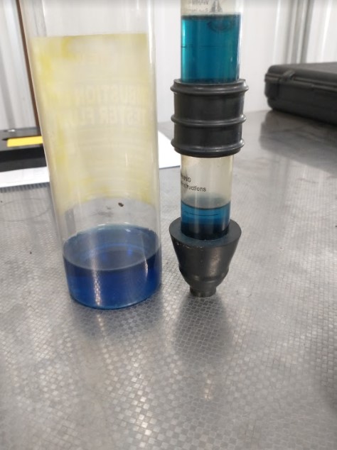

To be honest, I actually pulled #4 first. :blush: It's been my experience that, when using the pulse sensor on cooling systems, there's usually a significant delay between the problem cylinder going to TDC compression, and the pulse showing up at the sensor. But this one seemed to be pretty direct! :silly: Smaller cooling system, maybe.
"But Tyler, why didn't you just use the head gasket tester and stick a fork in it from the beginning?" Well, I did:
5 years 11 months ago #42970 by Noah
Replied by Noah on topic Which cylinder is blown?
I try explaining to the boss that when it comes to the chemical test, fail is fail. Pass is just inconclusive.

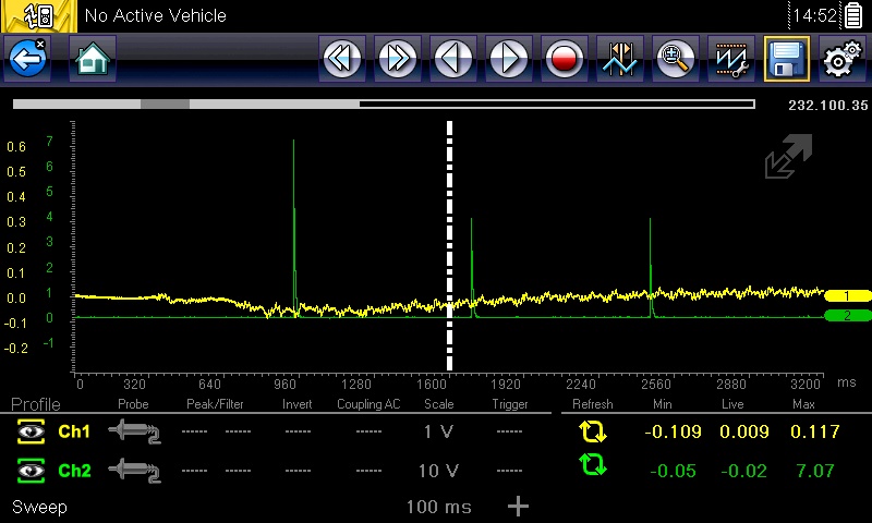

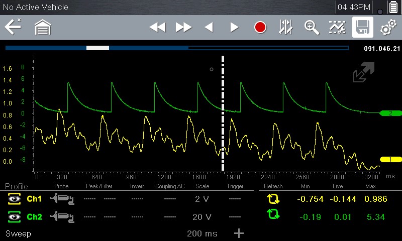

5 years 11 months ago - 5 years 11 months ago #43000 by Tyler

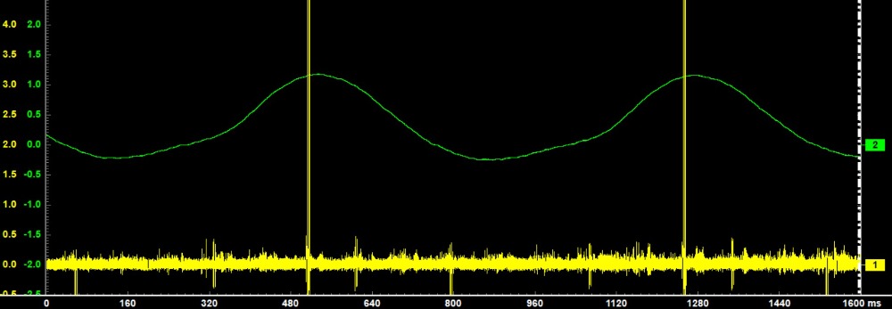

Noah wrote: Do you find the pressure pulse on the rad to be a worthwhile test?
Not at first? But after I caught a few failures, I got a lot more comfy with it. Nowadays I'll sometimes do it before, or completely in place of, the blue water test.
I've also been experimenting with using a manometer in place of the pressure pulse sensor. Failing vehicles generate enough pressure in the cooling system to get picked up as inH2O, but not enough to move the needle on a cooling system pressure tester.
If it helps, here's a comparison shot of a GMC 6.0L that is not blown (as far as I know, anyway):
You can see the typical 'noise' that Juergen was referring to.

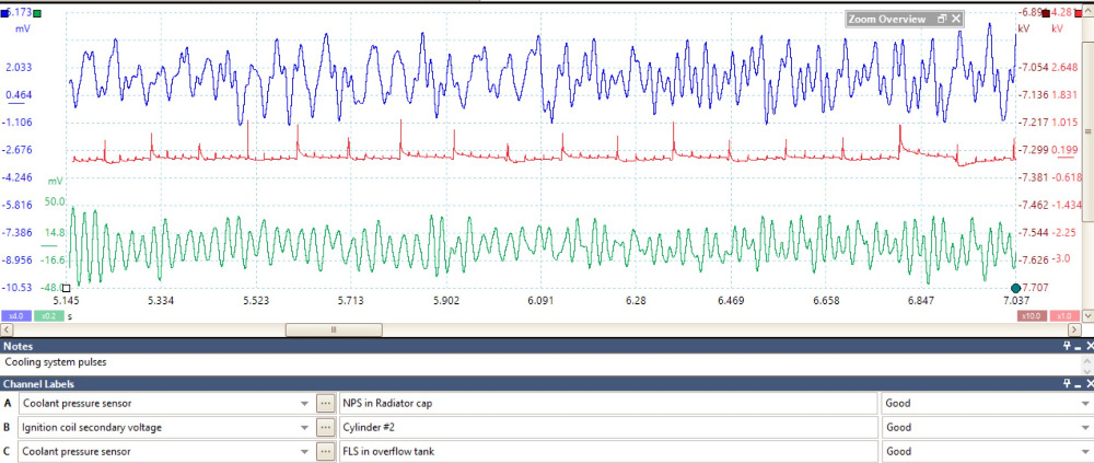

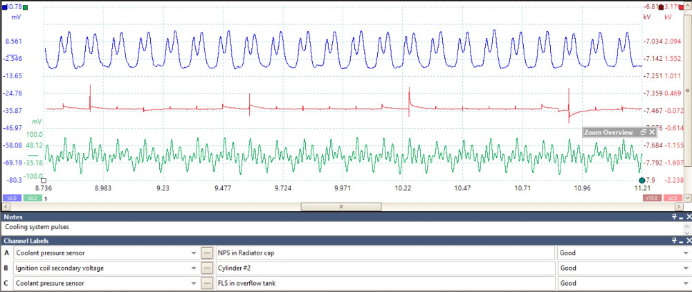

I decided to do some, long over-due, cleaning and organizing of my waveform Library, this morning. I found this capture for a Chrysler Cirrus 2.5L cooling system pulses. There is nothing wrong in this capture. I was just playing around. I was comparing testing locations. And, comparing CRANKING vs. RUNNING. The BLUE trace is a Nicholson Pulse Sensor (NPS) located in the Radiator cap. The GREEEN trace is a First Look Sensor (FLS), placed in the Overflow tank. As you can see in the cranking waveform, location of the sensor affected the shape of the pattern. And while the engine is running, it becomes a VERY turbulent/dynamic environment.
Engine Cranking:
Engine Running:

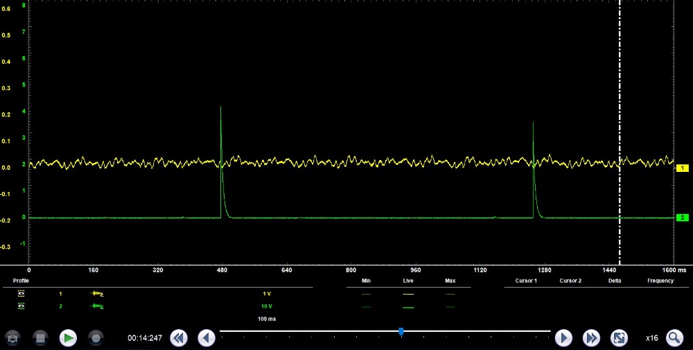

5 years 10 months ago #43749 by Tyler

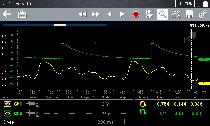

2002 F-150 5.4L, overheating complaint. Blue water instafails. :silly: But I throw Cody's sensor on anyway, 'cause why not. Sync on #5.
Which cylinder is blown? It's not a test - I honestly don't know! :lol: It's an expansion tank system, too, which (in my opinion) adds a delay between TDC on the blown cylinder and a pressure pulse at the tank.
5 years 10 months ago #43750 by Matt T
Replied by Matt T on topic Which cylinder is blown?
Tyler wrote: Which cylinder is blown? It's not a test - I honestly don't know! :lol: It's an expansion tank system, too, which (in my opinion) adds a delay between TDC on the blown cylinder and a pressure pulse at the tank.
Yeah the small hose running to the tank, and the air volume in the tank, could be delaying and smoothing out the signal. Filling the tank full might give a sharper pulse?? Would still be a tough call on an 8 cylinder though.

Matt T wrote: Would still be a tough call on an 8 cylinder though.
That's where I'm at. :unsure:
