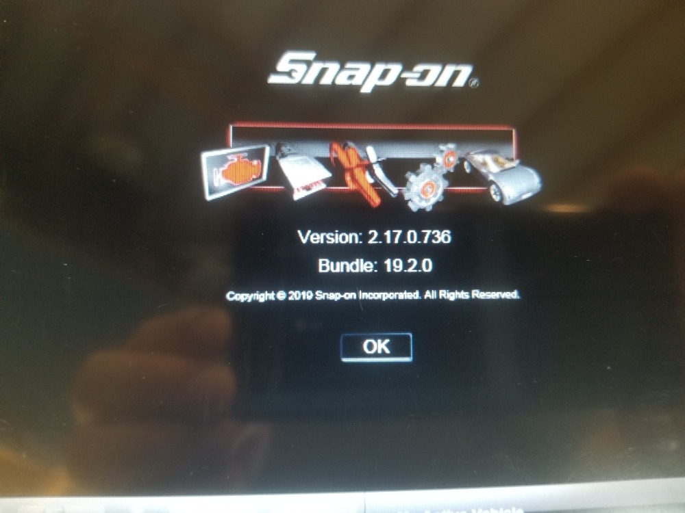

My dealer has a used Versus Pro for sale. Its just the scanner, m4 scope/multimeter, (no leads) ac power cord and scan module. It has windows xp and the software is Version: 2.17.0.736 Bundle: 19.2.0 The price is $700. My questions are:
1. Can the version of windows be updated to a newer version ?
2. I know support will be phased out in the next two years, so would it be worth the 1k for the last update plus the extra money for the needed
scope/multimeter adapters ?
3. Should I look at something else ? I'm currently using a Launch CRP129, it works ok but I need a better scan tool and I want to stay in the 1k
dolllar range.
dolllar range.

I would buy it.
I don't know about updating Windows, and I personally wouldn't be worried about the software update either.

You're not looking at a ton of money for a basic set of 'scope accesories. The Snap-on leads themselves aren't that expensive and you could use regular DMM leads if you wanted to cheap out. Low amp clamp will run you about $100 from somewhere like AESwave.
People have upgraded Windows on the Verus DIO but I don't see any point in it personally.
Agreed on the Snap-on upgrade. Sinking a grand into a $700 tool right when it becomes obsolete doesn't make much sense IMO. Better to put that money into something like a new Autel, or maybe Launch, when you start running into vehicles too new for the Verus.
Noah wrote: I don't know about updating Windows, and I personally wouldn't be worried about the software update either.
