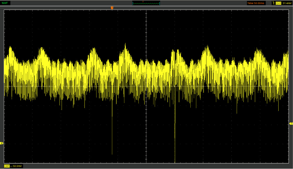

I just purchased my first scope the Pico 2204a. I've been trying it out and finding it's perfectly adequate fory needs except for missing noise filtering. I was hoping just to purchase inline filters but I am not having any luck. I wouldn't mind building them myself but I don't know what combination of resistors and capacitors are needed. Anyone have experience with this?

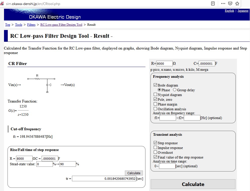

Here's a link to the design tool I used when I threw a RC Low Pass Filter together. I just plugged in numbers for the resistors and caps I had on hand until I came up with a combination that looked like it might work.
sim.okawa-denshi.jp/en/CRlowkeisan.htm

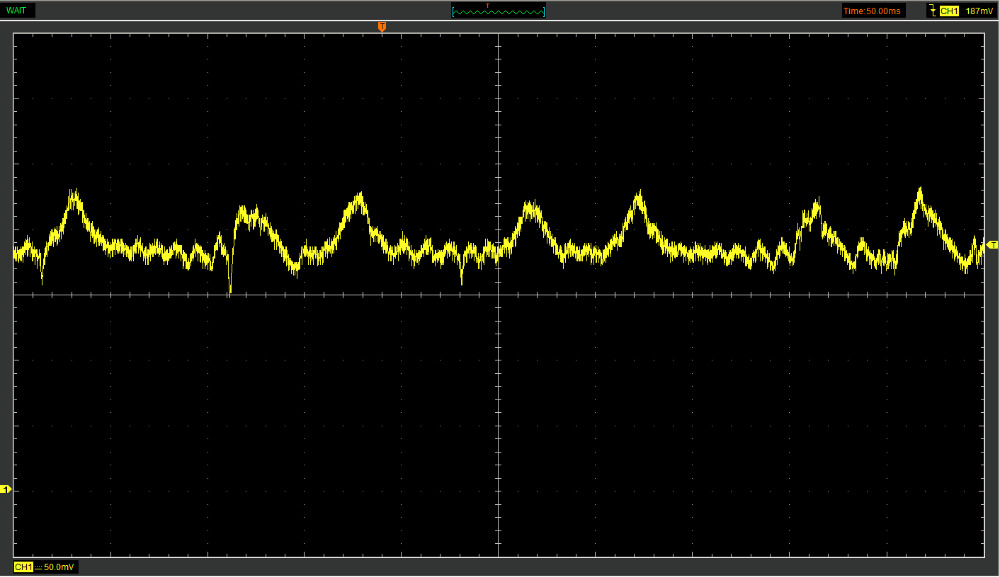

This is what I ended up trying.
Before trace straight DC.
After with the Low Pass Filter.

I'm trying to figure out the balance between the resistor and the capacitor. Why did you choose that value for the resistor?
6 years 3 months ago #41712 by Matt T
Replied by Matt T on topic Noise Filter
hsubdarb wrote: Why did you choose that value for the resistor?
I didn't want to go too high on the resistance, relative to the 1 meg impedance of my 'scope, because that would act as a voltage divider. Beyond that it was just a resistor I had on hand that looked like it'd work with the caps I had. Threw it together with alligator clips to see if it'd do what I wanted and it did. So at that point I just soldered them into one of the spare channels on the Hacktek 1008 :lol:
