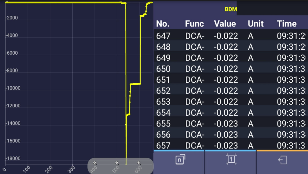

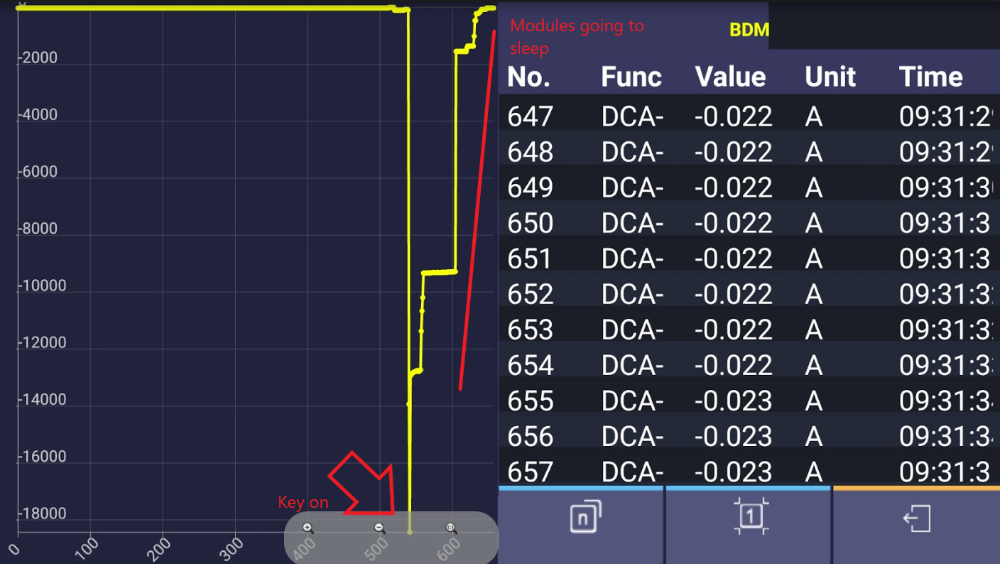

For this example, I'm working with a 2005 Hummer H2. Drain complaint. Measured 120mA initially. After disconnecting enough remote start/alarm/aftermarket crap under the dash, I got the drain down to 23mA. Awesome.
But before I let it go, I want to make certain there's no other 'surprises' in store. That means watching the draw over time. I'm on flat rate, so I ain't got time to stand there and watch the meter. :lol: Out comes the phone and the Owon MultimeterBLE app. I cycle the key and the door locks to establish a baseline (and to check that the fix is repeatable):

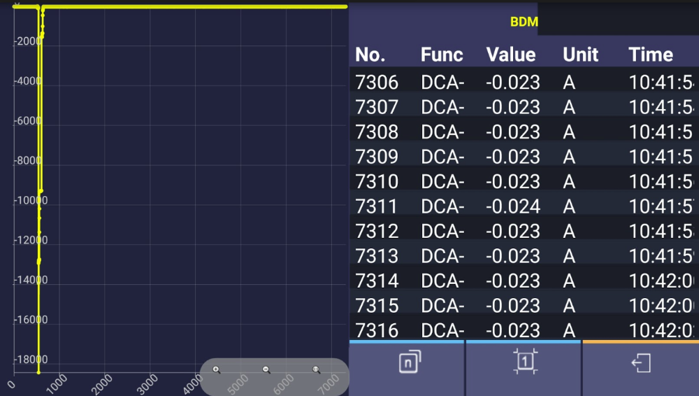

Don't sweat the negative polarity - all the values are accurate. We start out at 18A, then settle out at 23mA after all the modules STFU. I leave my phone on my cart and roll off to other jobs. After an hour, I can see that no other draws cropped up:
Never had to walk back over to the car and check the min/max. The Bluetooth range is long enough that I can watch cars from the other end of the shop, or even right outside if I don't want to occupy a bay. Using the Owon means I can keep my Modis Ultra freed up for other jobs. AND my fix can now be documented with screenshots.

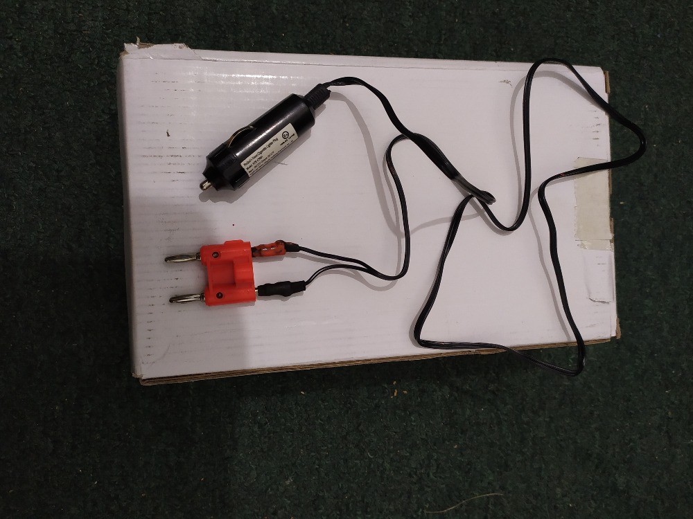

6 years 5 months ago #40474 by juergen.scholl
Replied by juergen.scholl on topic Parasitic drain testing with the Owon
Noah wrote: I like it for that and for starting/charging system from the drivers seat.
This is one piece of hack allowing to check starting/charging from the inside easily with any DMM.
Guess from now on I'll only use it as memory saver.
6 years 5 months ago #40475 by Noah
Replied by Noah on topic Parasitic drain testing with the Owon
That's pretty smart. I've got something similar to that I could be using, thanks for the idea.
