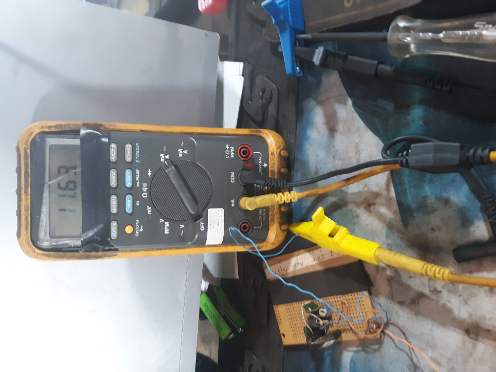

Tyler wrote: And that got me thinking. Would a home made 5V signal generator accomplish the same thing? I don't think it'd have to be a square wave, just a low current that's sensitive enough to get pulled down by a resistive short. Less than 50mA, maybe.

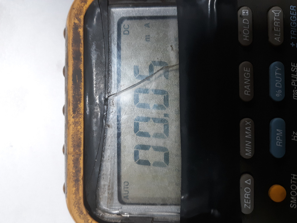

This is a signal generator that I built for bypassing VATS/Passkey. Pulling the signal down with a test-light to ground (27Ω). There was a considerable voltage drop, pulling 11.6 mA.
I added various amounts of resistance and the voltage drop and current flow changed accordingly. Adding 44K Ω resistance to the test-light, still, had a voltage drop of .45 volt, pulling only .05 mA.

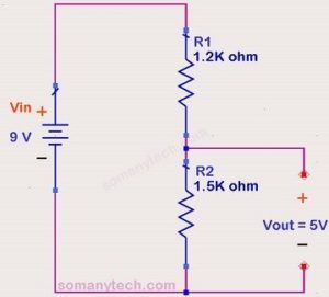

I was initially thinking about making this 9V to 5V regulator? Mostly because I have all of those components at work (except the optional LEDs):
somanytech.com/9v-to-5v-converter-circuit/
But these suggestions are way better. :lol: I wonder how hard it'd be to combine one of these regulators with a voltmeter across the output? That way, I wouldn't need to tie up my scope/meter measuring for a voltage drop. It'd all be in one piece of equipment.

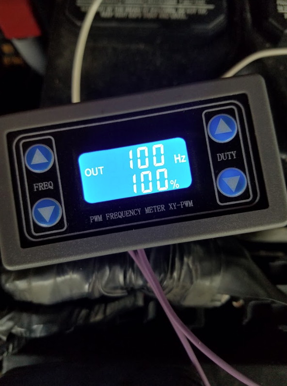

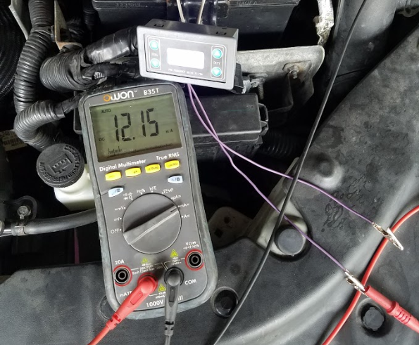

Ended up ordering the DROK signal generator from Amazon, because it's fast and I'm cheap. :blush:
I rigged it up with some spare wire and clips I had on hand for some quick tests. Two wires in for power/ground, one power switched output equal to input voltage, and one steady ground. Because the signal generator is connected to the vehicle battery for my tests, I generally found the steady ground wire to be useless.

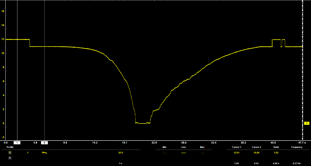

You can play with the duty/frequency, but I generally found myself turning the duty all the way up to generate a flat 12V. With a dead short and a battery at 12.06V, the generator flows 12mA of current:
So what kind of a short does it take to pull that down? I started playing with a 10K ohm variable resistor to see how the voltage would behave:
Cursor #1 is an open circuit, 12V. Cursor #2 shows the resistor connected at 10K ohms. It's clear that even 10K ohms is enough to pull this generator down. :unsure:
For giggles, I dialed the voltage in to 5.01V, then checked the resistance reading. 700 ohms on the nose.
For more giggles, I also tried to run one of my Nissan three-wire ignition coils off the signal generator. Didn't work. :( Signal was making it all the way to the coil, but apparently 12mA isn't enough? Voltage applied by the generator was 1.07V while connected to the coil. Oh well...
