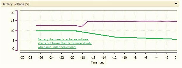

Is the pico battery test software reliable enough for testing of battery's using just an amp clamp and scope connected to battery ?could someone move this to correct section please ..posted it in wrong one :oops:

Did you see the video from Eric ( South Main Auto Repair) ? This is were he performs a battery test with the Pico. Haven't tried it myself but seems to work fine...

A good test especially if you suspect more than just a simple battery fault or are already doing a cranking compression test

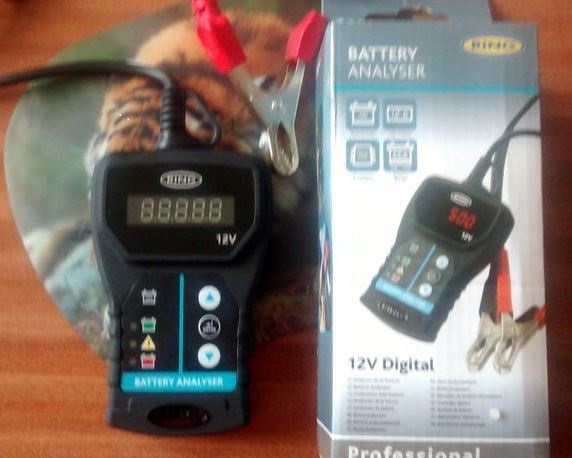

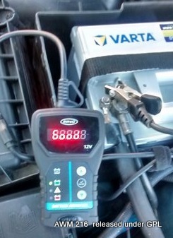

But if it is just the battery you want to test to just to use a a digital tester the works on the AC impedance of the battery the basic models don't cost much and as well as a simple pass/fail they give an estimate of the efective CCA of the battery and the perecentage of the remaining life feft in the battery.

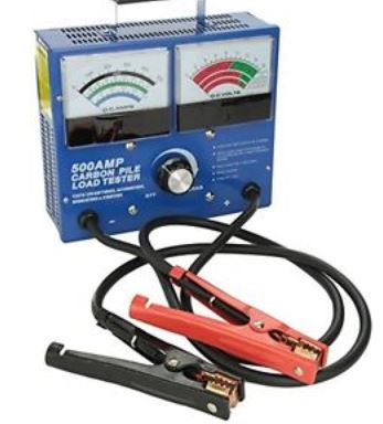

Any doubt and I usually follow up with a high current load volts drop test. To be valid this type of test has to load the battery to around 1/3 of its' CCA or 3 times the amp hour rating of the battery.

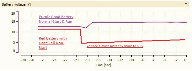

Because batteries even on small cars are getting much bigger the old hand held load testers which will generally only load the battery to 100 amps are too small to and a carbon pile tester is required to load the battery enough to reveal a dead (gassing) cell. A battery with dead cell will generally first give trouble in the first cold snap of winter, once the car has been boost started and immediately afterwards will generally start and run normally and may not give problems for weeks or months. The key off engine off voltage across a battery with a dead cell will be only slightly lower than normal but when it is placed under very heavy load the voltage will drop instantly below 9v to around 6 volts.

With a dead cell when a very heavy load is put on the battery the voltage drops almost instantly from only slightly below the normal 12.5 to 12.7 volts to 6 volts or so. As the battery heats up due to the high current the voltage may rise 2 volts or so.

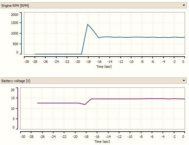

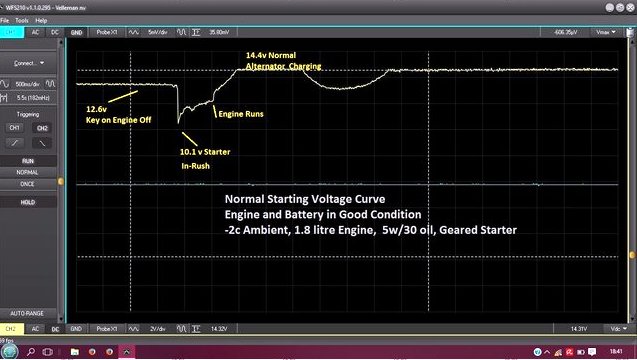

The Pico software is superb but even the cheapest scope will do the job the difference is you don't get a nice print out to hand to the customer and you have to interpret the trace yourself.
This capture of a start up with a good battery was taken with a Velleman scope reading the voltage at the cigar lighter socket.
You can also use an scantool--- same vehicle different startup captured with OBD Car Doctor Pro
