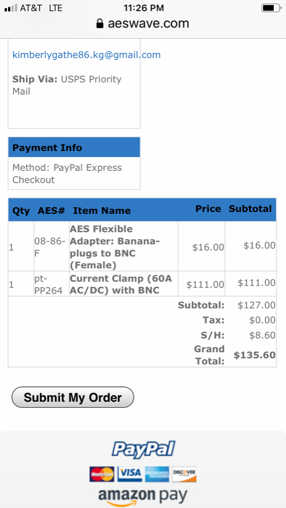

Does anybody have experience with this pico PP264- TA018??
I tryed to purchase the AES low amp clamp with banana clips on this forum in The tool section but it is out of stock
I purchased this one along with the banana to BNC adapters to fit my Modis I hope I made a good purchase this is my first amp clamp thanks

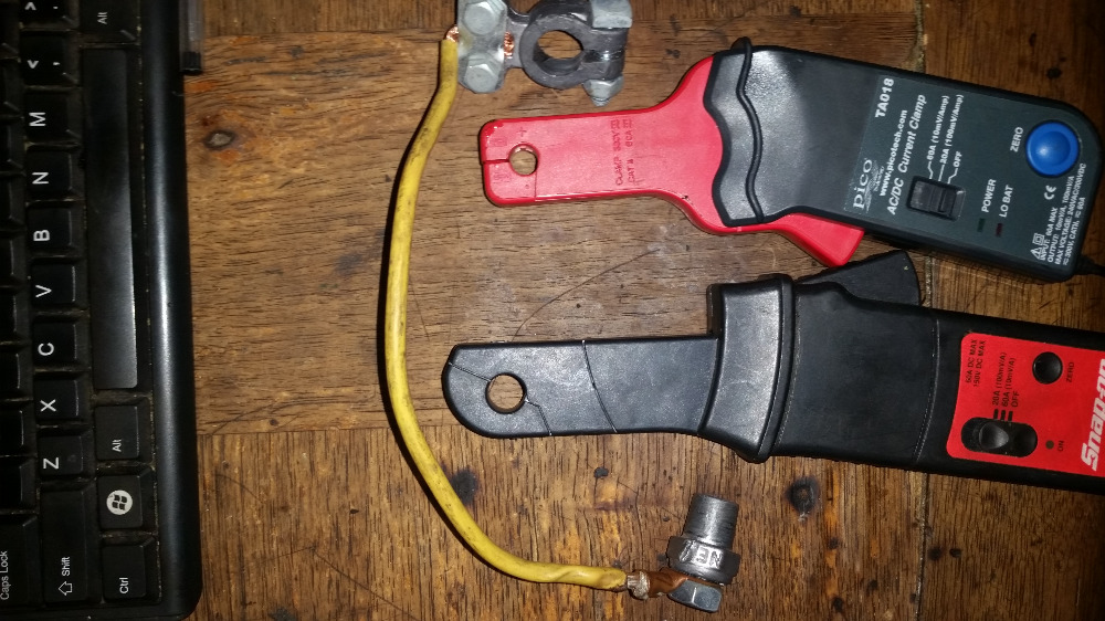

True-er words have never been spoken.
Keep a supply of 9 volt batteries, at the ready.
I have that same tool. (GypsyR has the box. :lol:) It is a good Current clamp. My only complaint about it is that the "clamp" part has a smaller diameter hole than the Snap On one does. For most things this doesn't matter, and some things, it's a plus. But doing relative compression on battery cable, might be a problem (not a big deal, But, I'll give Snap On a +1 for their larger hole.) Other than that, it should serve you well.

:ohmy: :woohoo: :whistle:
Sorry to be the barer of bad news.
It's, really, not a big deal, though. For Relative compression, a voltage waveform will work just as well. You just need to remember that it will be UPSIDE DOWN, unless you INVERT it.
But for doing CURRENT DRAW testing, I made this yellow cable to combat that problem, if I need to.

Well strait to the batt post sure ,it can be done I've done it this way thus, far but I thought an actual clamp will measure current cleaner more effectively..

That wire you made is a good idea!
