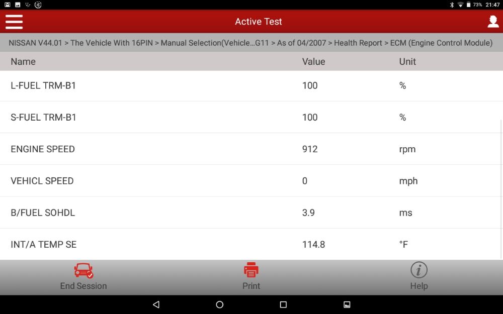

Extreme Fuel Trim Numbers on Launch X431 V+ was created by Kenyamyhome
I don't seem to understand the levels of Fuel Trim as attached below. 100% for both Short & Long Term trims. Anybody with an idea on it and i will be appreciative. Thanks

what vehicle are you using it on?
Suppose that 100% is normal and above adds fuel below subtracts.
7 years 10 months ago #26234 by Tyler
cj1 is right. You're looking at a Nissan (or Infiniti), which uses Alphas as it's fuel trim designation. 100% represents 0% correction, OR an open loop condition. Less than 100% is a negative correction, more is positive. For example, 115% on your scan data is +15% to everyone else.

Coolant temperature -- 114f --- only 46c it is likely still open loop how lomg had the engine been running ?

I believe it had not run much, but i was looking at a freeze frame. So, going by your judgement, it could be true that it might have been in open loop. What's the standard coolant temperature that triggers the closed loop?

There are a few different conditions required for the engine to run closed loop mainly the coolant temperature and the O2 sensor becoming active. If engine computer dosen't see the expected activity from the upstream O2 sensors it will revert to a fall open loop fueling map.

An oxygen sensor can get covered in dirt and give the wrong reading for a while, or fail electrically and stop switching lean-rich-lean-rich
and just stay on one of them making the ECU think there is an issue with fuel mixture.

O2 sensors need to be up to temperature to start responding, they also take longer to warm up and are slower to respond as they get older. Much the same applies to catalytic convertors.
On engines built since the mid-1990s when OBD2 was introduced there are heaters on the O2 sensor to speed the warming up process.
A P0141 code on a Nissan points to failure of the heater circuit on the rear oxygen sensor heater --- this can be either a failed O2 sensor or a short or open wiring to the sensor heater.
