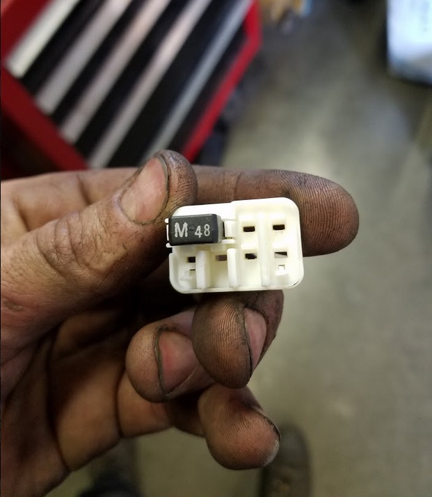

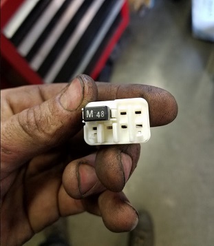

4.) Trim resistors and missing wires
Throughout this article, I’ll refer to sensor designs by the number of harness side wires, i.e. four, six, or seven wires. It’s important to note on the six and seven wire designs, you’ll actually only see five wires on the sensor side. Why? Trim resistors. See below:
The trim resistor (AKA resistor chip) is integral to the wideband sensor connector (not the sensor itself), and is installed at the factory to allow the PCM to account for manufacturing tolerances. This resistance is measured by the PCM on a dedicated circuit, and can be installed parallel to the heater power OR sensor signal. Honda even goes so far as to have two wires dedicated for the resistor circuit on their seven wire designs.
Can trim resistors cause fuel control problems? To be honest, I’m not sure, as I’ve never seen it before. Anything’s possible!

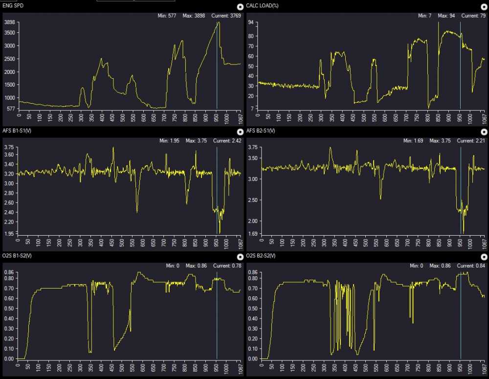

-Scan data-
www.scanshare.io/share/9ps_DognO0u_ollTdSyNEQ#0,1,24,25,26,27
Scan data will show a voltage data PID associated with the A/F sensor signal. 3.3V represents stoich, lower indicates rich, and higher indicates lean. Seeing spikes in the data is not unusual during sudden changes in engine load.
It’s important to understand that, while the scan data displays the A/F sensor signal as a voltage, this is NOT the true sensor signal. The actual signal is a changing current, while the voltage at the sensor never changes. The A/F sensor data PID is merely an interpreted value based on the current signal.
Toyota sometimes provides a sensor current PID in mA, in addition to the voltage PID, but not always.

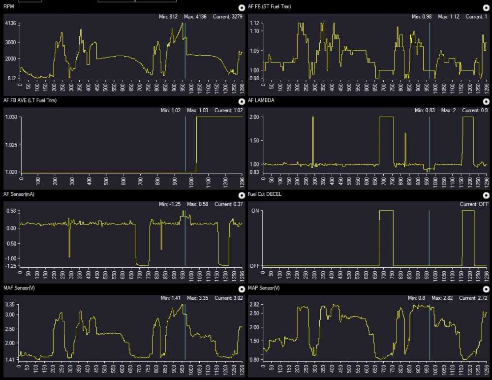

-Scan data-
www.scanshare.io/share/ZsdIdUM6zkK47APTf-fFqw#0,2,3,4,5,42,43
Honda will typically display the sensor current directly, no voltage conversion shenanigans. 0 mA represents stoich, negative current indicates lean, and positive current indicates rich. Have a close look at those current values: Around .4 mA during power enrichment, and 1.5 mA during fuel cut decel. This is why measuring the sensor signal directly is so difficult!
Note the AF FB and AF FB AVE PIDs - these are Honda-ese for short and long term fuel trims. Snap-On was kind enough to add the translation in, but I can’t say that all scanners will do this. They’re also not displayed like typical fuel trims, so remember this: Values above 1.00 represent positive trims, and values below 1.00 represent negative. For example, if your data showed AF FB at 1.13 and your AF FB AVE at .98, that would translate to a short term of 13% and a long term of -2%.

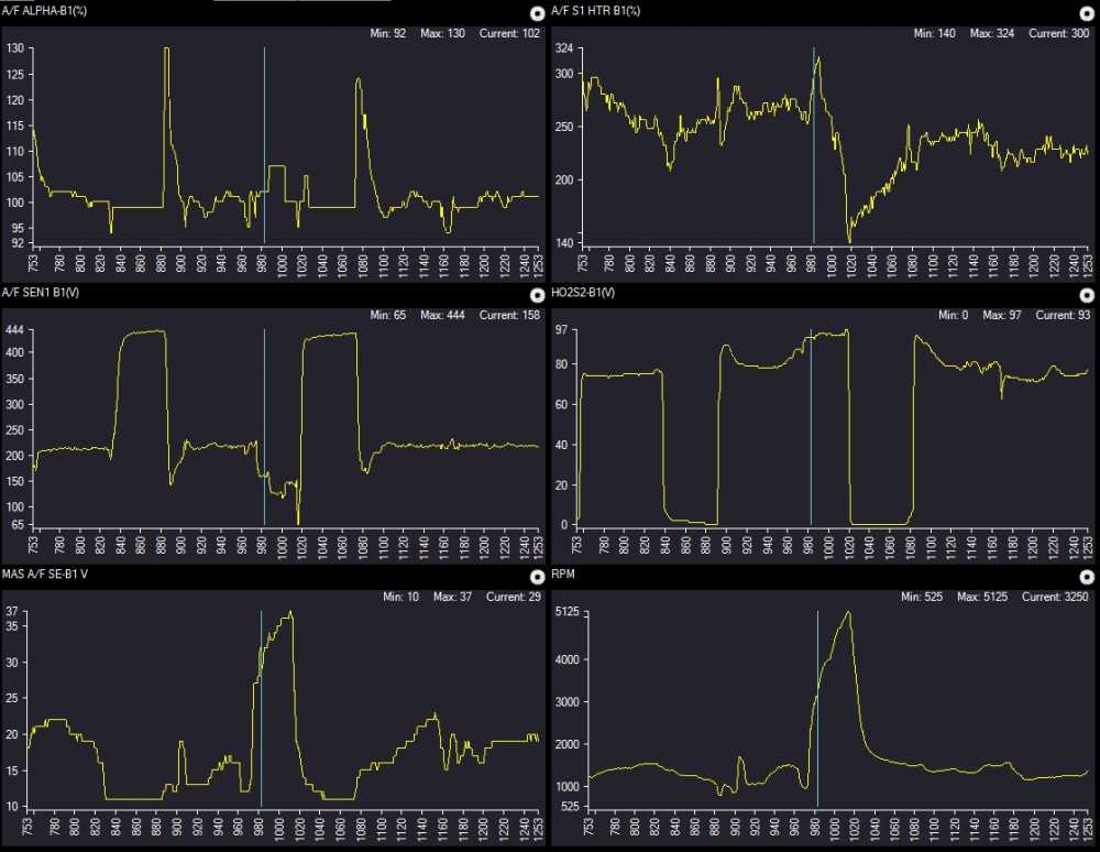

-Four wire scan data-
www.scanshare.io/share/acu6f1Lofk6YwAmKhhrDyw
The Nissan four wire sensor is another ‘current critical’ design that produces a current signal, but gets (mis)represented in scan data as a voltage. Again, this is smoke and mirrors - see Toyota wideband sensors above. 2.2V represents stoich, with over 4V seen on fuel cut decel, and 1.6V or less at WOT.

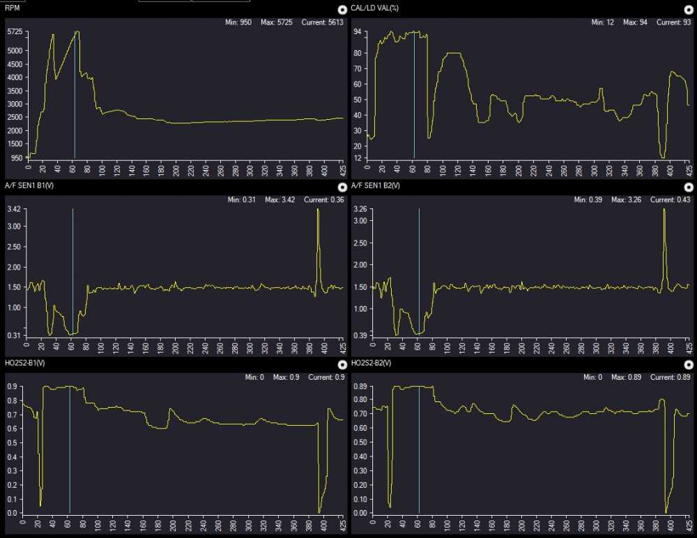

-Six wire scan data-
www.scanshare.io/share/RhcQ5whqU0mPCutDLNC56w#0,2,5,6,7,8
The six wire signal also uses a voltage signal PID, with 1.5V representing stoich this time. Another converted value… Why can’t OE’s treat us like adults? 3.00V or higher during fuel cut decel, and .7V or less during wide open power enrichment.
With both types (and conventional zirconia O2’s), Nissan has it’s own designation for short term fuel trims, ‘Alpha’, and they function just like the Honda AF FB PIDs. Values less than 1.00 are negative trims, greater than 1.00 are positive trims. I do occasionally see long term fuel trim PIDs in the scan data, but have NEVER seen them change or adapt to mixture problems. Take them with a grain of salt, IMO.
