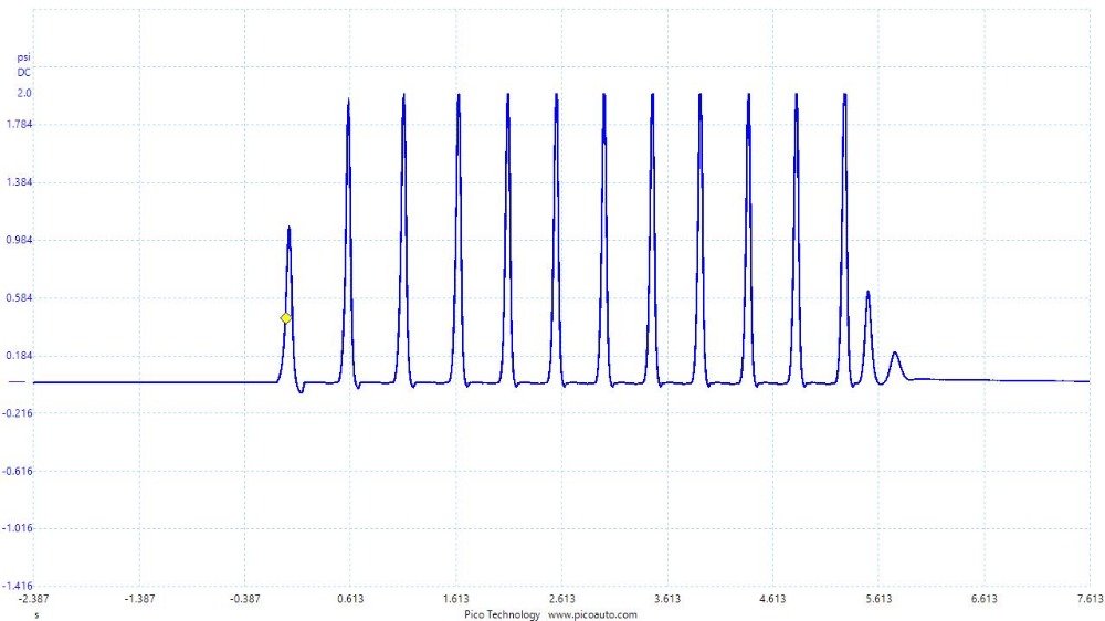

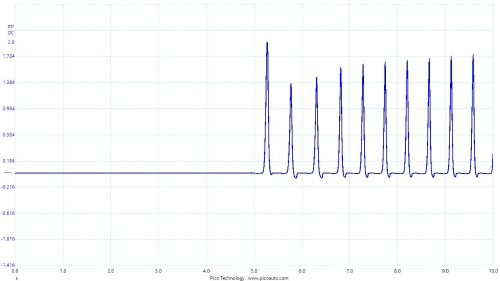

using WPS500X for an in-cylinder pressure test, can it be determined if piston rings are bad (too much oil consumption) other than a low psi reading? i have a sample waveform taken from a 2011 GMCs Terrain 2.4L whose owner complain about excessive oil consumption. engine runs well except that for every 2K km, she would always add about a liter of oil.

I think you'd need to couple your in-cylinder transducer with a pressure pulse tester in the crankcase to really see a ring sealing issue.
Or, use the pressure pulse tester with an ignition sync to pick out individual pulses.
Underlined the problem.
:lol: These engines drink oil like it's their job. Sometimes you can help the situation by pulling the intake and cleaning the PCV orifice between the #2 and #3 intake runner, but usually it's a oil control ring problem.
At least your customer is checking their oil level! Most owners I've seen just let it go 'till the chains skip. :silly:
