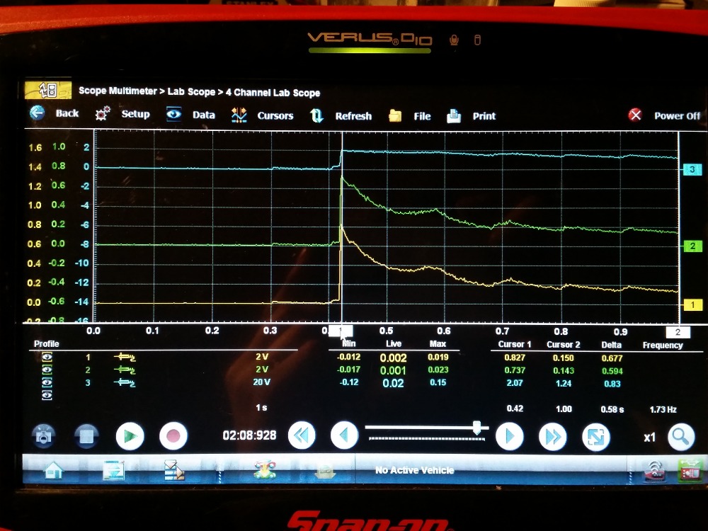

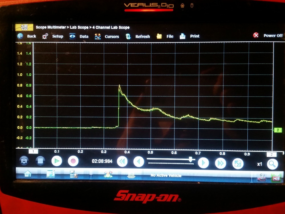

So I have an odd opportunity to test out 3 different current clamps at the same time on the same vehicle. All 3 current clamps are made by PDI Meters. I have had there 60amp clamp for awhile and its been good and decently accurate in the milliamp range when compared to my multimeter inline with the same load.

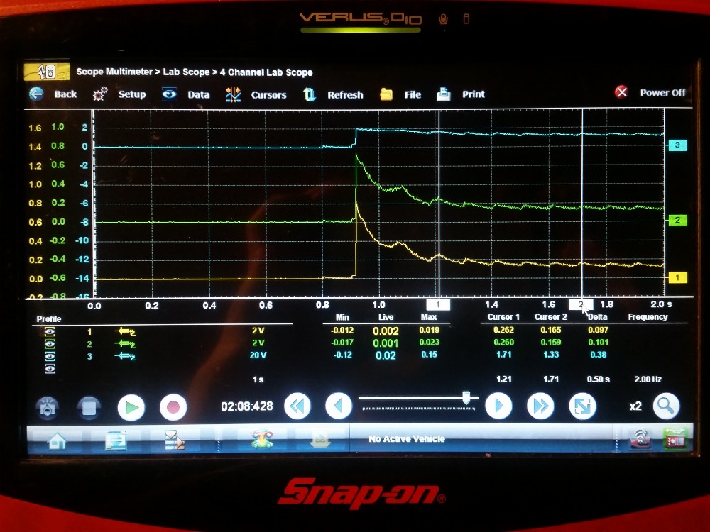

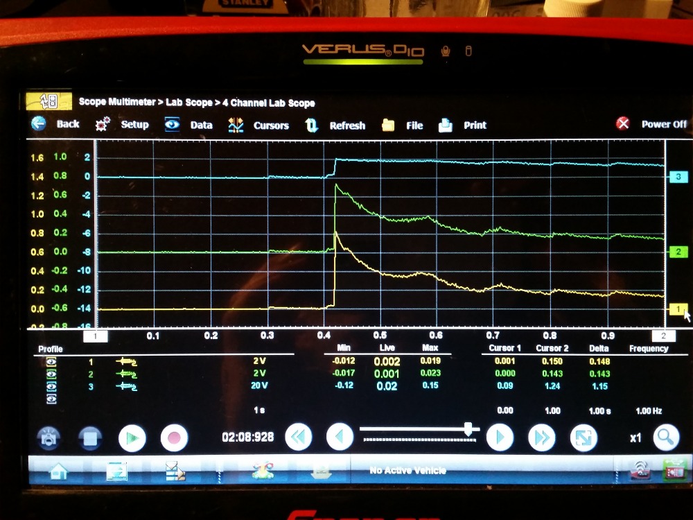

I learned a lot from this simple comparison test. I wanted to know what high amp clamp was more accurate. I learned my 60amp clamp has its own limit. I also learned that above a certain threshold, both high amp clamps become 100amp off from one another. I also learned that it might be possible my starter draws over 800amps on initial rotation on a little 2017 kia 2.0 4cyl. lol. I wasn't expecting that.
Here is what I am thinking. The "Amp Rating" of the current clamp may not exactly mean that is what it can only measure...but possibly, what the company has rated the clamp for based on its accuracy. Now scrolling through the waveform, point by point on the Verus which I don't have pictured, it seems once the amperage gets around 600amps, both clamps start reading within 20amps of each other. Around 550-450amps they are within 10-15a. Once you get around 400 and below they start reading 1-7amps of each other which is more than acceptable to me from reading EMF. The Low amp clamp (PDI 60amp) seems to be within 20amp once the amperage is around 140amp. I wouldn't use the low amp clamp for accuracy that high anyways but you can still use it as a visual for Top Dead Compression.
Which Current Clamps out there do you suggest?

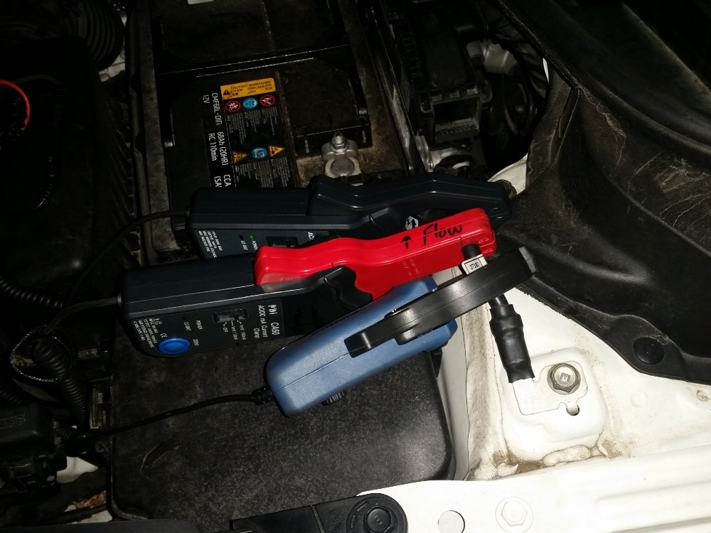

Channel 1 (Yellow) - PDI CA-400D (40 - 400 amp) (10mv/A - 1mv/A) (Set to 1mv/A)
- WARNING - AUTO SHUTOFF. Not sure the time limit yet but I noticed it did shut off on me a couple times but it seemed 10-20 minutes. This would be a problem if you are doing a parasitic drain test and you need the clamp active for a long time.
Channel 2 (Green) - PDI 600 AC/DC Current Clamp (1mv/A) (Set to 1mv/A)
- Not sure about any auto shut off feature for this yet
Channel 3 (Blue) - PDI CA60 (1mv/10ma - 1mv/100ma) (Set to 1mv/100ma or 10mv/A)
- No Auto shutoff - I've killed many 9v batteries
Starting from front to back. PDI CA-400D, PDI CA60, PDI 600A
Both High Amp Clamps over each other. This would have been better if I changed the voltage scale lower. Maybe tomorrow.
