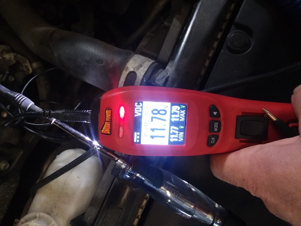

So for the test I had in mind I need my Power Probe, my modified incandescent test light and a multi meter.
First up, I demonstrate where the Power Probe has let me down in the past by connecting my test light to battery positive and measuring the voltage at the tip of the light with the Power Probe:
We all know by now that no current flow=no voltage drop, so the PP4 displays source voltage, lights the red led and makes the high pitched tone that indicates good power.
That's with nearly 10 ohms resistance in the "feed wire" in the form of a cold test light bulb.

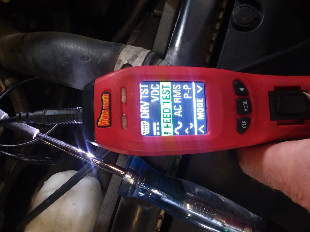

But... There are a lot of modes of operation for this tool, so let's perform the same test using "Feed Test" mode:

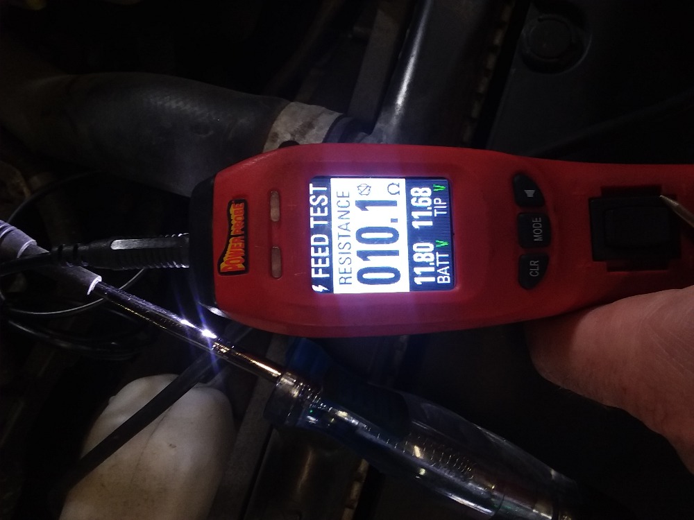

Well look at that! Now the circuit "resistance" is evident.
A quick rationality check with the meter shows that the PP4 measurement is pretty accurate:

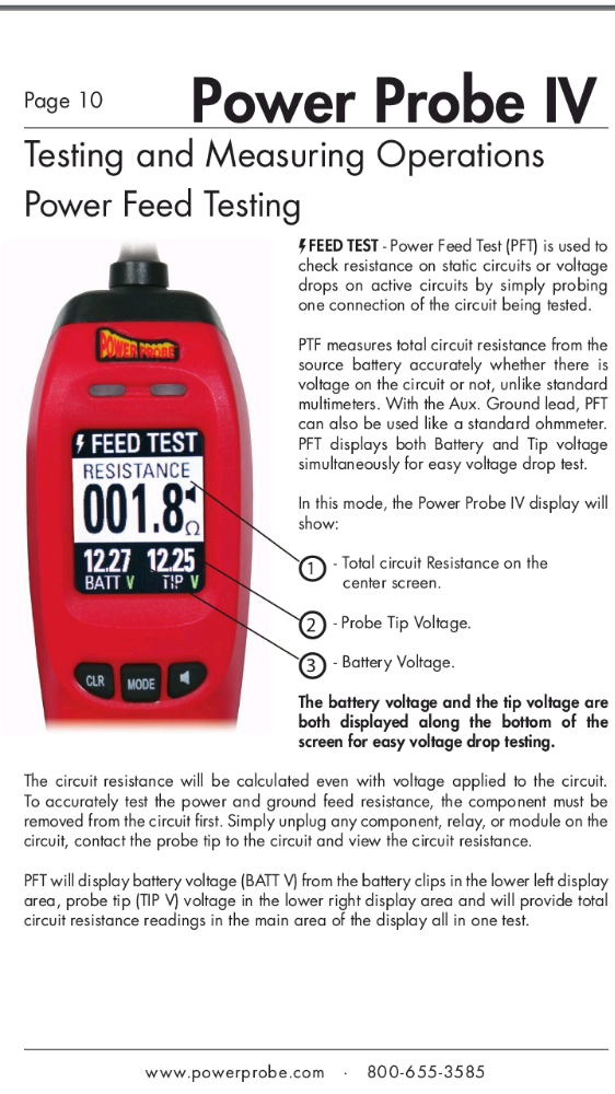

That's where I'm hoping the "Feed Test" mode will pick up the slack. It's kind of like an instant volt drop test.
The screen displays source voltage, tip voltage and circuit resistance at the same time.
So how does it calculate the "tip voltage" compared to "battery voltage"?
Does the PP4 load the circuit in feed test mode?
Or is tip voltage a calculated value based on a resistance measurement?
Or is the resistance value calculated based on current from the hypothesized load?

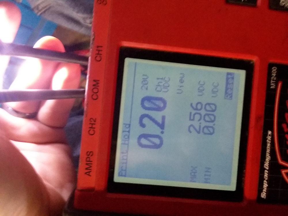

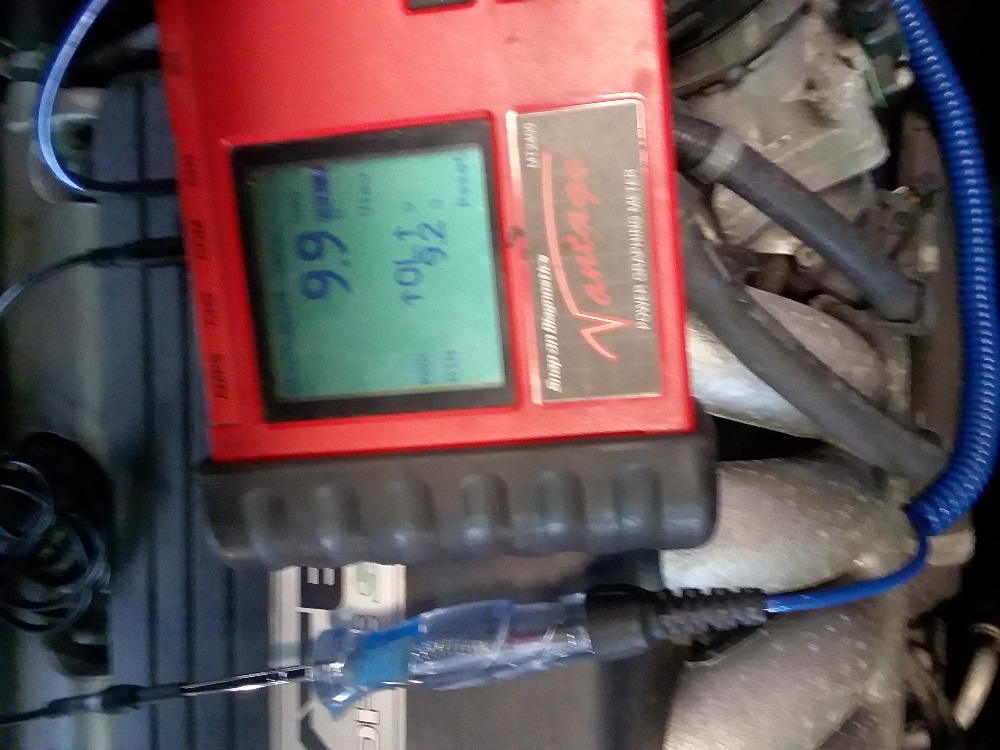

8 years 3 months ago - 8 years 3 months ago #22569 by Noah
Replied by Noah on topic Collecting Dust...

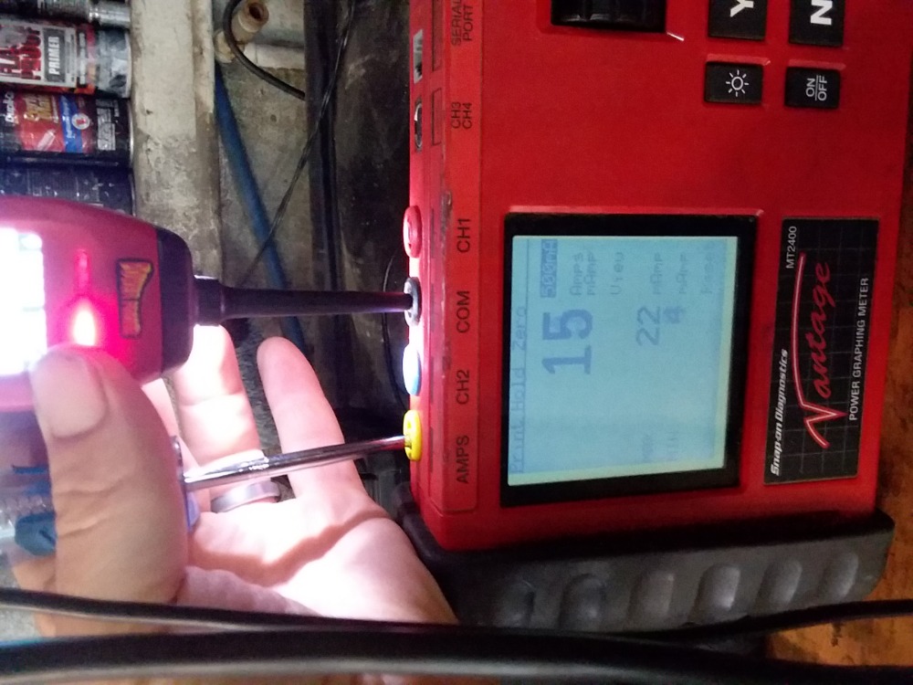

Test light connected to battery positive, PP4 in Feed Test mode run through amp meter:
You can see a live reading of 15ma with a max 22ma. Test light is not lit.
So I believe the PP4 must be loading the circuit in Feed Test mode.

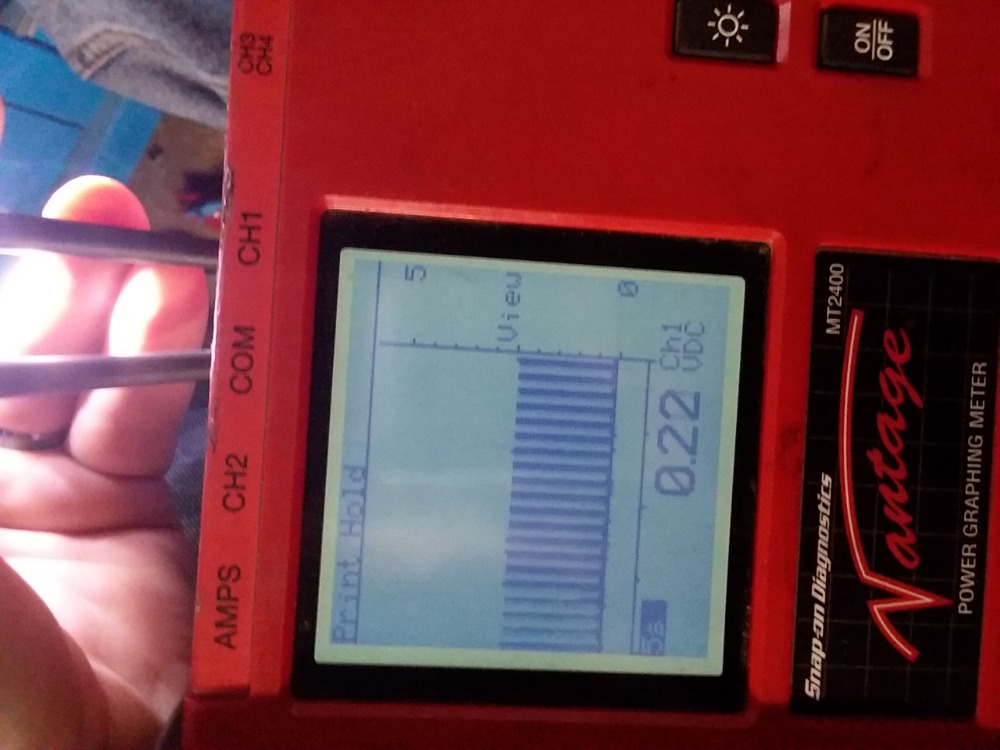

To see if it is also behaving as an ohm meter, i decided to do a voltage check between the negative lead of the PP4 and the probe tip:
Displayed on a graph and in digital format to show activity and min-max levels.

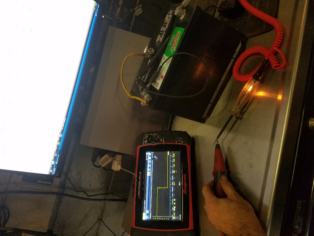

8 years 3 months ago - 8 years 3 months ago #22571 by Chad
Replied by Chad on topic Collecting Dust...
I went back and Re-read you original post. I think I understand, now. The FEED TEST shows the RESISTANCE that causes the voltage drop, rather than the voltage drop, itself?
I bushed the dust off my Load Pro and did the same test.

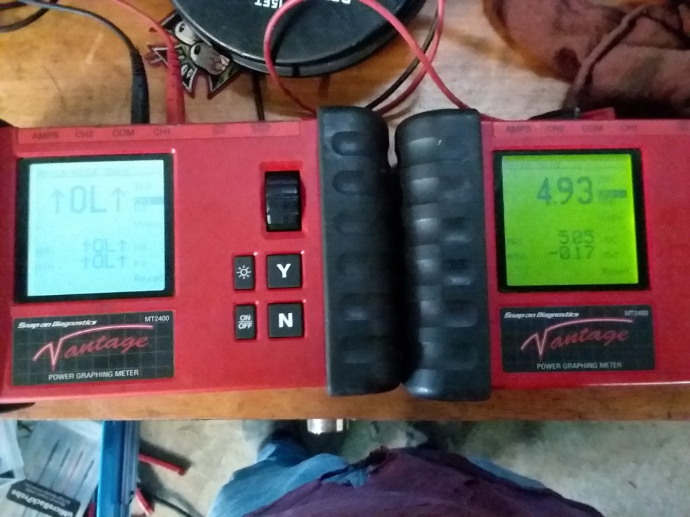

8 years 3 months ago #22575 by Noah

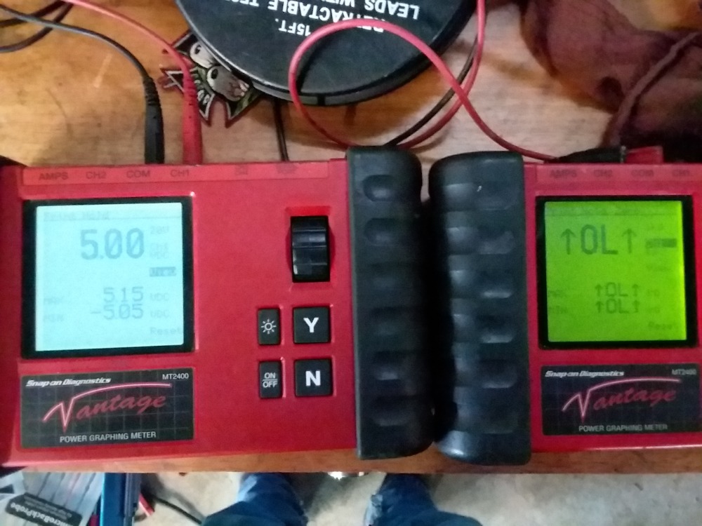

Off subject, I also figured I'd check the ohm meter output of the Vantage while I had everything out since I fixed my parts Vantage while I had some vacation time last week:

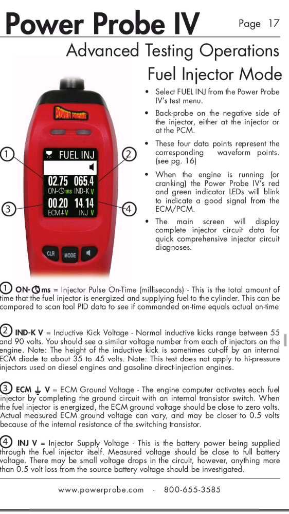

It's got a pretty cool injector driver test that shows source voltage, injector on time, ground voltage and inductive kick.
So i figured those are all the points i want to see in an ignition coil, so why not try it on a cop?
Ummm, because the screen goes black when you do that. :blush: :blink:
The abbreviation "ind kv" stands for inductive kick voltage. It is not actually capable of measuring kV...
