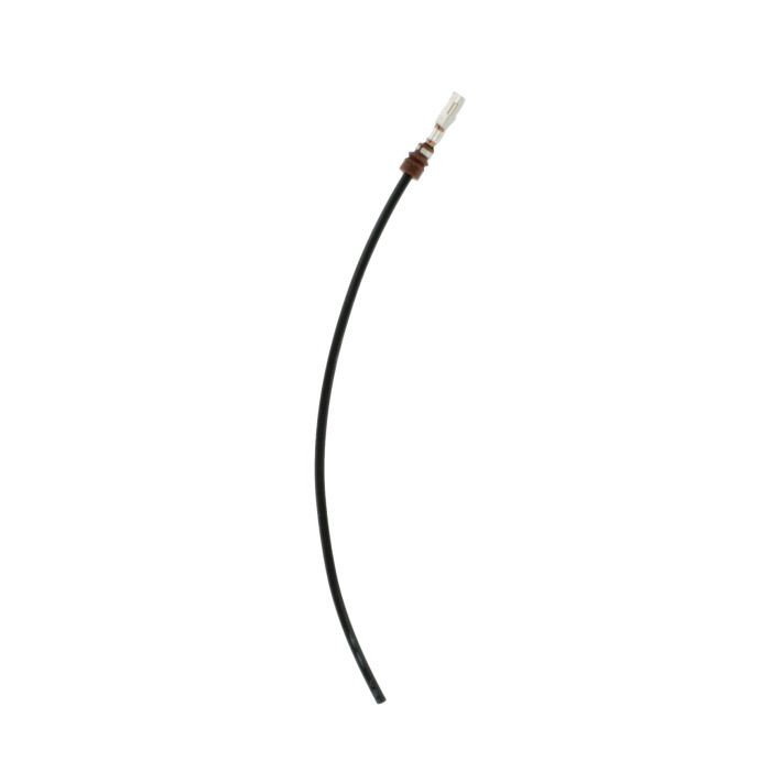

And from Toyota... they sell it as a pigtail complete with seal: www.toyotaonlineparts.com/oe-toyota/8299812440

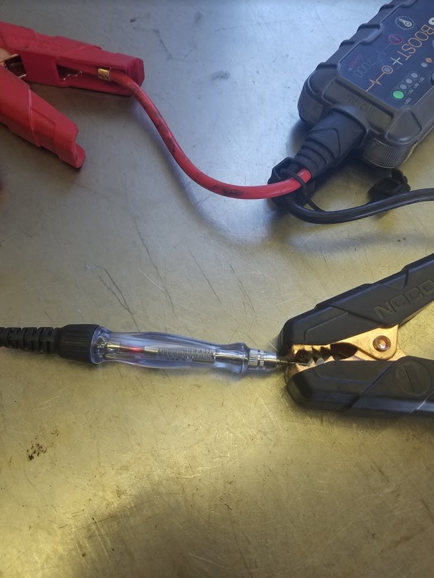

9 years 6 months ago #8912 by Tyler
Replied by Tyler on topic Test Light Bulbs
Thread bump! Just sending a thanks to Gary B on this one. ;) Noticed the bulb in my go-to light lost brightness recently, not sure why... Anyway, ended up going with the JKL GF780. I'm hoping I'll like the clear bulb output better than the red. ;)
9 years 6 months ago - 9 years 6 months ago #9090 by Tyler
Got the bulbs! Some before and after comparison. Weak and tired bulb:
Shiny new:
To be safe, I did a current measurement:
Pretty darn close to the advertised 150mA. B)

4 years 1 week ago #58813 by Paul P.
Replied by Paul P. on topic Test Light Bulbs
Mr. Tyler.
You are using my favorite test light!!!! I can only imagine why?????????:silly: :silly: :silly: :silly:
It is highly customizable, as you can see in my photo.
All my test stuff is 4mm Banana Jack now, so this makes it scope-friendly and DVOM-friendly!!!;)
