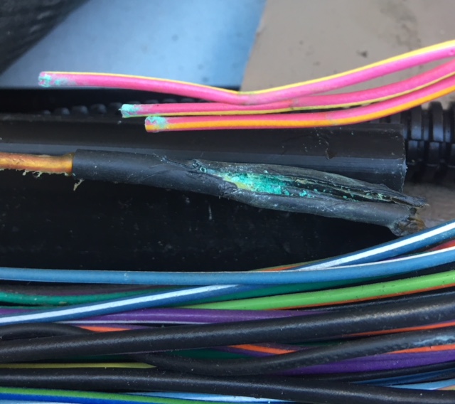

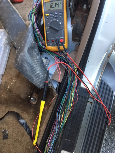

My Mountaineer master and passenger door locks didn't work in the lock position, only in the unlock. After a couple of checks it led me to a four wire splice which was under the left rear door jamb. A couple of thing had to removed to get to the harness.
I take voltage reading after the splice on the wire that goes to the left door switch. I have system voltage so you assume the problem is further up the harness right?
But look what happens when I loaded the circuit by pressing the lock button...I did the same on the wire going to passenger lock switch with same results.
To verify I used another wire probe as a jumper before the splice and after. Now the door locks. Splice has to be the culprit.
I sliced opened the heat shrink.
Imagine if I wasn't aware of the loaded circuit test. Door trims ripped out, new switches installed and for what, I would,t fix the problem.
