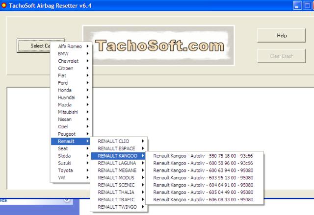

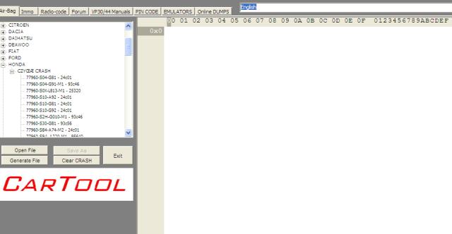

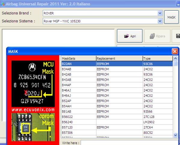

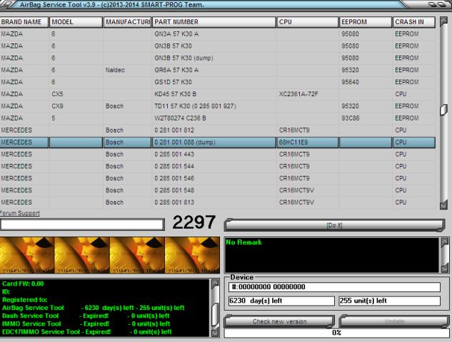

7 years 7 months ago #28430
by juergen.scholl
Replied by juergen.scholl on topic SRS Crash Data EEPROM reflashing
Well, it's not that cryptic as it might appear at first sight....
Crash data is stored in some erase/write protected areas in memory devices. Mostly crash data is cleared by software. You have to read the memory device, then filter the bin file thru a program to clear it and then write the complete file back to the device. Often it requires you to desolder and solder; onboard programming almost never works ou t(in my experience).
There are only few people who actually know exactly where ( and how) the crash data is encrypted. The softwares are commercial and are a huge bypass instead of investigating each and every single dump which is very timeconsuming.
The whole process is comparable to immo off solutions, egr delete and so on. For the ones involved into programming /reverese engineering crash data clearing is just one partof all the tinkering with electronic control devices.
Nevertheless, this kind of tinkering goes along with a HUGE responsibility: often times into the control units acceleration sensors, gravity sensors
, inclination sensors etc are built in. These devices can get compromised and/or damaged during an accident or crash event.So just clearing the crash data without verifying the functionality of the system as a whole is DANGEROUS. This is the reason why the manufacturers irrevocably call for replacement of the involved control units.
The carprog unit is a powerful tool concerning programming microcontrollers and memory devices. The cheap chinese clones are hit and miss, with good luck they work on the most prominent chips, some of them will be blocked after some time ....
I attach pictures of softwares for the interested ones.
