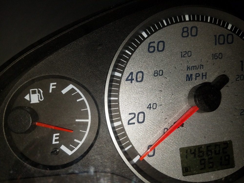

2003 Nissan Maxima. Vehicle came in with the complaint that it won't start. The problem was verified. Although, sometimes it would start but run very poorly and stall almost immediately. Gut instinct says the car isn't getting fuel.
But, the only time I listen to my gut is when we're talking about food.
As you can see the car isn't out of gas. The gauge shows about a third of a tank. Plenty of gas.
Fuel pressure isn't easy to check on this car.

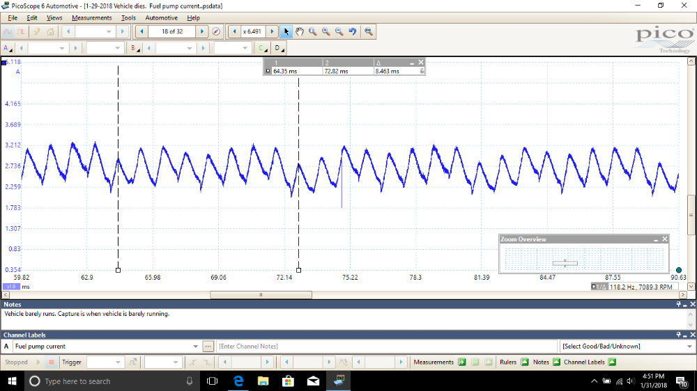

Let's see what's going on with the pump. I removed the fuel pump fuse and installed a loop to scope current. What I found was about a 2.7 amp draw and the pump running at about 7,000rpm. My limited experience has shown about a 5-7 amp draw and 5,000rpm on most of the pumps I've encountered.

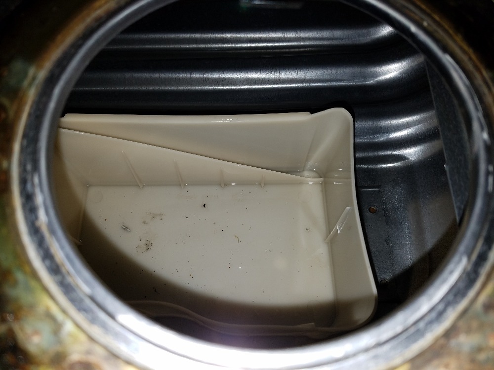

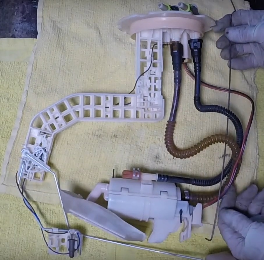

What could cause high pump speed but low current draw? I'm suspecting the gauge is wrong and the car is out of gas. I could have just put gas in it and see if it started but the pump is accessed in about five minutes so what the heck, and I just had to look. Plus, the unit needs to be replaced anyway as it ended up being a defective level sensor causing the incorrect fuel reading.
Sure enough. The gas tank is empty.

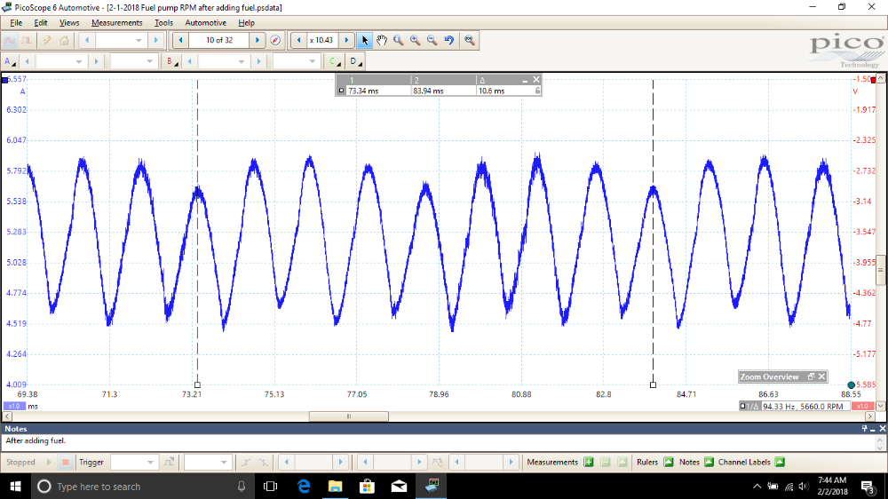

POST REPAIR: The fuel sending unit was replaced to fix the fuel gauge reading incorrectly. Once fuel was put in the vehicle I performed the same amperage test and found fuel pump current 5A and pump speed 5,600rpm.

An update photograph showing the same test with fuel in the tank.

6 years 10 months ago #36424 by XterraVJ
Replied by XterraVJ on topic Scoping fuel pump current and RPM
Hi Eric,
Thanks for sharing this waveform.
I have a Nissan Xterra(2004) and it stalls intermittently. I have about 3.5 AMPS current at 7K RPM after scoping. Is this low current as per you?

If low current were the result of a voltage drop in the wiring, the pump rpm would be low as well. In your case, the rpm is high and the current is low indicating, possible low mechanical resistance in the pump, ie it's not working very hard.
More information would be necessary before condemning your pump, or wiring, as the cause of intermittent stalling.

If fuel pressure is okay with your readings, then I wouldn't suspect anything. All of the fuel pumps I've scoped have been about 5 amps and 5krpm, more or less. No gas in tank has been about half the amperage and about 7k rpm or so.
