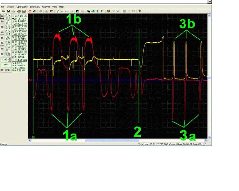

- Ch.1 (blue) : 0,1 V/div – raised ground of both BBS cells ( not necessary to connect)
- Ch.3 (red) : 0,1V/div -- signal from pump cell
- Ch.4 (yellow) : 0,1V/div – signal from measuring cell
- GND: raised ground of both BBS cells (connected with ch.1 ), from reason of measuring voltage in it’s disconnected state (for disconnected BBS have negative terminal of car battery no bond- feedback, relation)
Description of oscillogram (picture from oscilloscope)
Connected connector
1a- 3x acceleration.
In phase of mixture enrichment (oxygen-free state in exhaust) is voltage from pump cell (red) -0,7 V and in the opposite the voltage of measuring cell (yellow) slightly raised.
1b- 3x deceleration.
In phase of disconnected injection (oxygen state in exhaust) is voltage of pump cell (red) at it’s maximum (-0,8 V) and in the opposite voltage of measuring cell (yellow) slightly lowed.
WARNING! Reached voltages of both cells are result of work of both cells + control unit and might according the stage of enrichment, process of acceleration and other factors change- do not evaluate these values. Because of this must follow the test with disconnected connector. Only this way we found out the working of BBS itself.
2- moment of disconnection of BBS

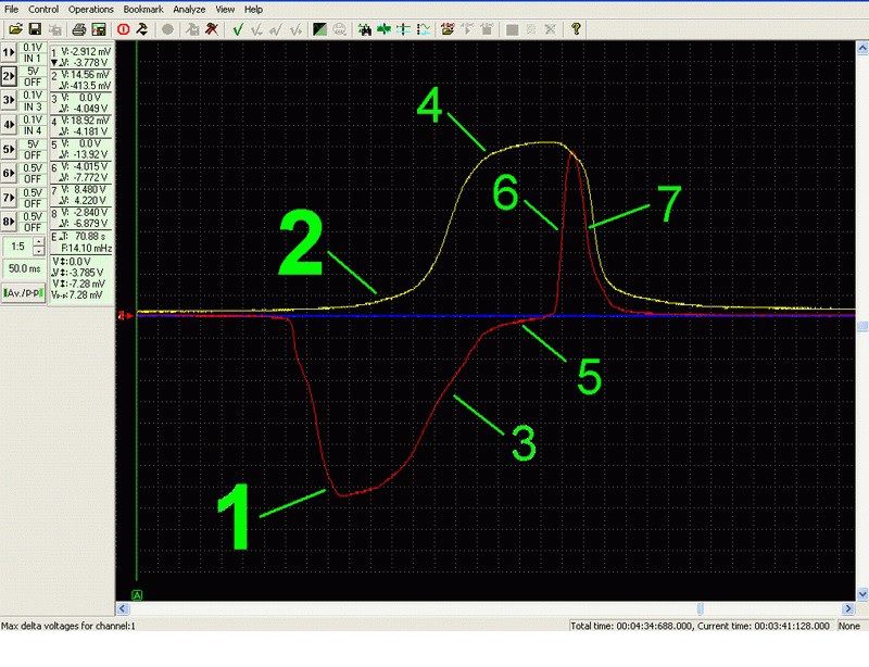

Detail of behavior of voltage on both cells in disconnected state
1 – acceleration
Only voltage of pump cell reaches max. negative value 0,8V (chemical boundaries of Zirconia cell), because measuring cell didn’t noticed the change of oxygen (measuring cell is separated by difuse slit- gap)
2
Only after return of voltage of pump cell to zero voltage is starting to appear on measuring cell voltage (through difuse slit- gap is starting to show oxygen change)
3
Voltage on pump cell is starting to gradually decrease (penetration of oxygen change through difuse slit- gap is causing balancing of oxygen environment on both electrodes of pump cell)
4
If acceleration causes sufficiently fast mixture enrichment, voltage on measuring cell must reach maximum of 0,8V.
5
If the enrichment phase is long enough, voltage on pump cell is staying on 0 value (without oxygen changes)
6 – deceleration
Only voltage of pump cell notices significant change on oxygen state (shut down of fuel injection). Difuse slit- gap is preventing of the quick change on measuring cell.
7
Oxygen state came through difuse slit- gap to measuring cell, in pump cell the oxygen states on both it’s electrodes are being balanced

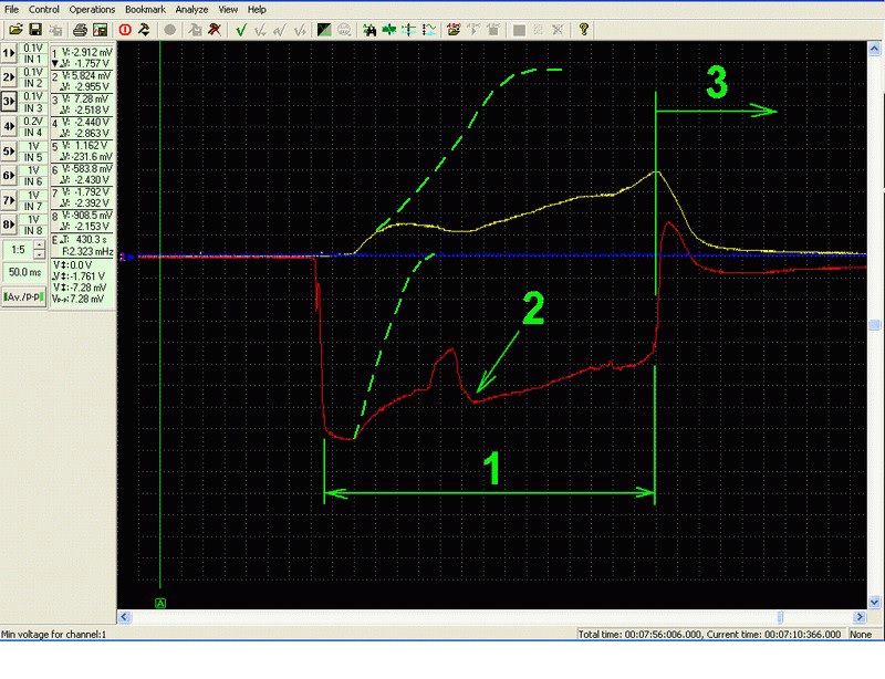

Test of the broadband lambda (O2) sensor, faults
Commonly it is anticipated that broadband lambda (O2) sensor is perfectly guarded by it’s own diagnostics. However its own diagnostics is not capable of detecting all the faults of broadband lambda sensor. Sometimes are stored in memory error messages such as mixture adaptation out of tolerance, sometimes there is no error in memory, but there are present symptoms of not properly working system, such as for example negative affected ride comfort, raised fuel consumption, not passed emission test, problems with engine idle or in partial or full engine load, reduced power and so on.
Our innovative diagnostic method discovers every problem occurring in regulation of broadband lambda (O2) sensor nearly with confidence.
Faults detected by test of broadband lambda (O2) sensor in disconnected state.
Yellow- signal in measuring cell
Red- signal of pump cell

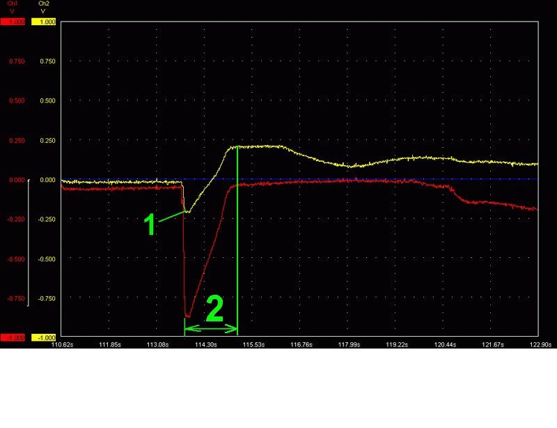

1. Fault (defect)- detail of voltage progress of both cells in disconnected state (50ms/div)
Engine- VW 1,8T AUQ (engine code)
Error messages- none
Symptoms of fault (defect)- reduced power
1- Acceleration
Dashed lines show correct of voltage progress on both cells.
2- Stoppage of current move of oxygen change from pump cell (its voltage has dropped) to measuring cell, which nearly didn’t even recognized the change.
Therefore the diffusive slit- gap is impassable.
3- Deceleration
Evaluation- signal of BBS is different from representative (characteristic) pattern- faulty BBS.

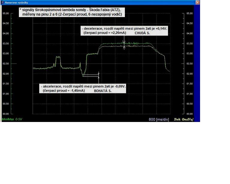

Connection of oscilloscope HD 34 (DIANA)
- connect the power cables of oscilloscope to the car battery
- connect CH1 (first channel of oscilloscope) to PIN 2 (so called 6-wire, goes to connector on side of wiring harness, pin 2 goes to resistor inside the connector).
- Connect CH2 (second channel of oscilloscope) to PIN 6 (red wire of lambda (O2) sensor so called pumping).
Signály širokopásmové lambda sondy – Škoda Fabia (ATZ), měřeny na pinu 2 a 6 (2- čerpací proud, 6- nezapojený vodič)- signals of broadband lambda (O2) sensor – Škoda Fabia (ATZ), measured at pin 2 and 6 (2- pump current, 6- unconnected wire in wiring harness)
Decelerace, rozdíl napětí mezi pinem 2 a 6 je + 0,14V. (čerpací proud = + 2,26mA) CHUDÁ S. – deceleration, difference of voltages between pin 2 and 6 is 0.14V. (pump current = + 2,26mA) LEAN mixture.
Akcelerace, rozdíl napětí mezi pinem 2 a 6 je -0,09V. (čerpací proud = - 1,45mA) BOHATÁ S. – acceleration, difference in voltages between pin 2 and 6 is – 0,09V (pump current = -1,45mA) RICH mixture
- Measuring is done during rapid acceleration – full open throttle with subsequent release of gas pedal – deceleration

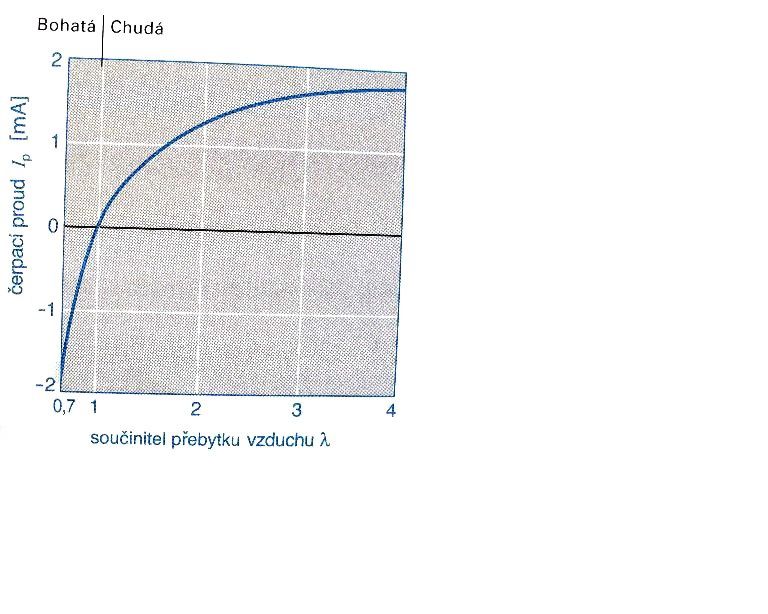

Calculation of pump current
From measured graph we subtract differences between CH1 and CH2 -> X. Substituting to formula Ip=X/R (Resistor is given by ECU/PCM 61.9 ohms) we calculate the pump current.
We have 3 states where the measuring is done: idle, rapid acceleration and subsequent deceleration.
1) Idle- voltage on pin 2 and 6 is the same - > curves are on top of each other.
Ip = 0 mA difference in voltages X -> X = 0
Pump current Ip -> Ip = 0
2) Acceleration – voltage on pin 2 is lower as on pin 6
Ip = -0.8 to -1.6 mA difference in voltages X has negative value -> X = -50 to -150mV
Pump current Ip has negative value as well -> Ip = - 0.8 to -1.6mA
Rich mixture- negative values
3) Deceleration- voltage on pin 2 is higher than on pin 6
Ip = 2.4 to 4 mA difference of voltage X has positive value -> X= 150 to 250 mV
Pump current Ip has positive value too -> Ip = 2.4 to 4 mV
Lean mixture – positive values

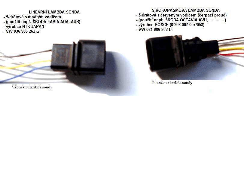

Lineární lambda sonda- Linear Lambda sensor
- 5 wire with blue wire
- Used on for example Škoda Fabia AUA, AUB
- Manufacturer NTK Japan
- VW 036 906 260 G
Širokopásmová lambda sonda- Broadband Lambda sensor
- 5 wire with red wire (Pump current)
- used on for example Škoda Octavia AVU, ...
- manufacturer Bosch (0 258 007 057/058)
- VW 021 906 262 B
