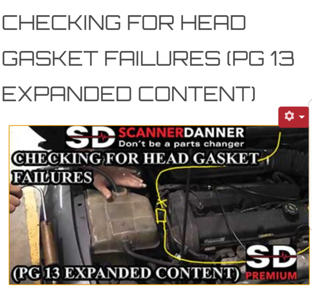

At the 2:50 point he speaks of one. Maybe it's one of the type you display, maybe not as he didn't display it? Here's a pic of the video title, part of the premium channel I believe. Using premium but still trying to figure out which videos are premium or not. It is added content so I'm assuming it's premium channel.
