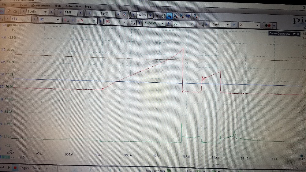

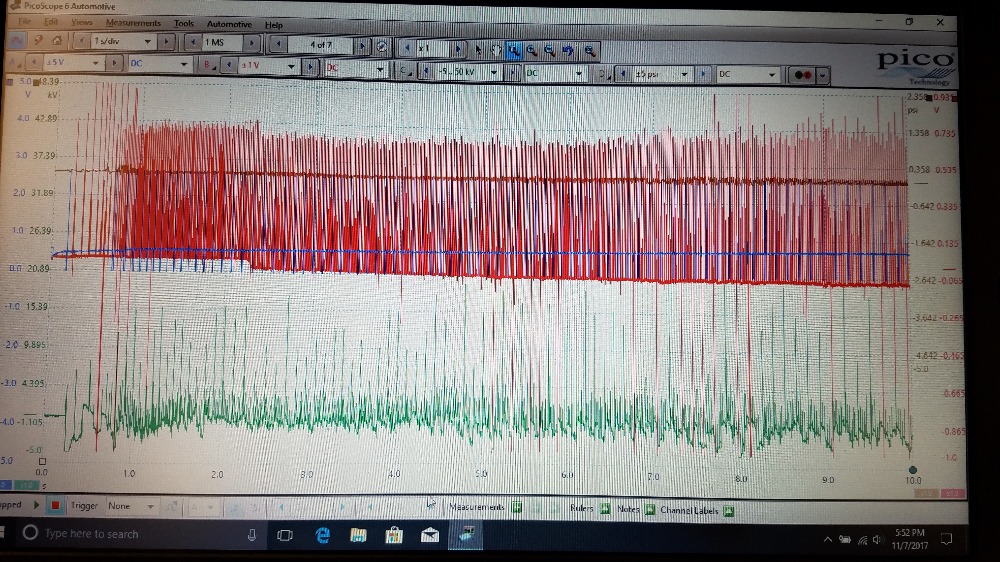

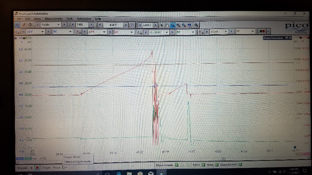

Had a 2006 ( I think... ) Ford Taurus come in the other day with a misfire. It was random but happened often enough it could easily be observed. Misfire happened at idle and while driving. P0302 stored.
Clear-flood cranking was consistently even so I didn't perform a relative compression test.
Using a Pico I graphed exhaust pressure at tail pipe ( for synching the misfire to the waveform ), fuel injector voltage cylinder 2, primary coil current parade, secondary ignition cylinder 2.
Red is primary, blue is injector, green is secondary, yellow is exhaust pressure.
This is zoomed in. Oscillations during primary turn-off led me to perform an ignition tune up due to a suspected failure of plug wires.
Performed tune up and all is good.
