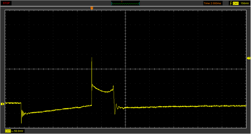

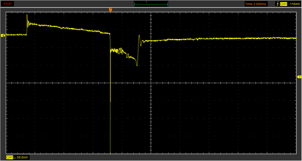

7 years 11 months ago - 7 years 11 months ago #13914 by SailorBob
Replied by SailorBob on topic Secondary ignition waveform
I'm having fun with my Hantek 1008C and tried it out on my ignition system today using the HT25 inductive clamp probe. My 98 Mazda 626 GF 2L uses a coil pack waste spark system with each coil firing two plugs simultaneously. I'm pretty new to scopes. Like really new.
I took a short one minute video and captured a few individual wave forms. Going over that video in slow motion I saw quite a variety of waveform shapes, however the fire lines were all about 2 milliseconds which is supposedly pretty good and close to the maximum possible. I don't think the scope was displaying every single spark event because I had the trigger set fairly high, however these two basic waveforms were the most common:
This seems pretty normal, but I was wondering why that second spike was so high? Just allot of energy to wring out?
This is the other common one, and I'm assuming this is the waste spark?

7 years 11 months ago #13915 by Andy.MacFadyen
Replied by Andy.MacFadyen on topic Secondary ignition waveform
A waste spark system is exactly that on any single cylinder every 2nd spark is wasted there isn't any point looking at wasted sparks. On a the the wasted sparks peak voltage is lower peak voltage and the spark line voltage is lower. As a result at the end of the spark energy is left over this causes the rising voltage forming the toe at the end of the spark.
When looking at ignition secondary traces on wasted spark systems the trigger level should be set high enough to trigger only ignition firing sparks not wasted sparks.
If you find a significant "toe" voltage at the end of an actually firing spark then it could point to a plug lead or plug shorted to ground or a spark plug gap set too narrow.
With a wasted spark system the companion cylinder can also affect the spark line on the cylinder you are looking at.
