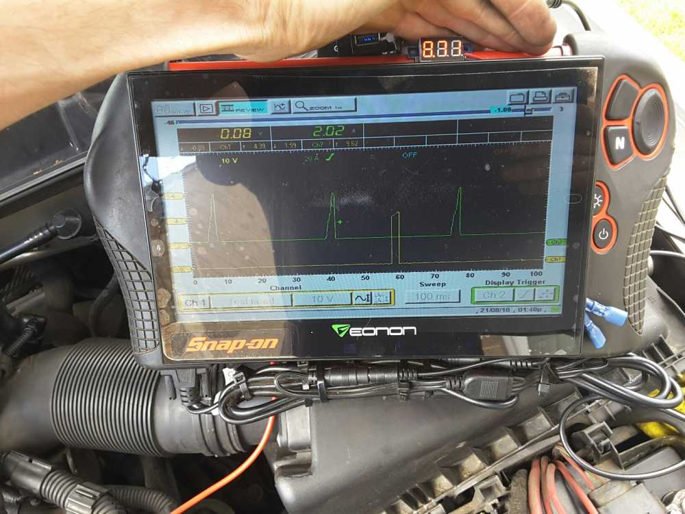

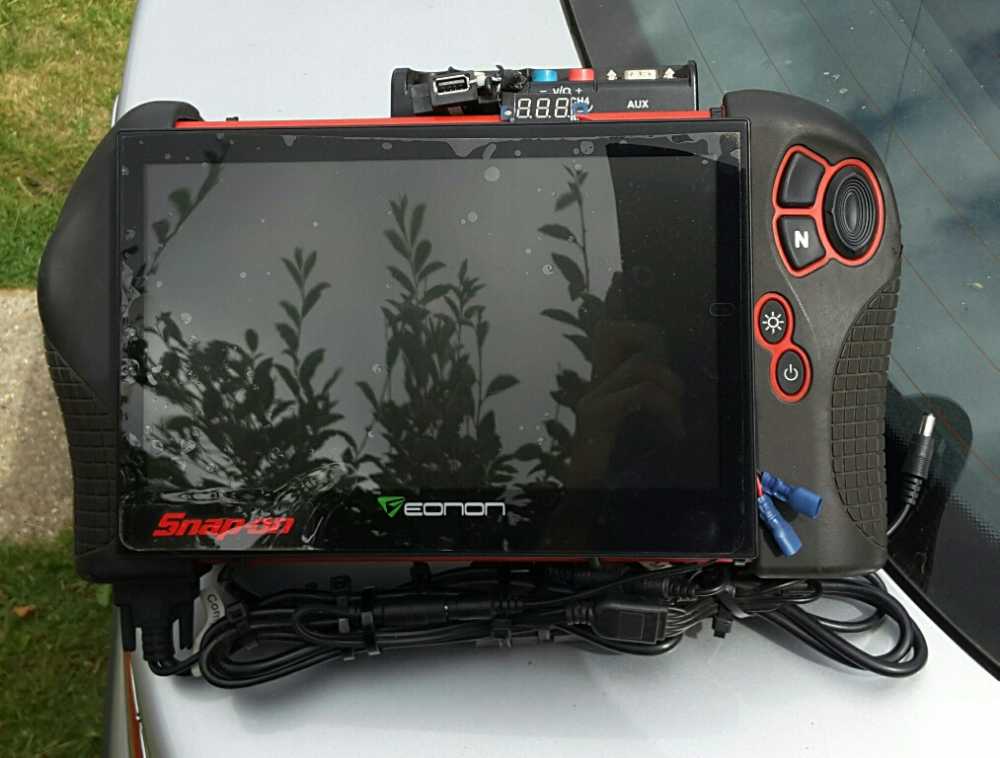

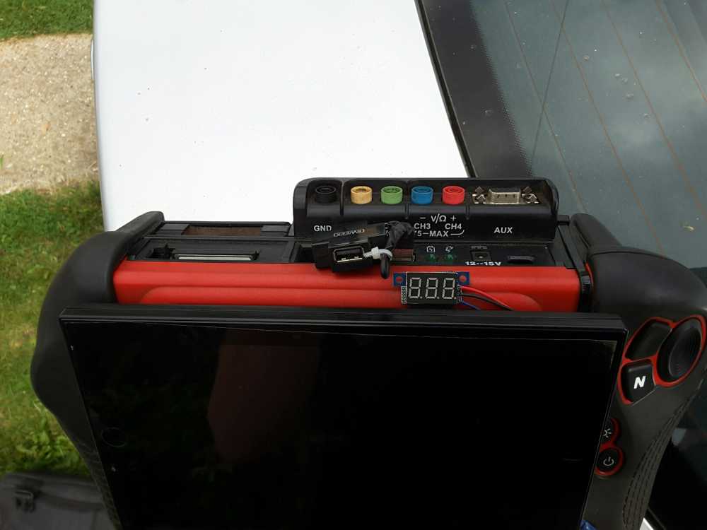

I thought I'd take a moment to show you all the mods that have been done to my modis.
The most obvious is hooking up and attaching a larger screen for ease of viewing. Not quite a verus interface but certainly helps. You may notice it also has an in-line volt meter to keep an eye on the voltage going through the tool. The USB port has a splitter attached, I find this most useful as I can hook up a keyboard and mouse, this means I can actually run the modis program several times at once on the same tool. This means I can have scan data up and running at the same time as the scope/multimeter etc.
I was debating changing the hard drive for an SSD for quicker tool performance and boot up time however as the tool can run the main modis program 3 times before it starts to struggle I don't think it'll be a big advantage.
I did not do these mods myself it was actually a relative of mine, Scott Duncan of Scott Mechanics. He also has a YouTube channel where you can see this frankenstien modis in action along with other diagnostic techniques that he demonstrates with the verus pro.
Thanks uncle Scott!
Thanks uncle Scott!

That's great! When I was running a modis I used to open the program twice to run the scope and scanner at the same time, but it slowed her down considerably
