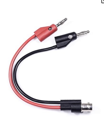

You will have no problem using "off brand" accessories. The only only issue you may have is that many accessories have a BNC connection. Snapon uses Banana Plug connectors. This is not an issue if you have an adapter.
