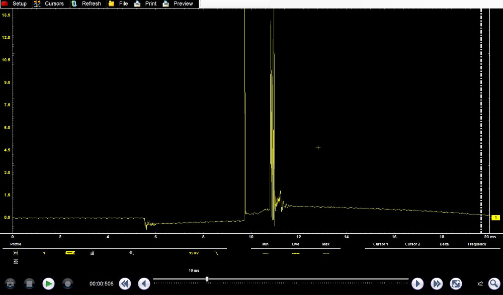

Anyone have experience with the pico ignition prope? I bought one a few months ago and have never been able to pick up a signal.
Ive tried multiple vehicles both COP and wires.
I have it connected to a verus set to ignition probe at 15kv.

Just to be clear, you're talking about the
Pico TA204
I've had very good luck with it on wires and certain two wire coils, pretty good upgrade over the Paddle Probe . There are several designs of three and four wire coils that NO secondary probe will work on without some kind of extension .
Don't be afraid to turn your voltage scale down to pick up the signal as needed.

yes, thats the one. I got it to work once on an old distributor ignition but nothing else has worked. tried it on a gm 5.3 the other day directly on the plug wire couldnt get anything regardless of time or voltage settings.
my wire clamp will give me a good picture though..

i had a Hantek (!) plug lead capacitive probe that suddenly stopped working the protective circuit inside it got zapped by leaky secondary wire. Unless it is a triggering issue that might be your problem.
