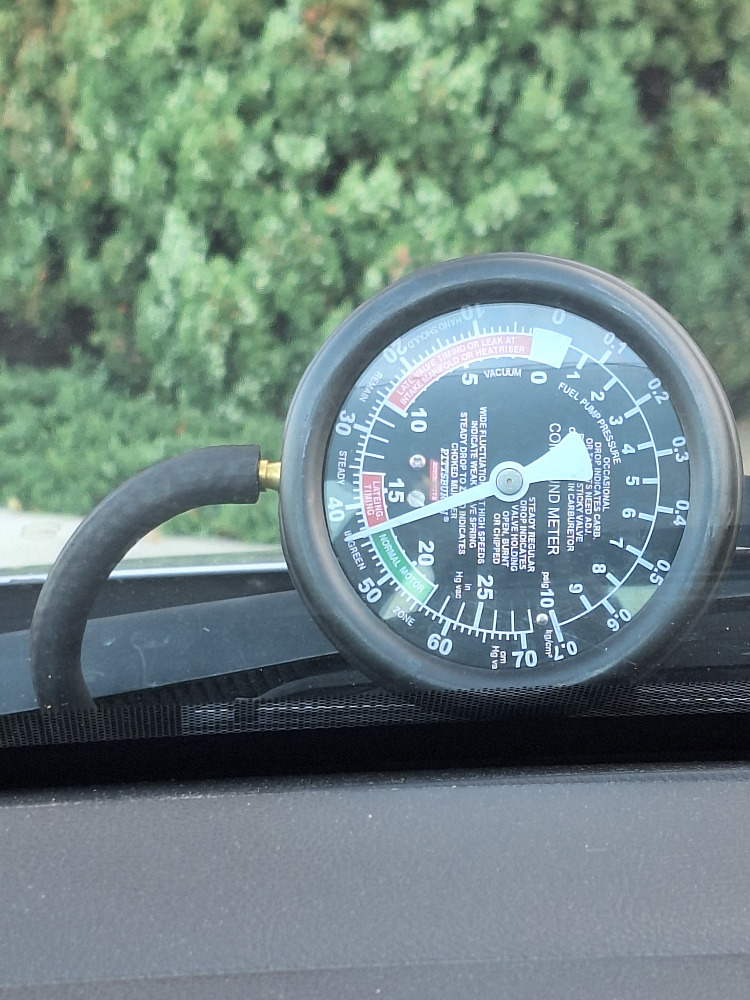

Finally got the car out and drove it. Have no vacuum leaks, (tested with brake clean then with propane) Drove it with the vacuum gauge temporarily installed and it had excellent vacuum, it was not low or fluctuating, indicative of a vacuum leak or mis adjusted valve, and lastly the power brakes work really good, so I have a high confidence I can eliminate vacuum leaks or an improperly adjusted valve.
So I put my scanner on and drove it, had it with me all day but I had difficulties in recording more than two PID's at a time with out the scan tool complaining so I just put it in View Live Data and checked two PID's at a time. Was in close loop unless otherwise specified.

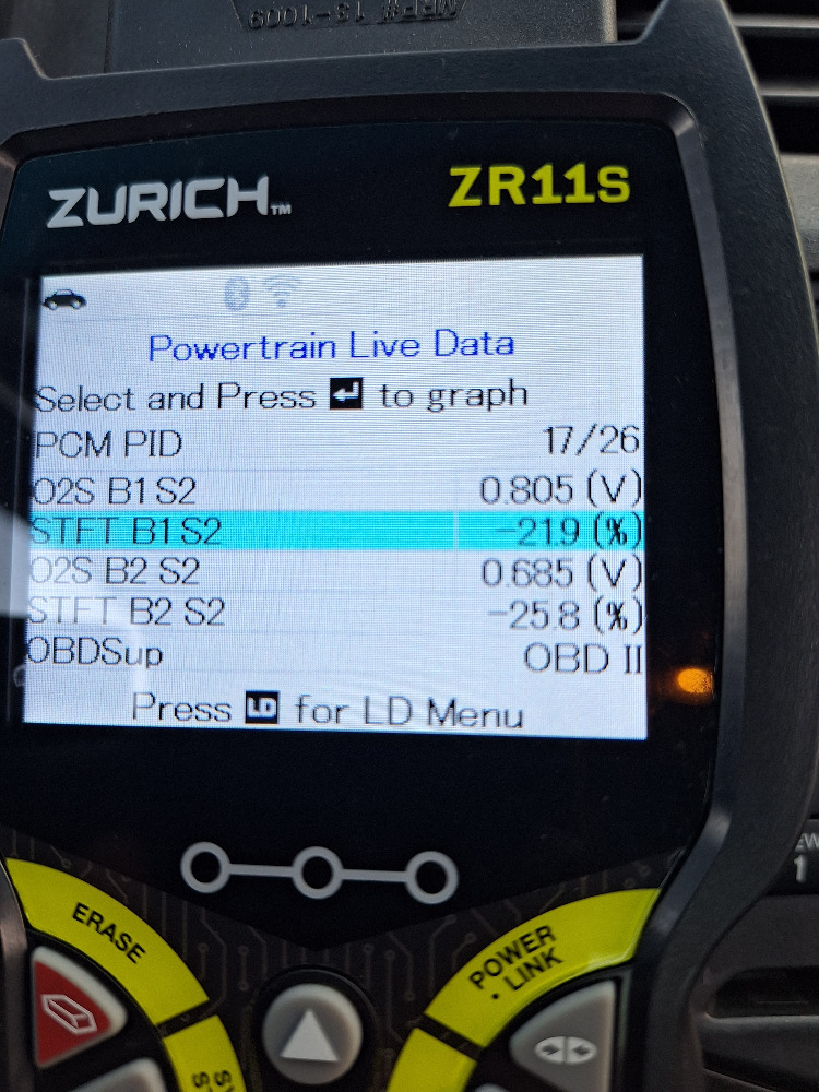

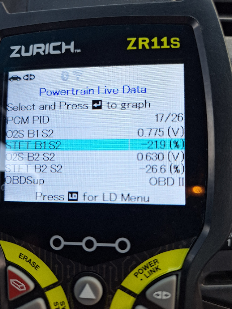

2 years 4 months ago #66169 by Tatertot
Replied by Tatertot on topic Diagnosing Calc % Load issue

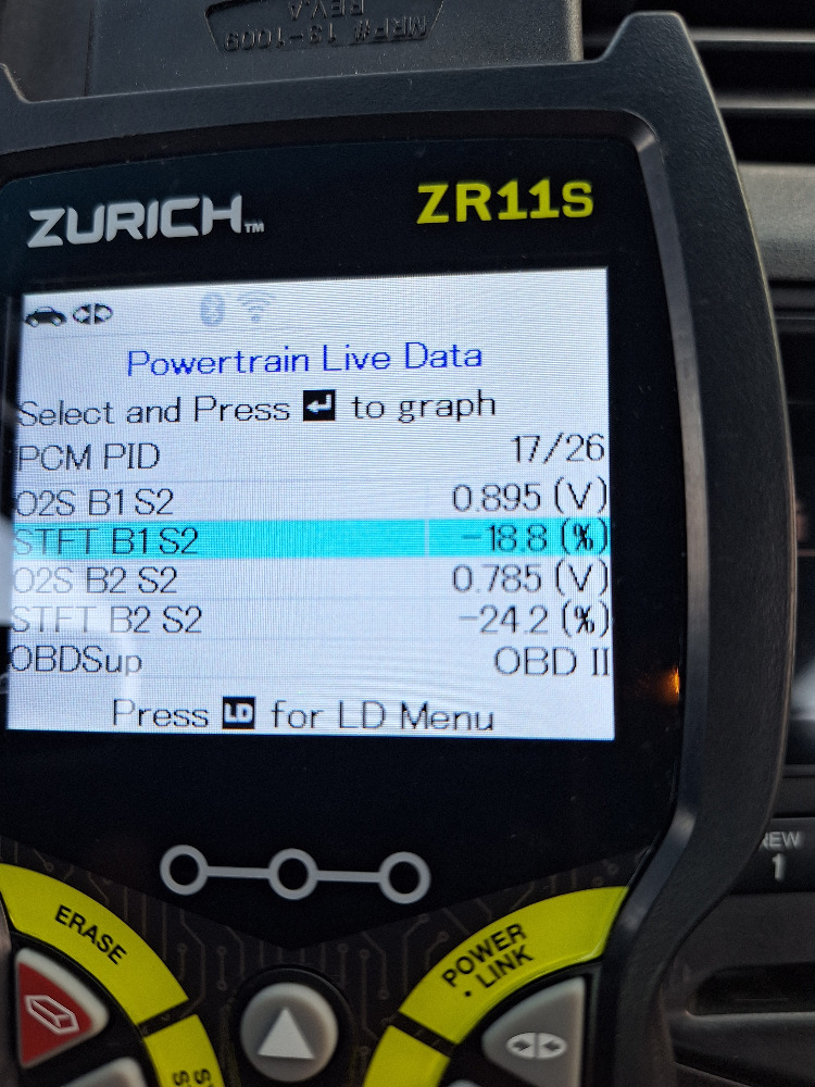

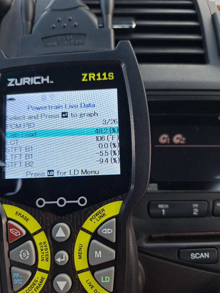

Ok, for now I am sharing pics I took of my scanner hooked up monitoring live data.
First is oxygen sensor PID's.

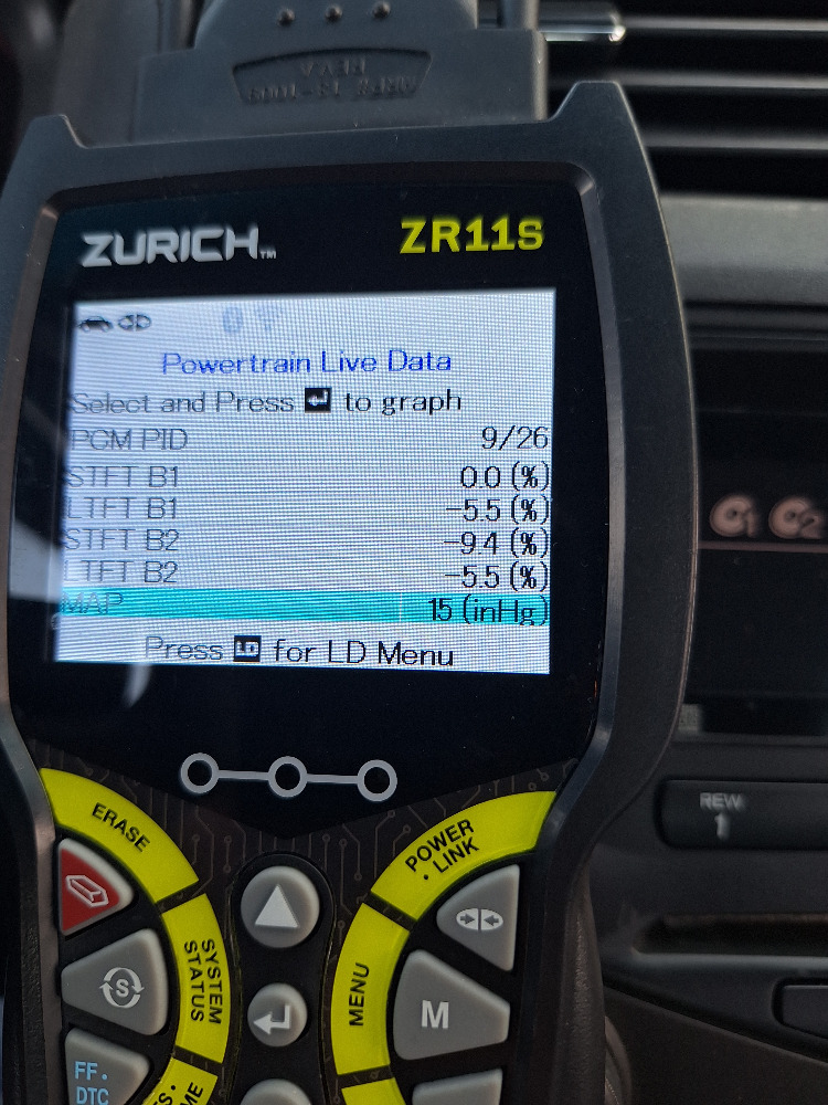

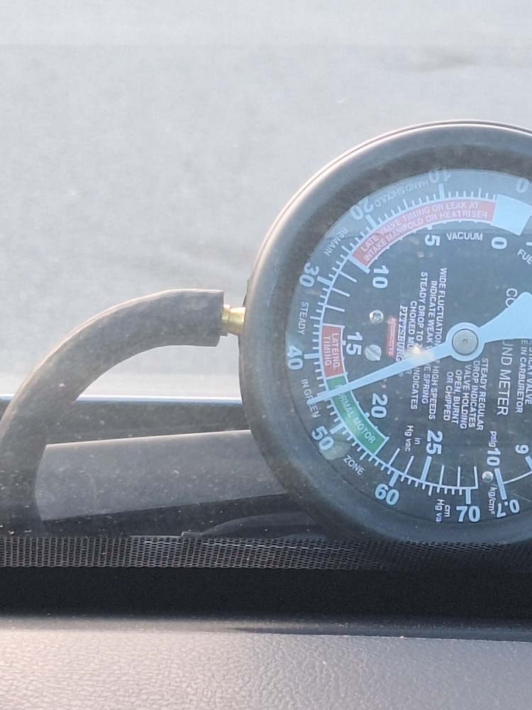

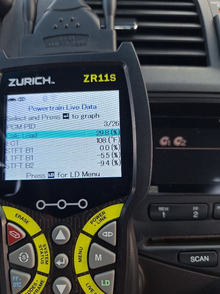

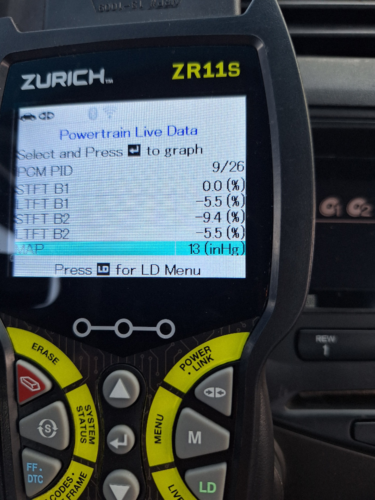

  • Tatertot
  • Tatertot's Avatar Topic Author
2 years 4 months ago - 2 years 4 months ago #66170 by Tatertot
Here are pics of fuel trims, map sensor/Calc load.
I can see the fuel trims can get to zero, but see no correlation of trim to Calc load or MAP  sensor readings.
ie- low MAP reading or high load = higher fuel trims as the ECM tried to pull the extra fuel out,
Meaning I feel the injectors "look" too big by the high negative trim numbers, but the load seems or is too high and the MAP is off by approx 5" too low
from what my vac guage says.
I think the car is running fat because the ECM thinks there is a higher load on the motor than in reality due to MAP and/or Calc readings
All these pics are of the engine at idle, so there should not be a 43 or 98 % load and 8-11" vac readings seem very low. The vac gague was reading 17-19"
I pulled the MAP sensor off the old manifold and want to temorarily install it to see if it makes  difference.
Last edit: 2 years 4 months ago by Tatertot. Reason: duh
