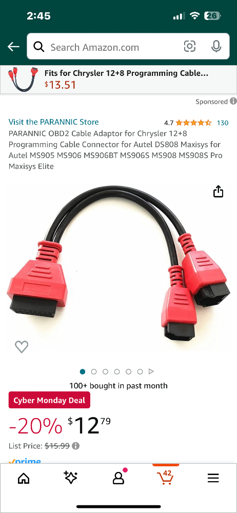

Only 2016 or 2018 cars and above though right. There’s a way around auto auth free. 12+8 cable. Amazon. 12 bucks.
