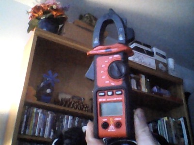

Hey all,
I recently bought a EM720C high current amp clamp from a reputable tool dealer. I was wondering if I can use this with my oscillioscope. I use a Autel MP408 and I have a conversion test lead with banana plugs that I can hook up to the scope and new meter. Can I hook into the ports on the front of the meter and set it for current on the scope, or would I have to set the scope to read voltage? I'm trying to get better at using a scope, i'm trying to perform a relative compression test for practice. my test vehicle is a 2000 honda crv. I also have a low current clamp from same tool dealer that is 30A max. Thank you for everyones input and insight.

As far as I can tell, the clamp/meter combo tool cannot be used in combination with a scope or another meter.
You're stuck using the digital display on the tool.
This doesn't make it a bad tool, just not useful for capturing waveforms.

I came to the same conclusion last night. Well, I did need one for work, so that's a plus. Thank you for the feedback. I'll just have to save up for another high amp clamp.
