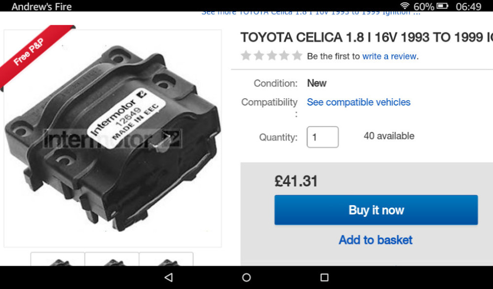

Hello,
This may seem like a silly question but after removing the rotor arm for replacement on my UK spec 1998 Toyota Corolla 4A-FE 1.6 engine with distributor and AC pick up coil arrangement I removed the ignition coil plastic cover and I cannot see where you would obtain a spark from this type of ignition coil?
By contrast my old '97 Honda Civic had a tower on the ignition coil that you could test for spark there, but no such tower on the Toyota ignition coil.
I read in Paul's excellent engine performance diagnostics book that you should always check for spark at both the spark plug and the ignition coil. Where do you test for ignition coil spark on this type of coil design?
No problem with the car, just curious.
Thanks
Steve

9 years 5 months ago #10306 by Tyler
Could you show me a picture of this distributor? If I'm understanding correctly, then this is a coil-in-cap design, with no external ignition coil?
If that's the case, then you're pretty much down to spark strength testing at the cap posts, like Andy described. Testing the coil by itself, in this case, would probably require you to remove the coil from the distributor.
At least the Honda coil-in-cap design had the coil output facing the cap, so you could do coil stress testing if you wanted. :lol:
9 years 5 months ago #10316 by Andy.MacFadyen
Replied by Andy.MacFadyen on topic 1998 Toyota Corolla ignition coil spark test?
I would think it will be this type
The following user(s) said Thank You: toyota1990s

9 years 5 months ago #10327 by toyota1990s
Replied by toyota1990s on topic 1998 Toyota Corolla ignition coil spark test?
Andy.MacFadyen wrote: I would think it will be this type
Thanks for the replies. Yes this is the type of ignition coil fitted
Stephen
