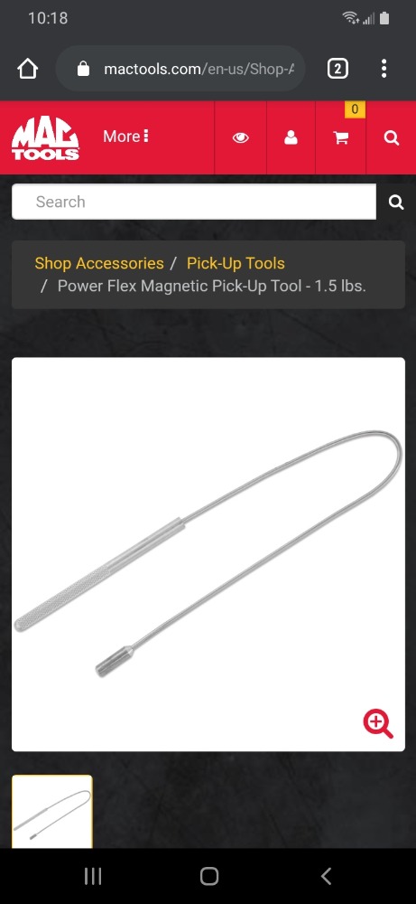

You are correct sir, every day I need my magnet!
This one can easily be bent any direction and is surprisingly resistant to breakage even after repeated bending. It will break eventually, but that's what the lifetime guarantee is for.
