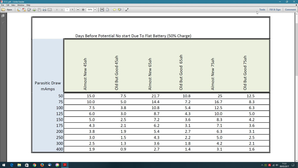

I ran up this table to estimate the days parked up before a non-start due to a given parasitic drain. The figures are very much on the pessimistic side.
