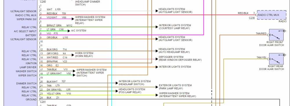

Replied by borntoroll on topic Parasitic Drain
Good start!
Make sure you "zero" amp clamp before use. Then just pull that suspected fuse(s) and watch the current draw. Do you get acceptable current draw when you remove 50A fuse?
Here is what mitchell thinks of your circuits.

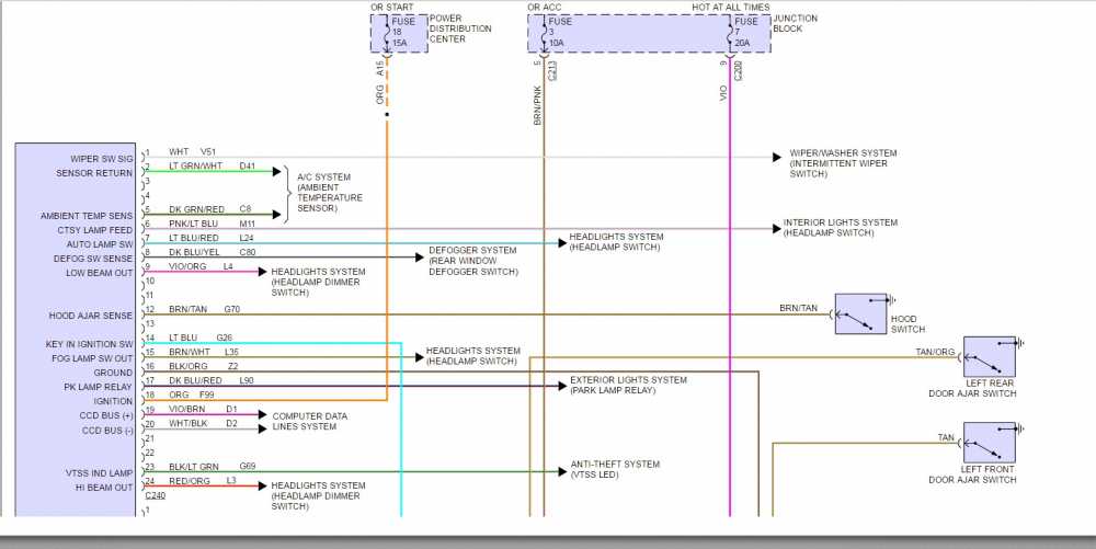

I see that you are on the right track, lets get into it a bit deeper, you found the you have draw on the 50 amp fuse, ok lets look the circuit that was provided by (Borntoroll) .
The 50 amp fuse is showing power and all other you tested are at 0 so, lets just focus on the 50 amp fuse. look at the diagram the 50 amp supplies power to 4 other branches each has a fuse . you can un plug each one and watch your meter at the 50 amp fuse and see if you have 0 draw when you see that you found the circuit at fault.
Now you need to do the same thing with each item that fuse powers, un plug each thing one at a time until you find the problem part.

Thank you for your help! I unplugged Instrument cluster and draw was still present. I am getting a VD at fuse #7 fyi. I unplugged the auto headlamp sensor and no change. I unplugged BCM and that is when VD/draw went to .000 as they should. So my issue is with the BCM or something attached to it.

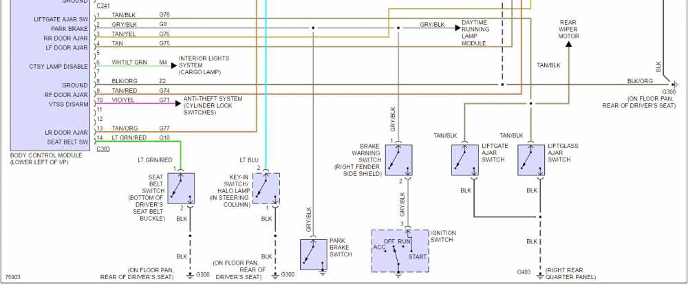

The FSM shows that the 50 amp fuse feeds Circuit breaker2 in the junction block, fuse 7 and 8 and if I recall fuse 9. Fuse 7 (20 amp in the Junction Block) are on the same circuit as the Instrument cluster, BCM, anti theft arm light, Auto headlights, diag connector and radio amp. Fuse 8 controls the trailer tow, rr wiper motor and lift glass.
I've cleaned grounds, tested sensors, fuses and relays and everything still seems to point to the BCM.
In other searches to this issue on Jeep related forums point to anywhere from, broken wires at the door hinges, tailgate and lift glass switches, power door lock modules. I would isolate those again to be sure.

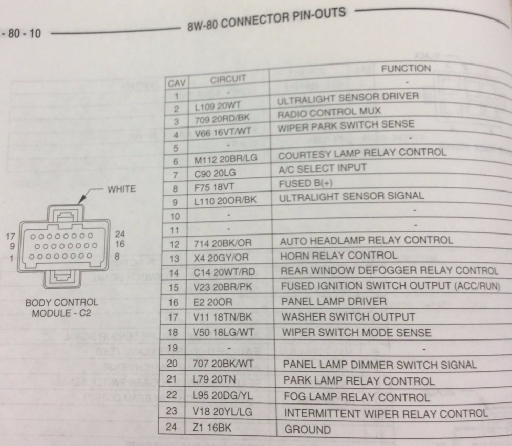

If you unplug the other 2 connectors on the bcm and the draw is still there, then the problem is without a doubt an issue with the wires on your 24pin white connector. On the diagrams provided, what connector # is it?

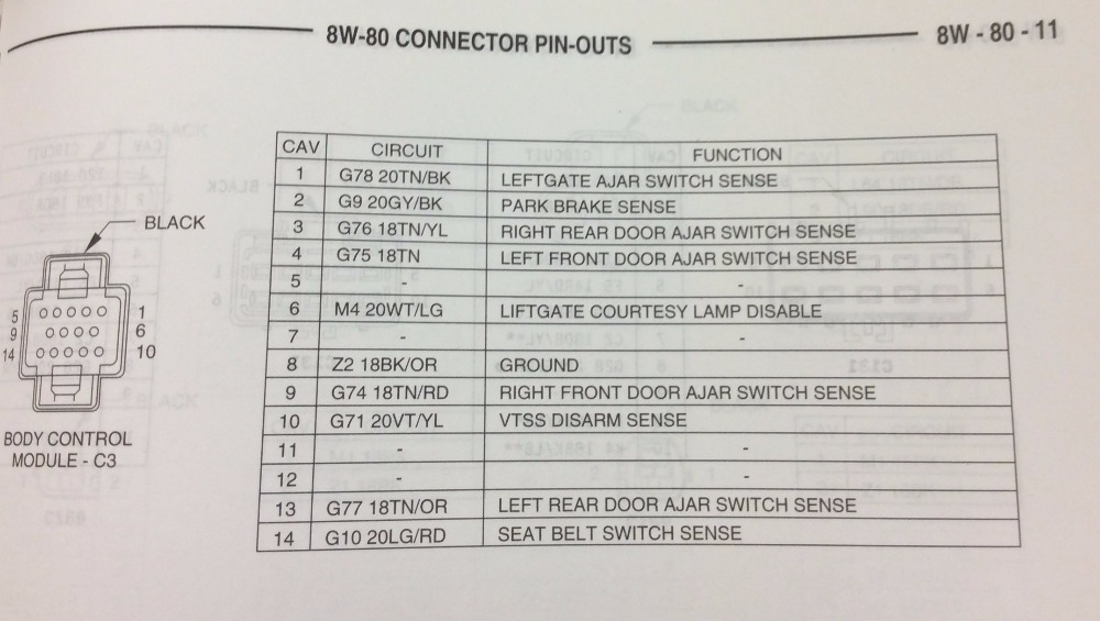

7 years 11 months ago #13757 by adadof3
Replied by adadof3 on topic Parasitic Drain
Here are the connector pinouts from the FSM. Hope this helps anyone.
