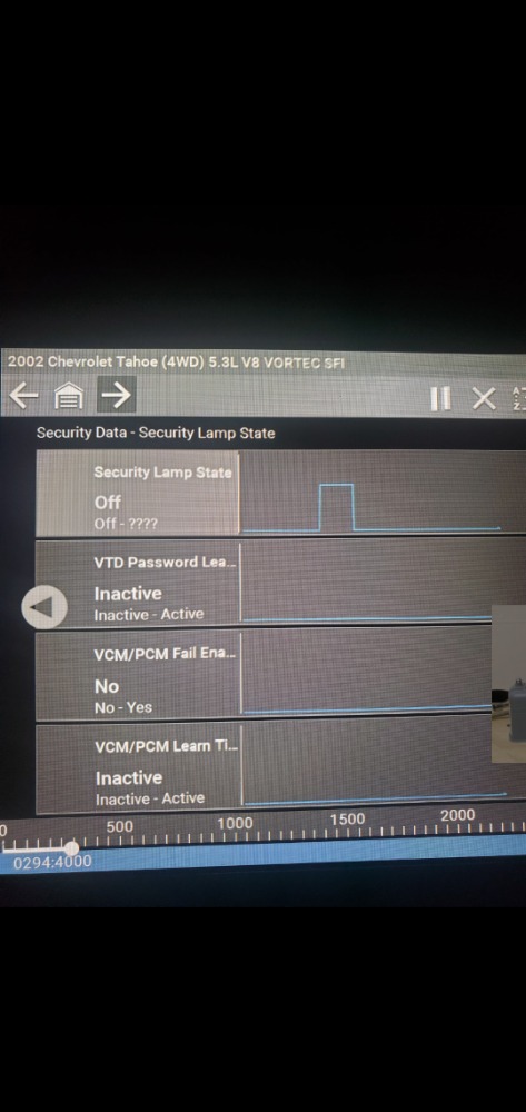

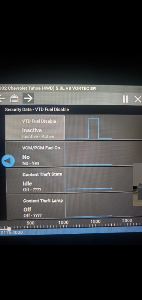

Replied by Jaguarpaw on topic Re:2002 chevy tahoe 5.3 vin z flex fuel no start
It's starts back up it doesn't go into the 10 minute lockout mode. I can start it back up for 1 sec. After a couple seconds. The security light is not on but in the scan tool it says it comes on then Goes off. I noticed that the 5v signal never drops after turning the key.
3 years 11 months ago - 3 years 11 months ago #51659 by Chad
No codes and not locking out the injectors for 10 minutes makes me think that it is more than a security issue. However, if you have no voltage drop on the yellow 5 volt signal wire, then you DO have a security issue. Are you testing the voltage at the sensor, or the BCM? If you are checking at the BCM, you need to go check at the sensor. Make sure you have a good power and ground at the sensor, too.  If you have good power and ground, then the 5 volt signal should drop when the key is turned to the start position. If it doesn't you need a new sensor.

3 years 11 months ago #51660 by Matt T
The signal itself is only pulled down while the key is in crank.The Passlock Data Voltage PID "latches" at the value measured in crank when the key returns to run.

3 years 11 months ago #51673 by Jaguarpaw
Ok thanks guys for the help. So mu conclusion is the passlock sensor is faulty since it's not causing the voltage to drop since I have ground and voltage on the other wires. Also, l found this video about how there are 2 modes for the lock out 1 for 10 minutes and another for 4 seconds.

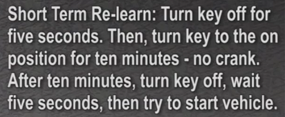

3 years 11 months ago #51679 by Chad
The primary difference between Short Tamper mode and Long Tamper mode is the  reset procedure. You can tell that you are in Short Tamper mode by the SECURITY light flashing for 4 seconds, then remaining on. The reset  procedure for Short Tamper only takes 10 minutes...Turn the key on, but do not try to crank the starter. After 10 minutes, the security light will go out. Key off, for 5 seconds. Then, start the vehicle.
