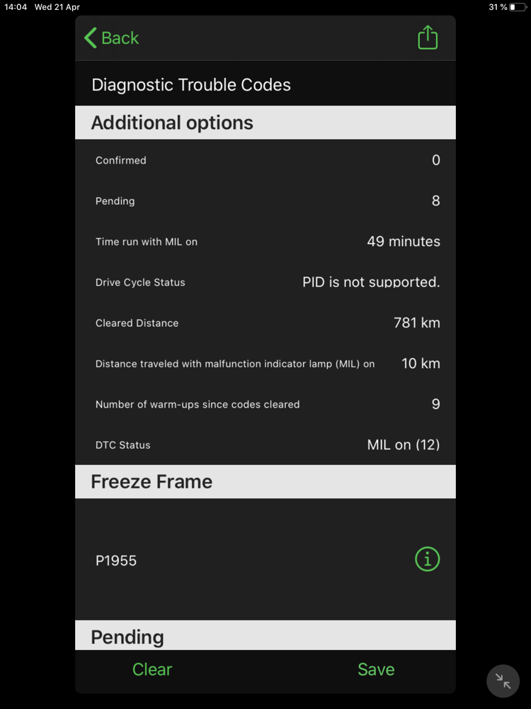

Hello good people,
I am writing with confidence that my vehicle problems will be solved here.
A Mercedes-Benz sprinter 2007 Turbo engine with a driveability problem. Vehicle refused to drive above 50-60km/hr.
There are two trouble areas I need your expert help on
1. MAF and IAT circuit open

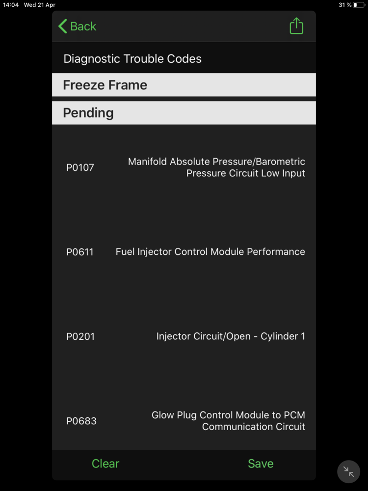

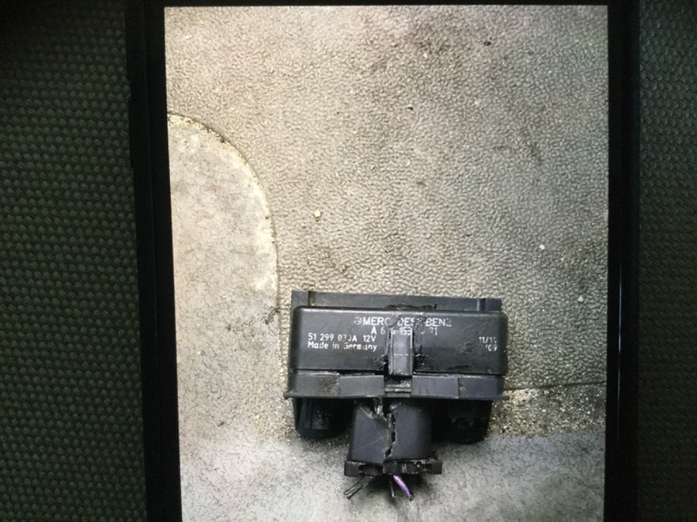

2. Glow plug module was burnt and a used one was bought as a replacement. I am still having the heater light on my dashboard and a flashing check engine light. I have replaced 2 glow plugs that were leaking diesel and also the broken fuel return line.
I have attached the DTC codes, but the Cylinder 1 injector circuit problem is not showing again.

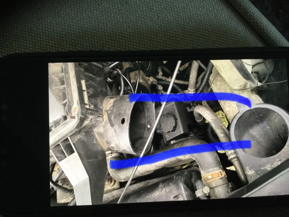

I noticed the wire harness to the MAF And IAT looks abused and also a missing plastic. I have checked for constant current to the MAF and got 4v at first attempt and later 15v at subsequent attempts, and the mass of air is 289.5grams at idle. What could be the cause of a flashing check engine light?
Please experts in the house help your boy out.

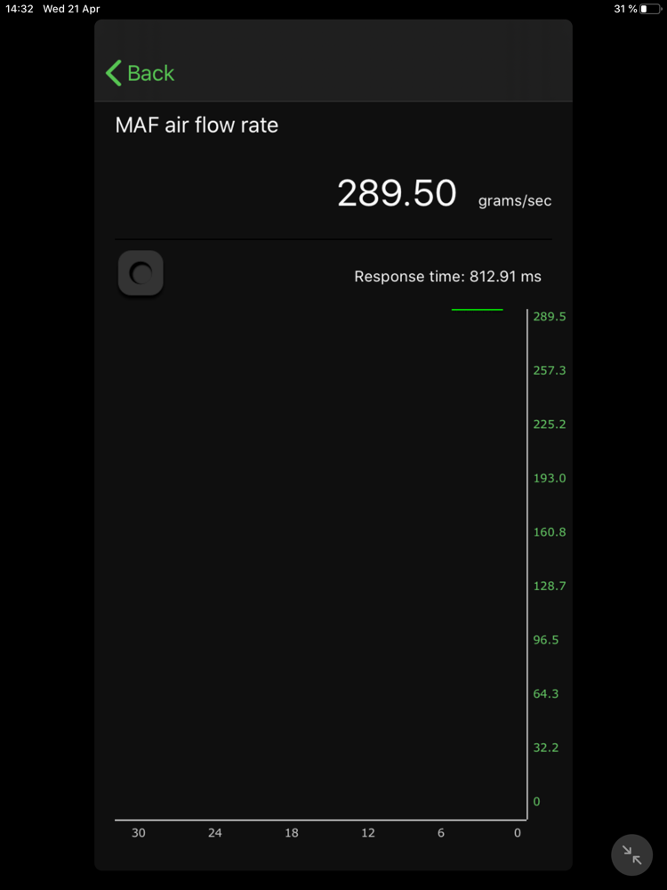

WIRE ONE: 7.04v (same reading Key ON engine OFF/Engine ON under load) Backprobed
WIRE TWO: 5.29v (same reading Key ON engine OFF/Engine ON under load) backprobed
WIRE THREE: 0.02v Key ON Engine OFF, 0.01v Engine ON under load backprobed

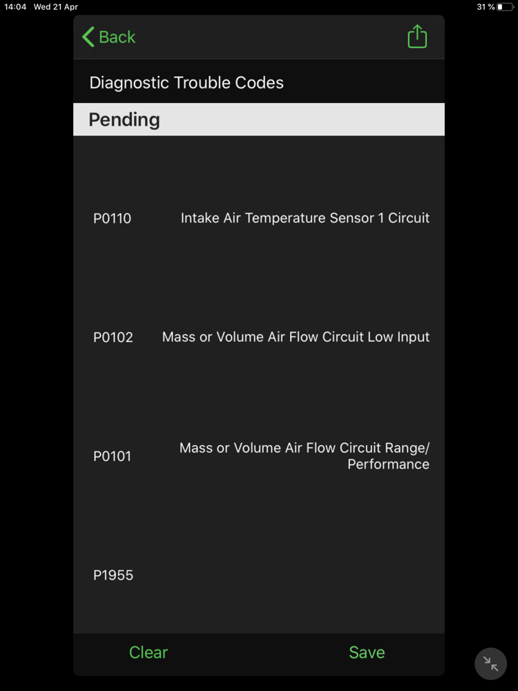

DTC’s
P0110 IAT
P0100 MAF
P0101 MAF
MAF sensor reading doesn’t move an inch on the OBD2 scanner, it’s stuck at around 289.50 grams/sec even at higher RPM
I hope I can get directions with all the tests done so far
Warm regards

What situation am I dealing with here please?
Still a voltage drop of 400mv on sensor ground.

3 years 11 months ago - 3 years 11 months ago #56021 by Hardtopdr2
Replied by Hardtopdr2 on topic Mercedes-Benz Sprinter Limp Mode Problem
Did some homework and the part you think is the iat is not an iat. The iat should have two wires
At pcm 96 pin connector....
Pin 28 at pcm brown/dark green iat ground
Pin 84 at pcm dark green/white iat signal
I'll put a few pics up in a minute

  • babajis2010
  • babajis2010's Avatar Topic Author
3 years 11 months ago - 3 years 11 months ago #56023 by babajis2010
Replied by babajis2010 on topic Mercedes-Benz Sprinter Limp Mode Problem
The truck is a Mercedes Benz
I know the dodge model has 2 wires to IAT.
That’s why I can’t use dodge wiring diagram to fix the Mercedes Benz
Attached pixs is where the IAT sits in the Mercedes’ Benz truck
Second pix is my truck with 3 wires
A 2007 Mercedes’ Benz sprinter 315 CDI
W906 OM 646.986
Last edit: 3 years 11 months ago by babajis2010.
