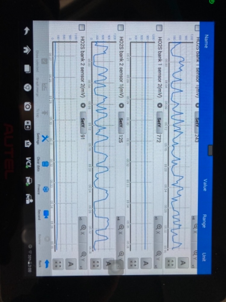

1996 Impala SS LT1 (Intake backfire) PART 2 live graph of the 02 sensors.

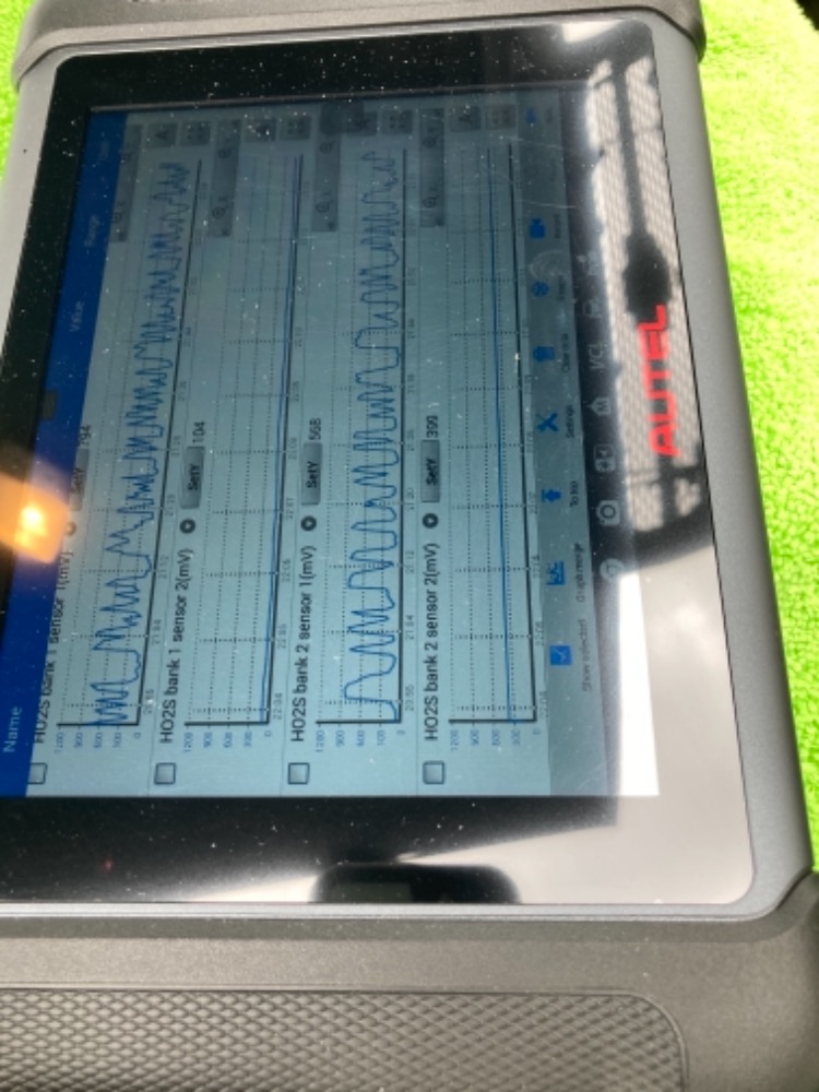

I took car for a drive today and I am seeing that bank 2 sensor 2 disappear from graph.
I tried holding at 2000 pm at a stop and it does not match the graph like bank 1 sensor 2.
something fishy with bank 2 sensor 2

today I was able to mess around with the car. I warmed up very well and i was watching graph on trims and o2 operation.
upstream sensors both banks up and down like they should 100-900ish
downstream sensors bank 1 ok
bank 2 as you know low but it is working
(its funny that sometimes after reving etc I see a flip in reading S2B1 now would show low and S2S2 reading middle of graph).
idle/2000 rpm
fuel trims
stft bank 1 and 2 around 0%
ltft bank 1 and 3 around 3%-5%
I created a vacuum leak and I noticed fuel trim spike right away which is good
2-3% on stft and ltft maxed out at 24
when I corrected leak it went back to normal which i was happy with .
I then used same port to feed propane with a silicone line. I opened up propane slowly then full i was only getting a bit rich reading change but when i turned off the propane I did see o2 lean so they are working fine in my eyes.

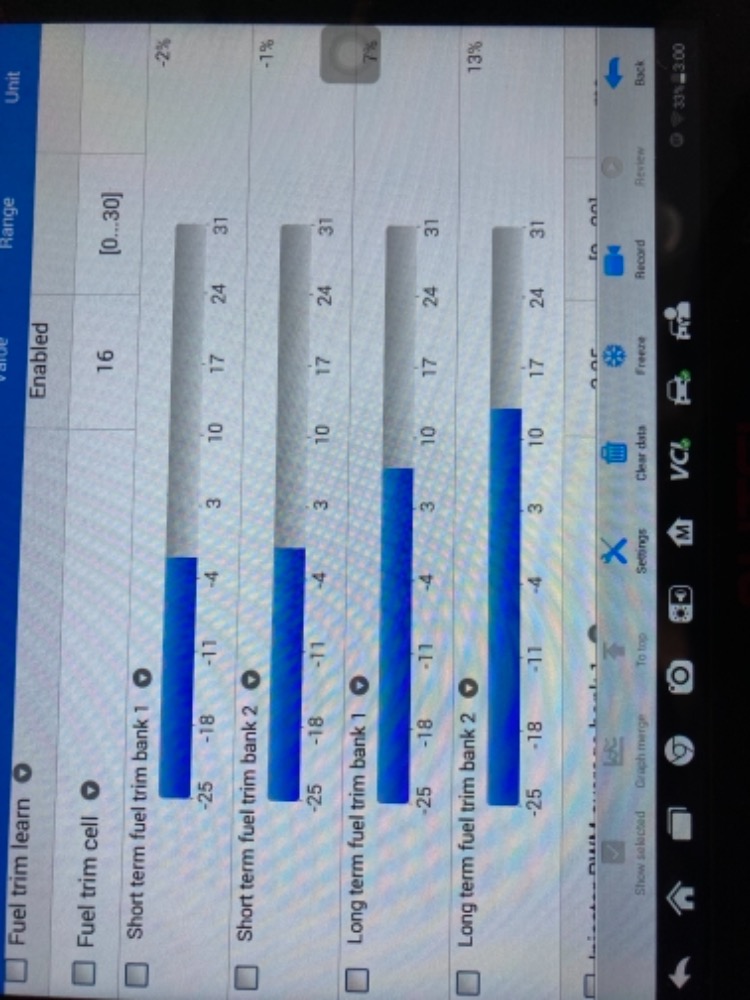

so then I tried with brake cleaner and that was great I can see on scan tool everything I wanted.
What I saw with brake cleaner added
STFT B1 -21
B2 -15
LTFT B1. -15
B2. -15
I was able to get her very rich.
All 4 o2 sensors shot up rich (900mv)
then when I stopped adding brake cleaner I saw system shoot to very lean and then it corrected its self afterwards.
Once settled I saw (no brake cleaner)
STFT B1 3
STFT B2. 3
LTFT B1 -3
LTFT B2. 0
(on graph see picture)
upstream sensors working up and down
B1S2 was around 104mv steady
B2S2 was around 399mv
see what I mean sometimes B1 is around 400-500 and B2 is at 104
interesting ...........

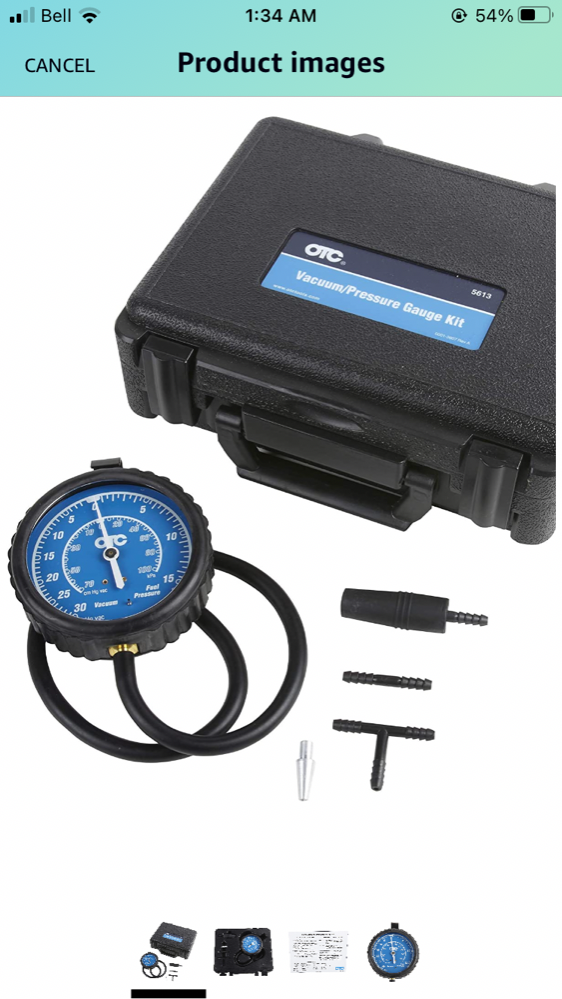

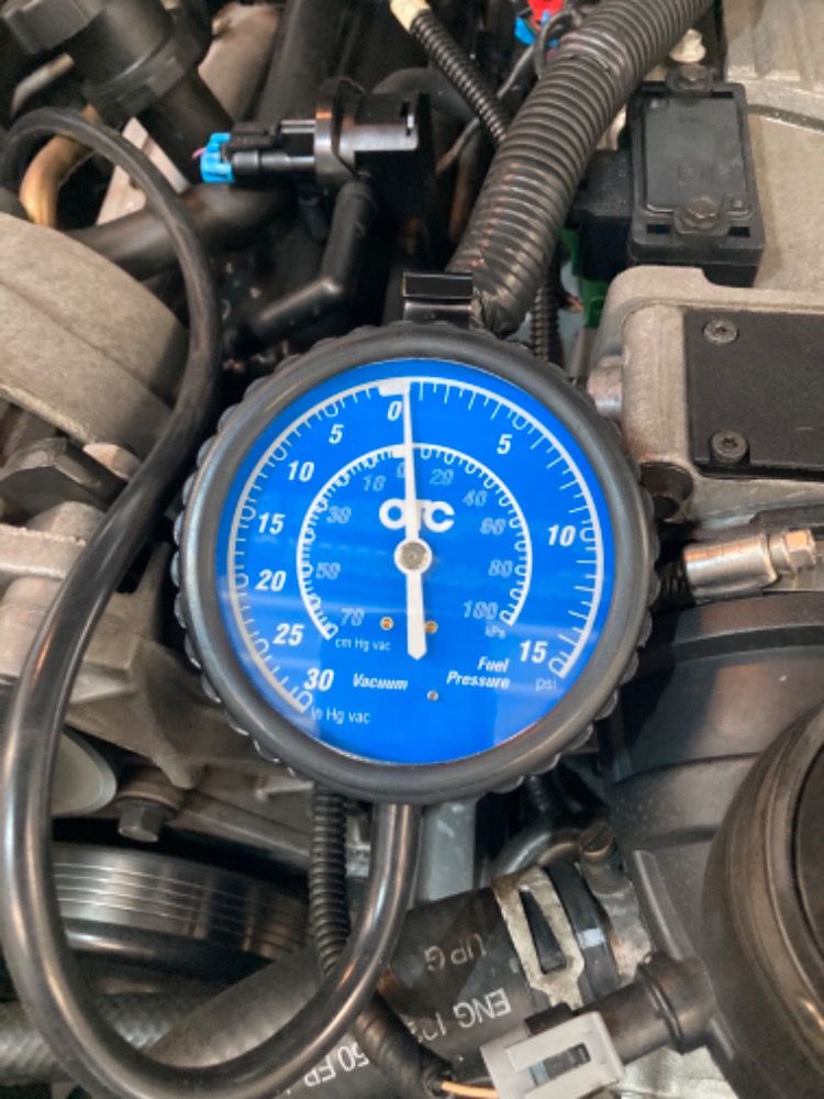

The way to check for a cat problem ie plugged/restricted cats is to take upstream sensor out and thread in an adapter hooked to a low pressure gauge 20 psi or less with a vac hose or a piece of brake line . These gauges are in a carborated fuel pressure test kit plus they have a vac readout on them as well and they are not expensive as well. Then once its hooked up start the car and see what reading is at idle then at higher rpm. The pressure should not exceed 2-3psi if it goes over that then cat is restricted. Repeat test for each side. Let me know if you have any issues etc.
- D250
- Posts: 17
I actually have the otc vac/pressure gauge it goes up to 15psi so I think it will be perfect for this test
Just need to think of fitting to use into cat.

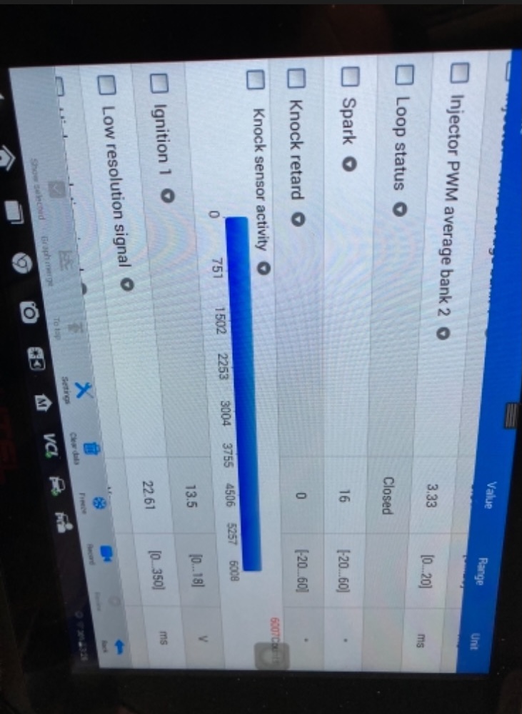

Ps my autel says my knock count is 6000 perhaps that sensor is finished ? Maybe related to my issue

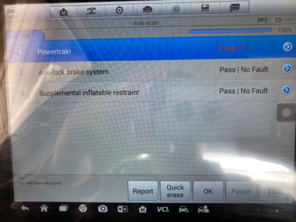

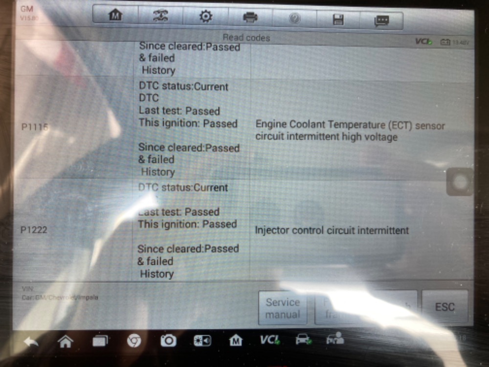

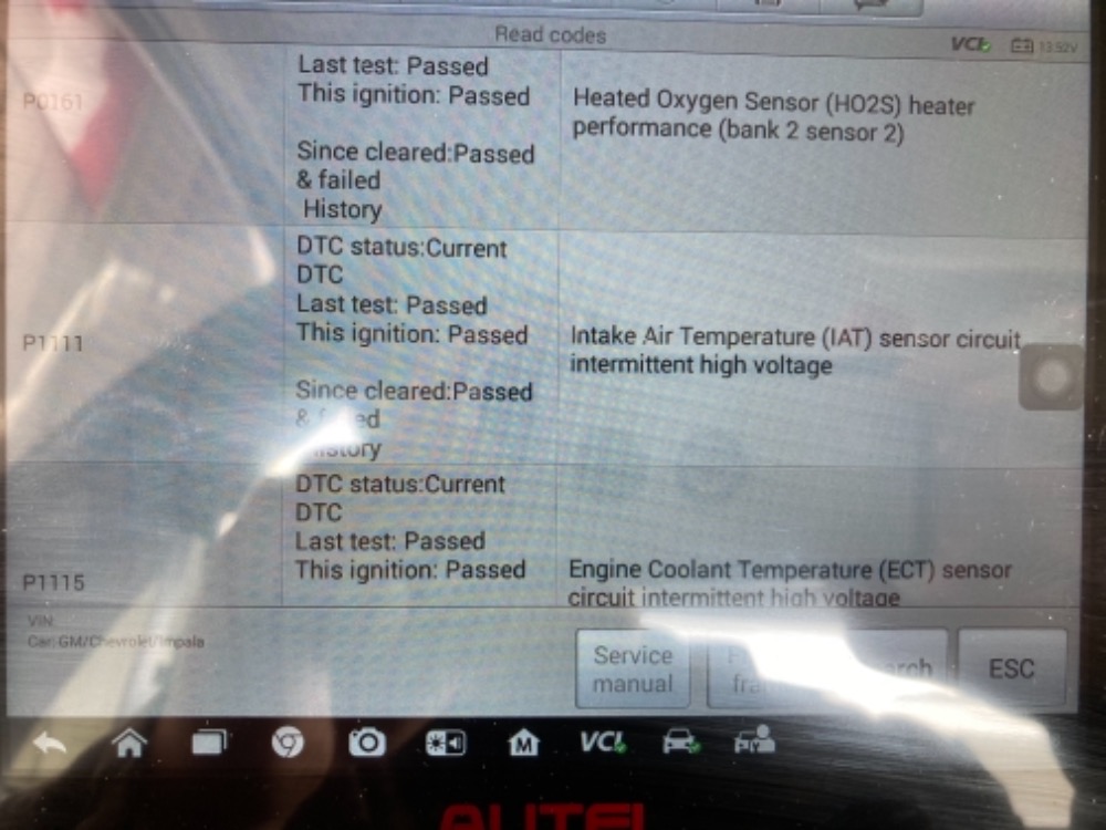

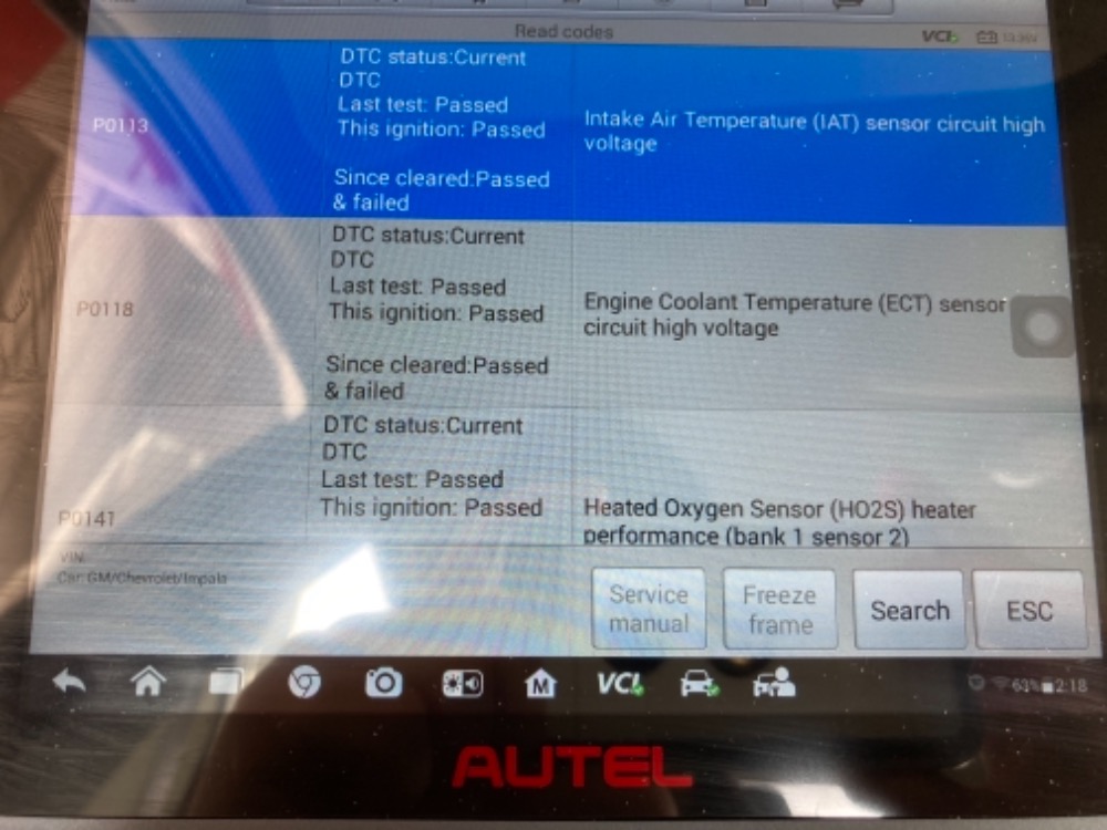

the codes you see where most likely when I first tested my new autel and messing around unplugging things to see if it ran better etc
as of now under current codes there are none after I did a clear codes and test drive
ps there is another tab on autel called addition codes which I don’t understand what they are since they can’t be deleted

the knock count is fishy thou it does not move from there
I removed both knock sensors and tested on bench with scope and meter and both were in gm
spec
plus voltage at pig tail at KS is to spec to so why it’s shows that knock count and why its not going up and down as it should is confusing

I think before I dive into timing I like to see whats up with the knock sensor system showing that high number on scanner.
