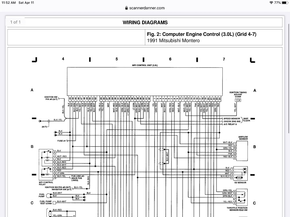

I did some rechecking on the wires and my wiring diagrams only go up to 52. It has Been difficult trying to track the correct diagram.
First the #1wire coming out of the power transistor goes to 28 on the Ecu and has .0 ohms. I couldn’t find any brakes or places where I might have shorted to power and reeds 2.9mv with the key on.
Not sure if that tells you anything with a bad Ecu.

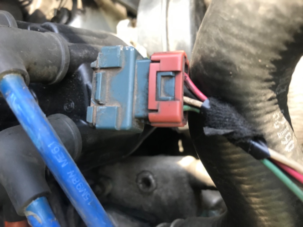

On the Distributor the wires on the connector are a little different. 3 Green and 4 white are swapped on my current connector which has not been replaced yet. I was getting a reading of :1# red 9 v;
#2 black G 0v; #3 White 2.3 mv ; #4 Green 2.3 mv.
5 years 5 months ago - 5 years 5 months ago #38920 by jreardon
Replied by jreardon on topic 1990 Montero 3.0 Crank, No Spark
Time for some detective work. I've attached '89 '90 and '91 wiring diagrams.
The '89 wiring diagram has the correct wire color sequence at the distributor from your photo. Can you see if the colors match up at the ECM harness?

Looks like the ECU matches up best with the 91 go figure. Vin plate says 89 and the engine says 90. The white and green are still flipped on the diagram for the distributor.

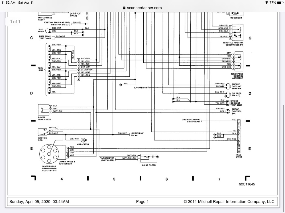

Ok so here is where I’m at I have the new ecu not installed yet. Wiring diagram follows 91.
Question is the wires that I follow from the distributor do what they are supposed to do green goes to power Transistor, o2 sensor and ground 48 in ecu.
White goes to purge control sol,
Mpi # 5 red, idle speed control red/red, o2sensor, injectors.
On my connector those wires are switched 4 green and 3 white.
That is still the same from the factory.
Should I cut and swap those wires at the connector? Could this be frying the ecu? It is a new distributor. Or should I try to reinstall the original distributor?

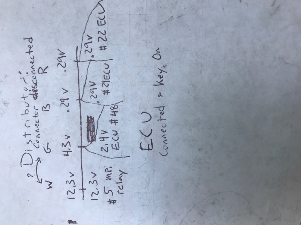

5 years 5 months ago #39029 by Minivandan
Replied by Minivandan on topic 1990 Montero 3.0 Crank, No Spark
I tested the wires at the distributor and the ECU with key on and all the engine side sensors disconnected. Here are the results.
There is also a click sound coming from the ECU when I test the black wire #21 to ground.
What are your thoughts
Thanks

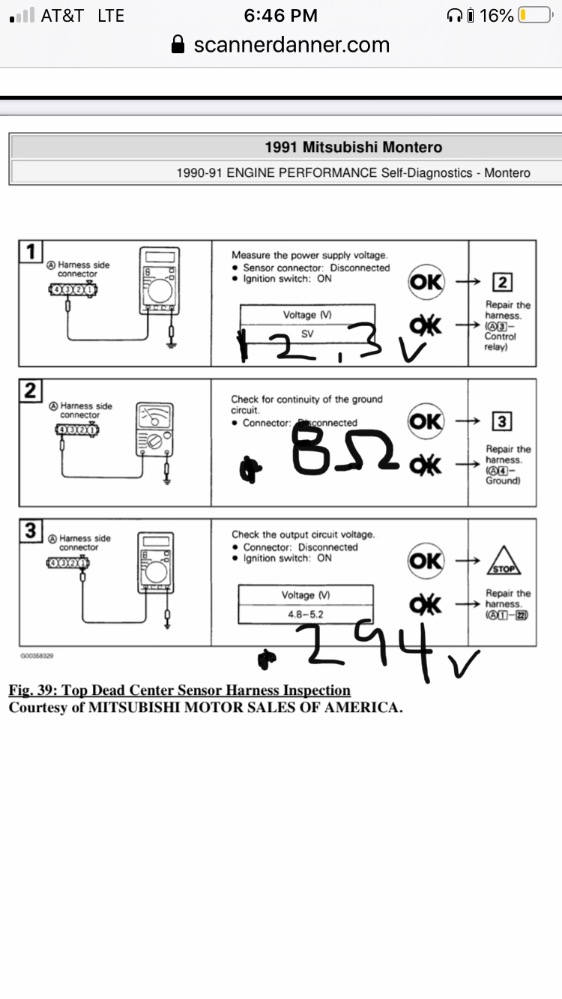

5 years 5 months ago #39030 by jreardon
Hopefully this is accurate since there's a picture of the internals of the distributor. Leave connector as is and use the new distributor you have already.
Focus on #4 pin terminal, it's a ground. We just have to trust this picture.

5 years 5 months ago - 5 years 5 months ago #39032 by jreardon
The green wire should be a ground. Measure middle terminal of power transistor, unplugged, what is voltage reading? If you're reading elevated voltage, jump it to ground.

5 years 5 months ago #39037 by Minivandan
I am reading 3.5 v with black on ground battery ground and positive going to # 2 black on the power Transistor. And 3.5v
With the black on battery neg and green wire # 4.
Correct?

5 years 5 months ago #39039 by Minivandan
These are the reading I’m getting
for those tests.

5 years 5 months ago - 5 years 5 months ago #39040 by jreardon
Don't do ohm checks for grounds. Your voltage reading was elevated on the grounds, that's enough to tell you it's no good. I don't like .294 V either on the signal wires, i'm expecting around 5v (unplugged). Do you have 5v at the TPS?

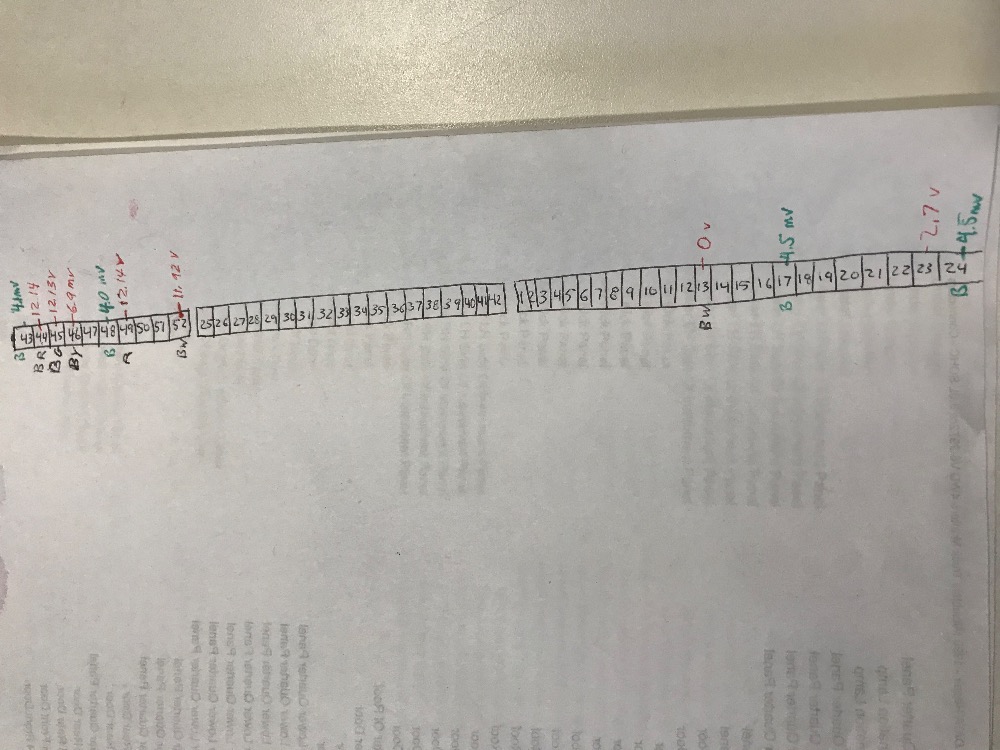

5 years 5 months ago #39057 by Minivandan
2.7v at TPS green and yellow wire. With key on. Working on checking the other diagram

5 years 5 months ago #39063 by Minivandan
These are the current readings taken with the multimeter black on battery neg and red back-probing at ECU and key on.
Haven’t tried cranking yet.
Thanks

5 years 5 months ago #39080 by jreardon
I don't like 2.7V (pin 23) on the 5V reference wire going to the airflow sensor and TPS. Try unplugging both of those sensors and retake voltage reading for pin 23, key on of course. Happy Easter to you as well :)
