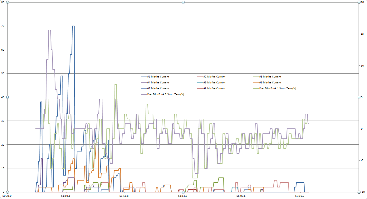

Data:
With a "cold" start this morning, the data (Torque-Pro & a cheap bluetooth scan widget) shows misfires on multiple cylinders.
Cylinder 1 is the worst, followed by 6, then 4, 3, and 7 to a much lesser extent. Yes, it's MOSTLY on the AFM cylinders, but not entirely. Both banks, too.
After about 2 minutes, as the idle speed drops (and the engine load, and MAF, and throttle and everything else that goes with it) the misfires quiet down, but pop up randomly among several cylinders.

7 years 4 days ago #33750 by Chad
What is you fuel/alcohol composition? How are your fuel trims?
7 years 4 days ago #33752 by D C
Ethanol: 12.9%
Here is the idling graph with short term fuel trims on it
And with long term

7 years 3 days ago #33755 by Tyler
The miss when cold, plus the high fuel trims, makes me think of leaking intake manifold gaskets. It's not as common on the LC9 as it was with the LM7 and L59, but still happens. The good ol' ScannerDanner water test will work perfectly if you test it at idle on a cold startup. ;)
However, that doesn't explain the hesitation and misfiring while driving. :unsure: Because you're seeing miss counts on #1 and #4, you may be looking at damaged spark plugs from oil consumption (AFM cylinders). #1 is right out in the open, so I'd suggest pulling it for evidence of oil or ceramic damage.
I really don't think you're looking at AFM problem just yet. A completely stuck lifter/wiped cam would likely be a dead miss, as you know. I've seen failing lifters stick and unstick, but you can always catch them with a relative compression test when they stick.
