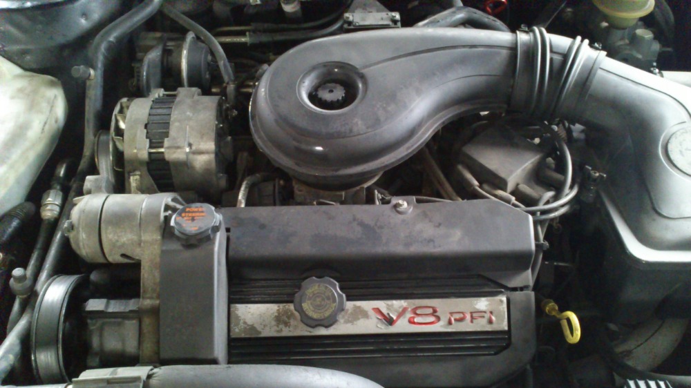

Cadillac Deville 1992 4.1lt V8 PFI
Customer complain:
-Crank, Start and it runs just fine when it's Cold
-There is a slightly hesitation when he crank the engine like the battery is bad and sometimes It's hard even to notice this hesitation.
(he has put a new battery and starter in order to fix this but it didn't)
-Crank, No Start when it's Hot.
(If he let it cool down, it starts just fine.)

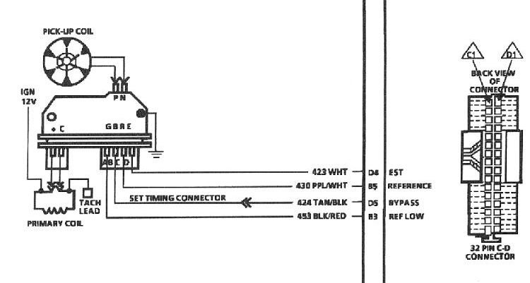

Hi
I have No Spark, No Fuel Pressure when it's Hot
I found a Wiring Diagram on Google for the Distributor.
It's from 1995 Cadillac Deville, not 1992 but it looks the same.
Could you tell me if I can do some checks on it with my Test Light?
The 430 PPL/WHT B5 Reference should be power, 5v?
The 453 BLK/RED B3 Reference Low should be ground, 0v?
Is it possible to check my Pick-Up Coil and Primary Coil with just a Test Light?

Is not possible to check in a conclusive way with test light. You can check some voltages, byut nothing else.
It's better perform basic tests like Paul suggested you.
We need to figure out what exactly you are lossing (spark, fuel, air reading) we need to know where to focus on.
