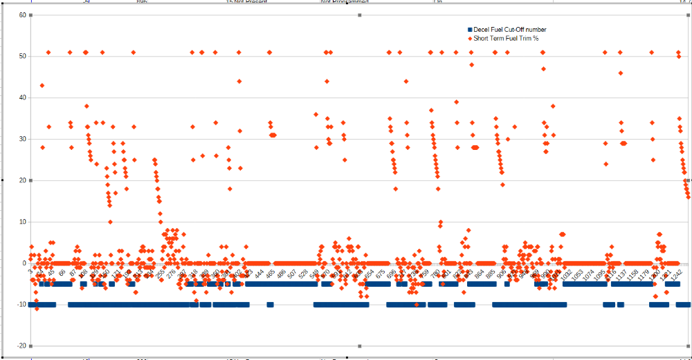

3 weeks 5 days ago #93283 by Tyler
Replied by Tyler on topic Strange STFT spikes
It also has a pid called decleration fuel cutoff.
Perfect. That's the one you'll see changing when the short terms spike. Loop status will tell you the same, but GM is nice enough to give additional PIDs that spell out what's happening.

3 weeks 5 days ago #93287 by fj5gtx
Replied by fj5gtx on topic Strange STFT spikes
Got the car together enough to test drive it. Turned all the pids on for datalog. Graphed the STFT and Decel, added a column and wrote a function to give me numbers so I could add to the chart. I used -10 for inactive and -5 for active.
Attached data file (no formula) and graph...

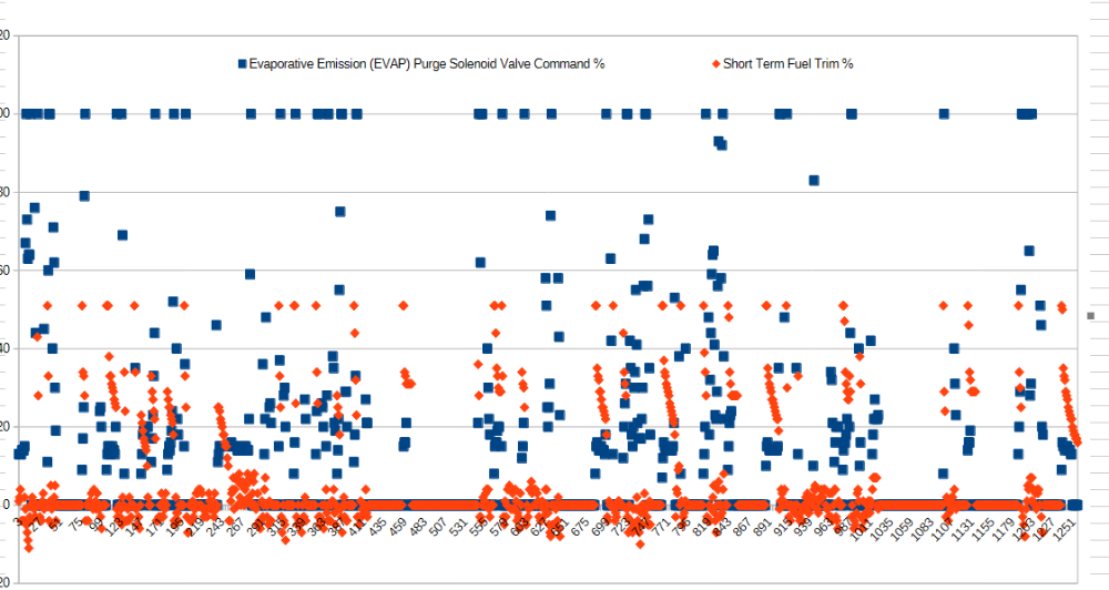

3 weeks 4 days ago - 3 weeks 4 days ago #93290 by fj5gtx
So maybe I'm onto something.  EVAP Purge Valve was replaced due to a pending code and classic hard start (flooded) after gas tank fillup a couple months ago.
But as I said at the start of this, STFT spikes positive is still a bit confusing.   I noticed that the EVAP monitor wasn't set after a couple days of driving 400 miles/day.  And I'm seeing some correlation to the Purge Valve opening and STFT spikes.  LTFT always low, but always negative.
Then I notice this other pid, EVAP Vent Solenoid valve command is always "Venting".   I don't know what the normal operation of that thing is... but maybe something is up.
I graphed STFT and EVAP Purge Valve... and I think I see correlation, see for yourself.

3 weeks 2 days ago #93295 by fj5gtx
After some further research... I think the answer is: when the purge valve opens, the engine is programmed to expect a certain amount of predicted fuel vapor.  If that fuel vapor isn't there, the STFT spikes to compensate for the temporary unexpected lean condition.
New data - the EVAP inspection monitor(i/m) won't set, nor will the Catalyst i/m. Can't pass PA inspection with 2 i/m incomplete.
I also noticed that the gas cap isn't clicking anymore today. Unfortunately there is also some corrosion on the lip of the filler tube. Ordered a new OEM gas cap.  Hopefully that takes care of the problem, as I am not looking forward to changing the filler neck.
3 weeks 2 days ago #93296 by Tyler
That's normal operation. The only time you'll see the vent close with the engine running will be while the ECM is doing the .090"/cap off leak test.

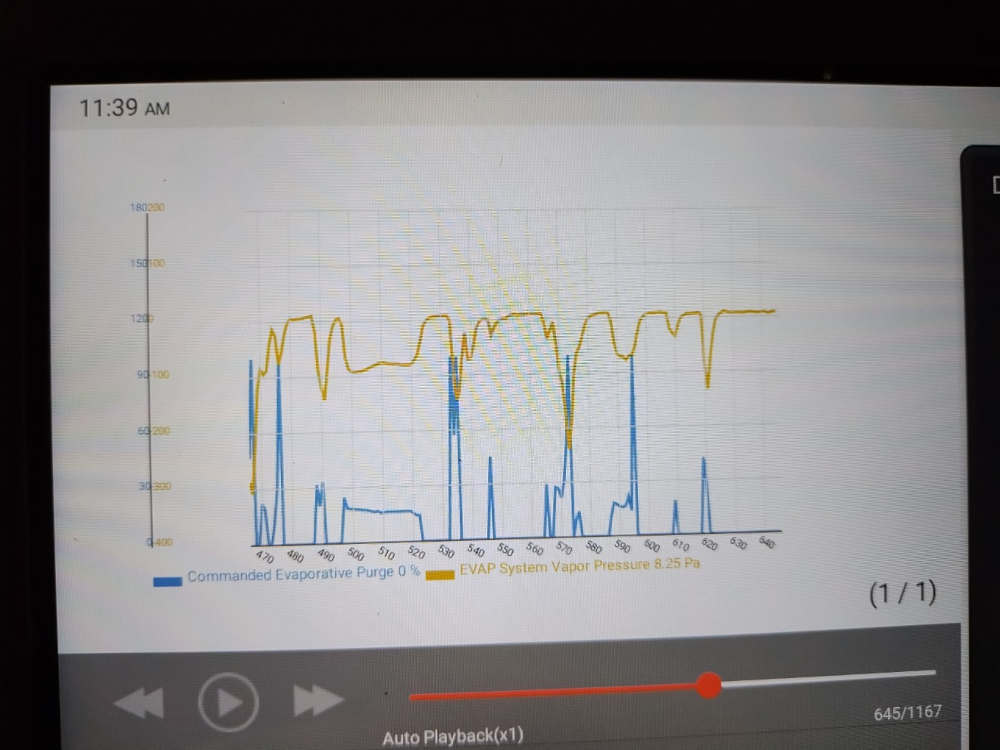

3 weeks 1 day ago #93297 by fj5gtx
Yesterday I had a new spare front o2 sensor, so I put it on to see if the graph would look any different than the 12 year old 156k mile original sensor.  Graph looked identical, and I got the old one off without ruining the wire - so I'll put that original on the shelf for a rainy day.   No change in I/M status, still 2 incomplete.
I graphed the purge cmd and the evap vapor pressure on the K7 and took a pic with my phone....
The OEM gas cap showed up late this afternoon - nice that Amazon would deliver next day and its OEM.   Installed the cap and took a another ride.  I've take alot of rides over the previous three days.   Got it nice and hot, mixed driving.  Sat with it running in a parking lot for a couple minutes.   Got back and checked, Catalyst is now complete - WHEW!
EVAP is still incomplete, but I didn't really expect that one to finish on the first run with a new gas cap.   Pretty sure I can get a PA sticker with only one I/M incomplete, so I think I'll get that tomorrow morning so the car is legal.
Once I get a sticker, I'm going to capture another datalog and see what the EVAP system vapor pressure looks like when the purge hits.... also see if those STFT spikes are still happening.    Goal is to get EVAP I/M to set.   I'd really like to see this car totally squared away again.

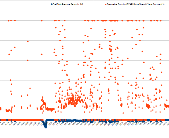

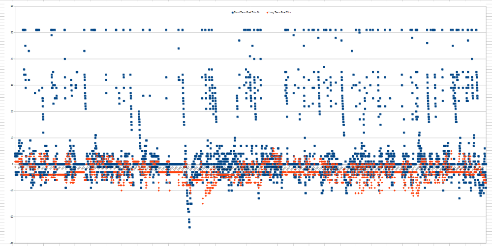

  • fj5gtx
  • fj5gtx's Avatar Topic Author
3 weeks 8 hours ago #93300 by fj5gtx
Interesting in that the LTFT are no longer always negative.   I made two changes yesterday: I replaced a gas cap that no longer clicked, and I replaced the original upstream o2 sensor.   The STFT still spikes.  I thought the new o2 sensor waveform looked identical to the old one - I'll have to dig around and see if I have the LTFT data after the o2 sensor but before the gas cap.
And on the second chart, I noticed that the tank pressure changed significantly - then I looked at the evap vent solenoid actually went "not venting" for a short period of time, right about the same time as the tank pressure anomaly.  May have witnessed an EVAP I/M attempt there?

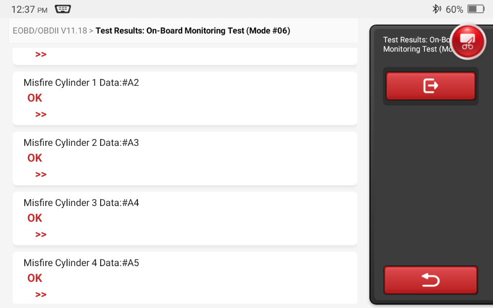

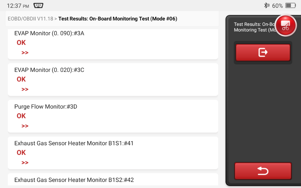

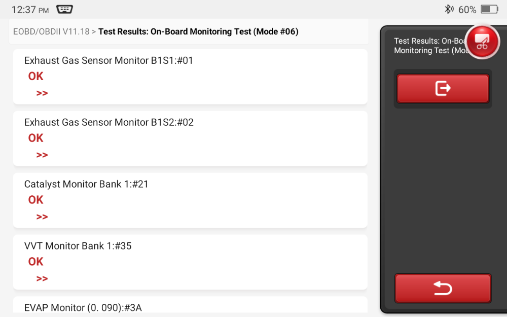

Either way, that's just one or two parts of the EVAP monitor. To figure out which boxes still need to be ticked, you'll have to do some digging. Checking the Mode $06 data is one place to start. You may be able to see which tests are completed, and which aren't.
Using your K7 is another. Somewhere in the fault codes menu, there'll be an option called 'Diagnostic Test Status: Since DTC Clear'. It's a list of all the fault codes who's tests haven't run and passed yet. There'll always be a list of codes in there - don't sweat it. Just look for EVAP codes. The codes you see are the tests that need to be completed.
  • fj5gtx
2 weeks 6 days ago #93303 by fj5gtx
The Actron scanner I have says the EVAP I/M is still inc. But the K7 shows everything "OK" in mode #06... not sure what to believe.
