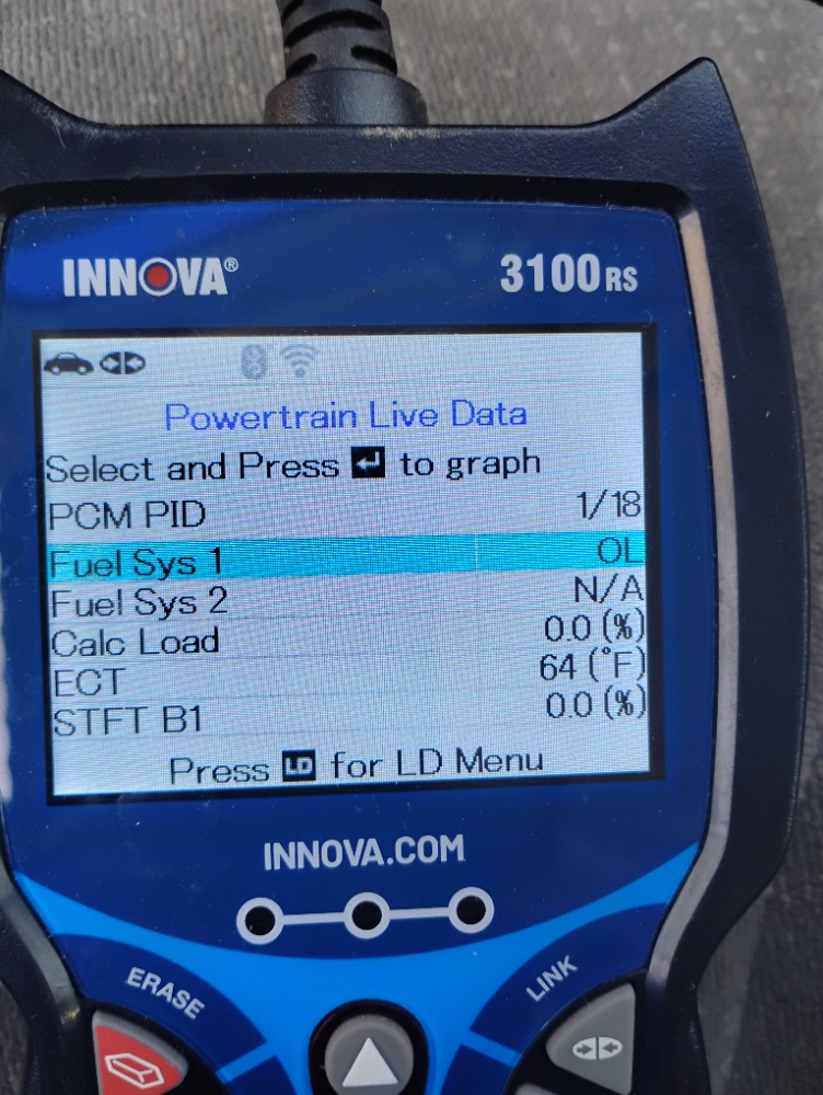

1 month 4 weeks ago #92014 by Zfrtech1
Replied by Zfrtech1 on topic 2001 Honda accord .2.3 L VTEC running rich

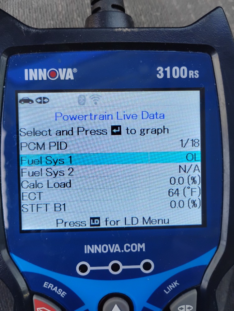

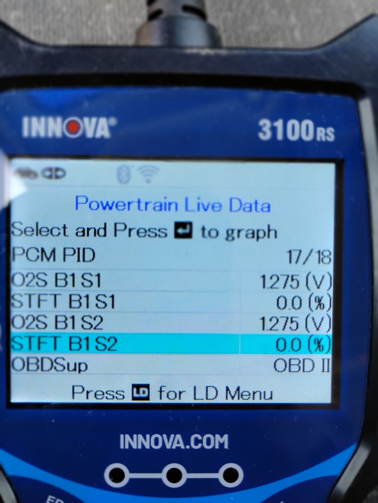

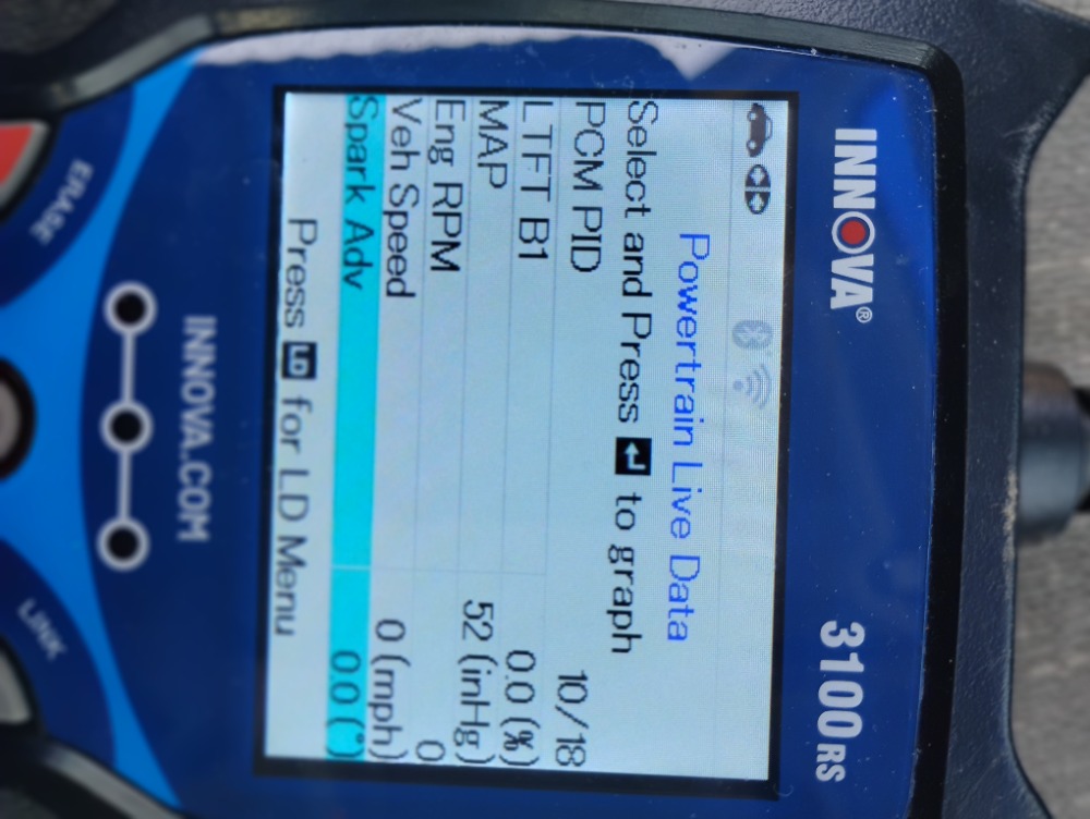

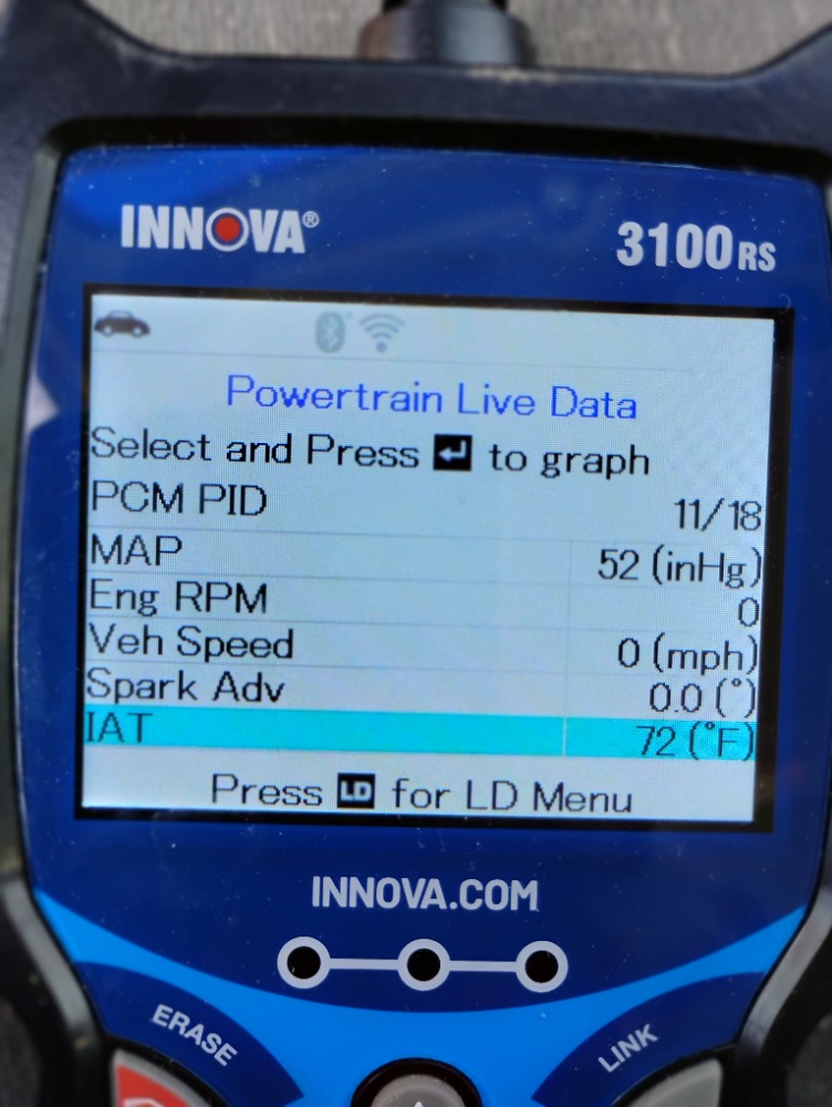

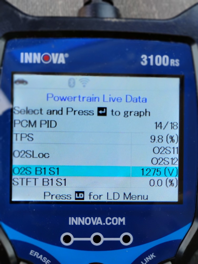

Hey Chad.. sorry slow response and getting back.. not sure if this will add any value or help in your question here is some pictures on the live data stream which is all I could obtain with the Innova scanner... Looking at purchasing or borrowing one to further the test but no luck... Question what do you recommend or use for a scanner for yourself..... Also just found out from the owner a more detailed answer on how the problem started... He burnt a valve on the engine R + R cylinder head.. got it all fixed and repaired and machined.. and then problem( Rich condition) then occurred...... Enclose your fine pictures attached not sure if they'll do any good let me know how I can add to it.. and by the way I totally appreciate your input and help on this like no tomorrow.. thank you so much.. cheers ?✌️

1 month 4 weeks ago #92016 by Tyler
Replied by Tyler on topic 2001 Honda accord .2.3 L VTEC running rich
Hey Zfrtech1, I moved your thread to the Repair section. It'll be seen by other members there and get more traffic.

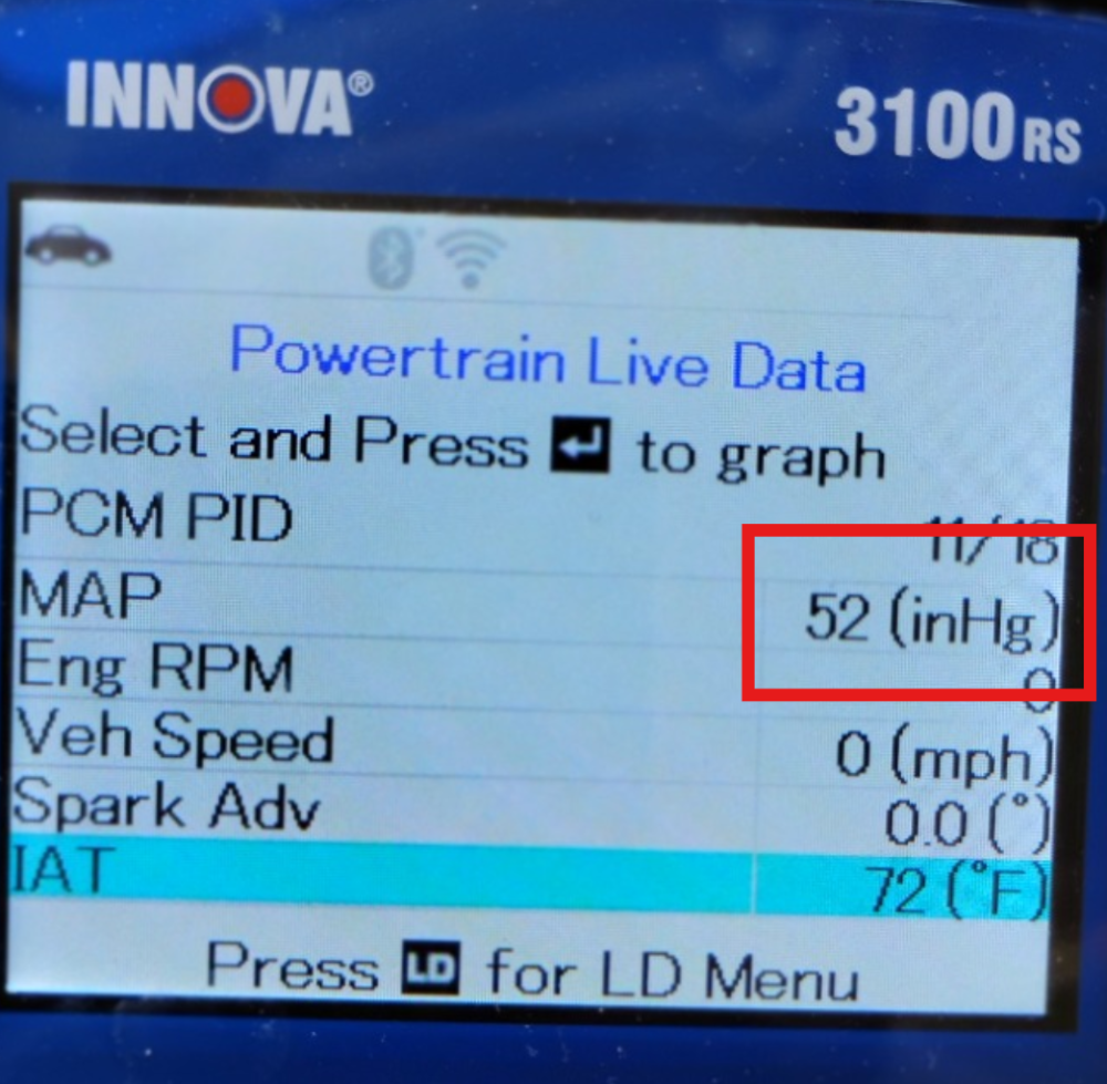

First thing that caught my eye in your captures was the MAP sensor showing 52 inHg with the key on and engine off:
With the key on and engine off, the MAP should be showing barometric pressure, which is usually somewhere around 28 inHg (depending on your altitude). 52 inHg is way too high. A skewed high MAP reading will incorrectly indicate to the ECM that the engine is under more load than it actually is, which can cause a rich condition.
Would you mind retaking the same pictures with the engine idling? With the Fuel Sys 1 PID showing 'CL', if possible.
1 month 4 weeks ago - 1 month 4 weeks ago #92017 by Chad
I agree with Tyler 100%. At sea level, barometric pressure is about 30 inHG. The higher you go in altitude, the lower that number will be. A reading of 52 inHg is not possible anywhere on surface of the earth.
Grab a volt meter and take some voltage readings at the MAP sensor, with the sensor connected/plugged in.
Pin 1 of the MAP sensor connector is the sensor power. It should be yellow/red and be at 5 volts. Pin 2 is the sensor ground. It should be green/white and it should read very close to 0 volts (less than 100 mV) with a volt meter. Pin 3 is the MAP signal to the PCM. KOEO, it should be about 4.8 volts and it should drop to about 1 - 1.5 volts at idle.

Hey Tyler thanks a million for the reply... Yeah that makes total sense I replaced the map sensor.. still the same... Yes I can barely get it started.. it starts and then just quits after a few seconds.. plugs extremely wet. .. back probed the reference signals.. 5 volts to the sensor.... Do you know where I person can get the reference data for that stuff... Thanks in advance

All right map sensor readings drop back to 27.  . Not sure why that is

Yes still totally over fueling. .. it will only run for a few seconds. In December when it was -25 it ran for a few minutes. So yes that's when I realized the rich condition. Well the readings of 52 in/hg is when the Map sensor is unplugged .. and 27 in,/hg when plugged in... And 2.68 volts when cranking over.. not sure where else to go from here so I appreciate all your help .. thanks so much in advance ?✌️
1 month 4 weeks ago - 1 month 4 weeks ago #92029 by Chad
Are ALL of the spark plugs getting wet with fuel?
If this engine has a vacuum controlled fuel pressure regulator, pull the vacuum hose off of the regulator and see if it is wet with fuel.
Do you have a way to check fuel pressure?
The ECT reading is 64° F. Is that an accurate temperature for what the ambient temperature was for a few hours before you took those pictures?
The IAT reading is 72° F.   Is that an accurate temperature for what the ambient temperature was when you  took those pictures? Normally, you would expect to see the ECT and IAT to be within a couple of degrees of each other if the vehicle has not been running. You have a difference of 8°.
Depending on your location and the time of day, this could be because it is/was late morning and the air temperature has warmed up faster than the coolant temperature. Is this the case?
Have the fuel injectors been changed, recently?
The PCM ignores the O2 sensors when in OL so, this shouldn't be the cause of your over-fueling but, your O2 sensor voltages are 1.275 on both the upstream and downstream sensors. I would expect to see 450 mV on a cold start. This might just be an INNOVA scan tool thing, especially since you have not achieved CL, yet. I wouldn't waste a lot of time on it but, it might be worth while to check those voltages, if the sensors are easily accessed.
