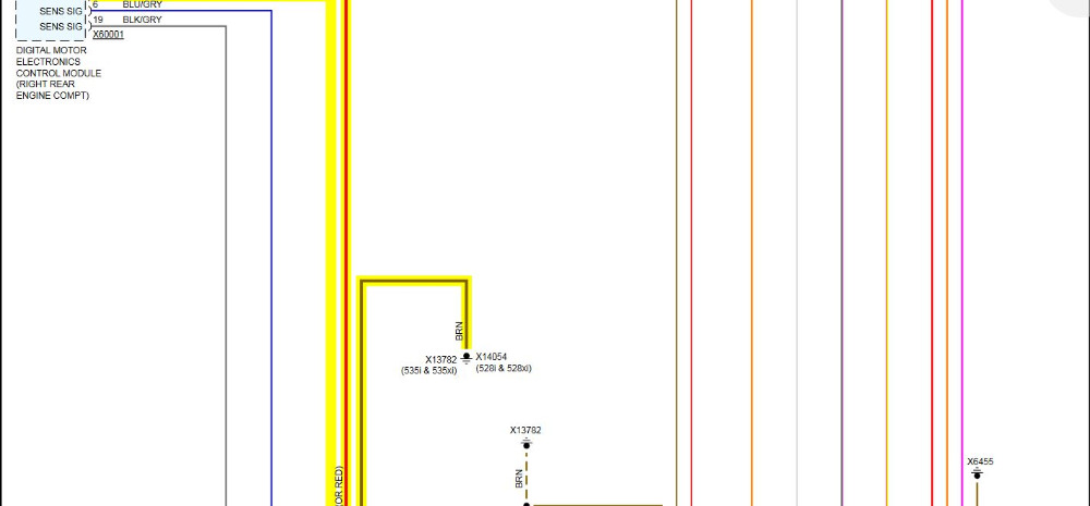

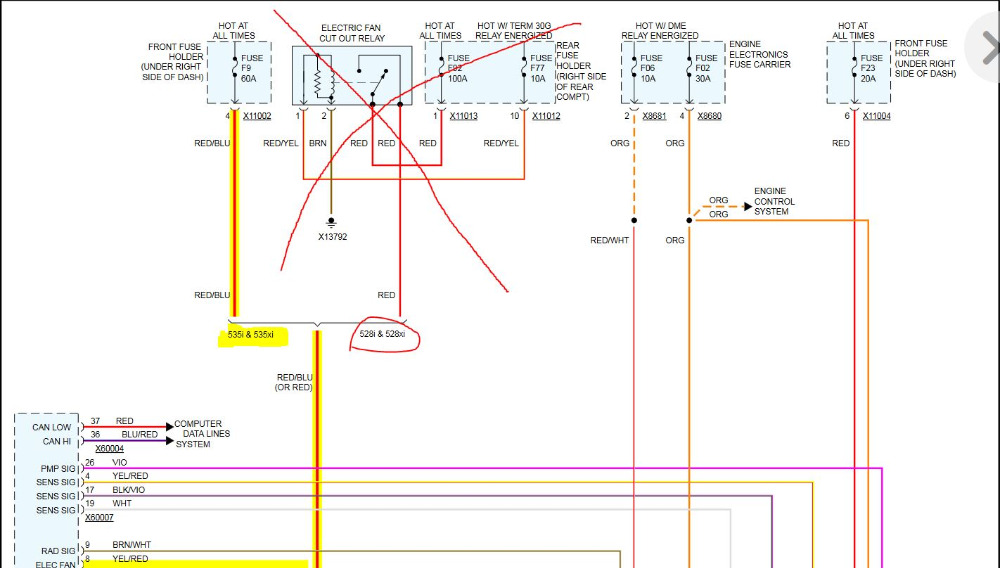

Hey guys I have this issue that was handed down to me at the shop. Bmw was overheating and had some codes stored from what they told me. Thermostat housing was replaced. Water pump was replaced and the radiator. It's still overheating and i asked was the bleeding procedure done? Answer was no so i went ahead and did the procedure twice and the pump is coming on and dandy . Turned on the car and watch scan data and temperature was climbing to 212 degrees and i look outside and fans not kicking on and warning light comes on that the engine is too hot and pull over to let cool down. So i can be directionally control the fans and it comes on high like a jet. I tap on to the signal wire and i have a signal and still at 212 degrees this fan doesn't kick on. If i turn on the ac the low speed fan does come on but by itself idling it doesn't kick on. At the moment there is no codes stored and I'm stomped. Alldata really doesn't have much info on this but on bbby industries I found a diagram of the layout of the coolant system and the fan has 3 wires and the heavy gauge red wire is being fed power from a 100 amp then it shoots to a cut out relay on the load side. The control side is being fed 7.5 amp fuse and the DME is controlling it. I can't find this cut out relay and no good diagrams out there. So that why I tapped into the signal wire from the computer at the fan. With the car off I have roughly 5 volts on the signal wire and I'm like how is there power with the car off. So I unplug it and it goes down to zero. Plug it in and same 5 volts. So I started the car and let it get hot again and turn it off and i see on the scope that it's at 9 and half volts almost as if its staying on to let the car cool off but the fan is not turning. Unplug and drops to zero. Plug it back in and it has 6 volts. I stay watching it and voltage starts to climb down. Dont know if this is normal but without good info I can't make a call on the fan assembly. But that's just odd to me voltage is there with the car off. Am I barking up the wrong tree guys. Any help would be much appreciated. Thank u

It looks like the cut-out relay is for the 528i, not the 535i.
Copied and pasted:
Functional description
The electric fan is controlled by the engine control unit via a pulse-width-modulated signal (evaluation by electronic circuitry in the fan). The engine control unit controls the various radiator fan speeds by means of a pulse-width modulated signal (between 7% and 93%). Pulse duty factors less than 7% and greater than 93% do not trigger activation but rather they are used for fault recognition purposes. The speed of the radiator fan is dependent on the coolant temperature at the coolant outlet (radiator) and the pressure in the air conditioning system. When the cars driving speed increases, the speed of the radiator fan decreases.

Hey pole those colors on that wiring diagram does not fit my car. It's a heavy gauge red wire and heavy guage brown wire that is ground and the black and green wire that is from the computer. These guys changed the whole thermostat with the sensor in it. New radiator and electric water pump. All these were dealer items. On scan data coolant outlet radiator or something like that is reporting more than two hundreds degrees. Indicating to me the thermostat is opening. I didn't check the hose to see if it was hott but if everything is new why wouldn't it be. I know exactly what temp sensor u are talking about that sits right on top of the radiator outlet hose right side of radiator but this model doesn't have it. 2011 bmw 535i twin turbo. Thank u my friend

Jay2034 wrote: Hey pole those colors on that wiring diagram does not fit my car. It's a heavy gauge red wire and heavy guage brown wire that is ground and the black and green wire that is from the computer.
This is for a 2010 BMW 535i.

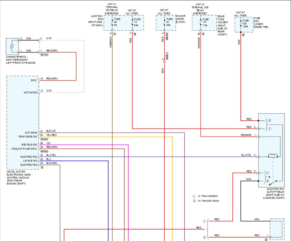

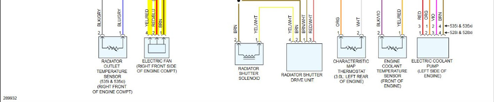

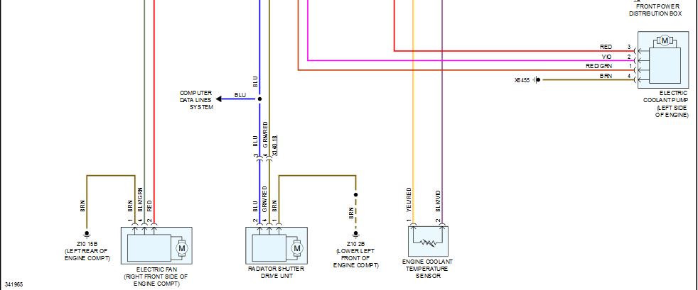

Yeah Andy it is crazy. I'm growing grey hairs over this. Alldata has good information and I was reading and I back probed the coolan6 temp sensor to see if it is reporting accurately and to the ac pressure sensor as it says the fans operate depending on coolant temp and ac pressure in system. These fan units has an internal something built in which is probably why I have voltage on the signal wire with the car off plugged in and no power unplugged. I thought the computer driver was sending that voltage.
