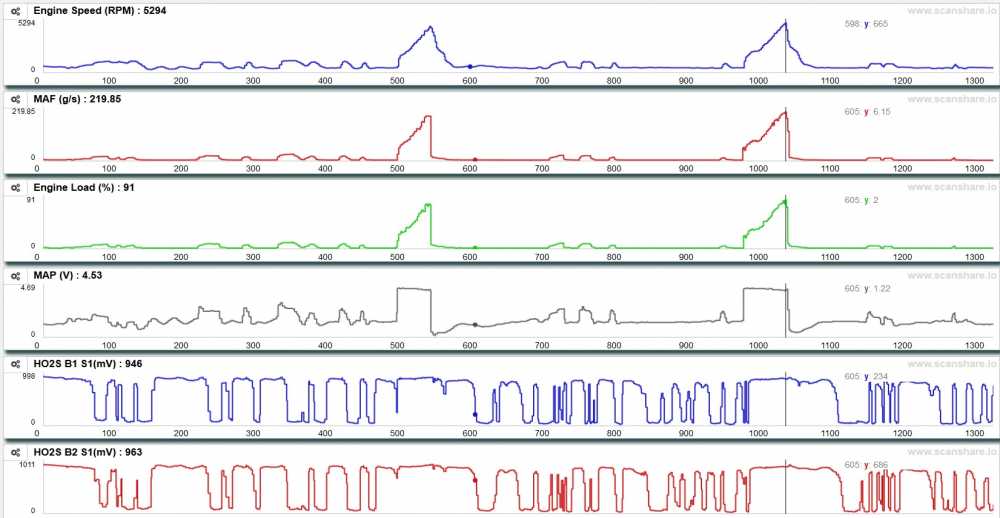

Looking at your data captures, and I'm somewhat confused. It lists short and long term trims for B1 and... B3? That might make sense if they meant B2, but no engine that came with the 2000 Malibu has bank-to-bank fuel control :huh: In the North American market, anyway. What is the engine size?
The values associated with the trim PIDs are unusual, as well. At one point I saw 97% on a long term? No fuel control strategy is gonna allow for that much correction. It may be that those trim numbers are actually Global-specific PIDs related to the O2 sensor signals. I can grab some data off my car and explain these PIDs better later on.
I'm also thinking along the lines of a plugged catalytic converter, especially considering the misfire history and possible rich condition. Scan data could definitely help point us in the right direction. If you can, use the Enhanced data to capture some PIDs during a WOT acceleration through first and second gears. Here's a ScanShare link to a known good capture with the stuff we're interested in:
www.scanshare.io/share/PthKNw1SfUGJnZW7S...1,2,3,4,5,6,7,8,9,10
In case that doesn't work, we're looking for MAF, MAP, TPS, engine speed, Load, upstream O2 sensor, and fuel trims. Watching those PIDs on a WOT run will definitely expose a breathing problem if there is one.
This ScannerDanner video also explains the test we're doing, and what the results mean. The make/model and problem are different from yours, but the test itself is the same:

Perfect. The MAF frequency, MAP voltage, engine speed, Load, fuel trims and the upstream O2 would be ideal for the WOT test.
if I am ok with these parameters, Can I give it a shot? WOT in 1st and second gears....??
ALSO, why is it important that we perform this test during 1st and second?
Good to go B) Safely, of course. Doing it at WOT in first and second is important because it heavily loads the engine, asking a lot of the fuel system AND the engines breathing ability. The overall idea is to determine if a lack of fuel is causing the hesitation/poor acceleration, or a breathing problem. It's not a pinpoint test, but it will point us in the right direction for further diagnostics.
As an example, here's a shot of a known good '01 Silverado 5.3L doing the same test:
www.scanshare.io/share/PthKNw1SfUGJnZW7SEl4Og#0,1,2,4,5,6

Hey, thanks for responding. Are you absolutely sure there's only supposed to be 2 fuel trim values for a 3.1 V6? I thought that only applied to inline 4 and six cyls. I find it odd that i'm getting full readings in the global parameters * which i hear is best to default to* in most troubleshooting cases, and incomplete values in the enhanced parameters.
Or, is it that some V6/V8s feature separate bank controls?

Tyler's right. I missed it the first time I read through this, but those cars only have one cat, one upstream o2 and one downstream o2.
There's no way to have more than one stft and one ltft.
10 years 2 weeks ago #2458 by Tyler
Replied by Tyler on topic 2000 Chevy Malibu acceleration issue
Yep, what Noah said, 100% sure there's only one upstream O2 on this engine (and the 3400 and 3800 of this generation, for that matter).

Here;s a really brief video showing the parameters during WOT ( or kinda WOT). I really didn't feel comfortable doing this test given the age and condition of the car. . Hopefully its enough. RPMS sky rocket but the car takes a second or two or 3 or four to respond it seems. The car does a lot of gurgling and stuttering, really struggling to get out of its way. Seems like its misfiring..

at the 24 second mark your at 4700 rpm's and the maf g/s is only at 95. seems low

are you doing a w.o.t test in a lower gear? or just in drive??
  • Donnyten
  • Donnyten's Avatar Topic Author
10 years 2 weeks ago - 10 years 2 weeks ago #2508 by Donnyten
Replied by Donnyten on topic 2000 Chevy Malibu acceleration issue
Yes I am. doing it fro ma dead stop at a stop light. switching from gears 1-2 as suggested ( not manually, but letting the car auto change gears of course)
Last edit: 10 years 2 weeks ago by Donnyten.
10 years 2 weeks ago #2510 by Noah
Replied by Noah on topic 2000 Chevy Malibu acceleration issue
.Hopefully its enough. RPMS sky rocket but the car takes a second or two or 3 or four to respond it seems. The car does a lot of gurgling and stuttering, really struggling to get out of its way
Uh oh! The delayed engagement sounds like a transmission problem.
Have you checked the trans fluid level and condition lately?
