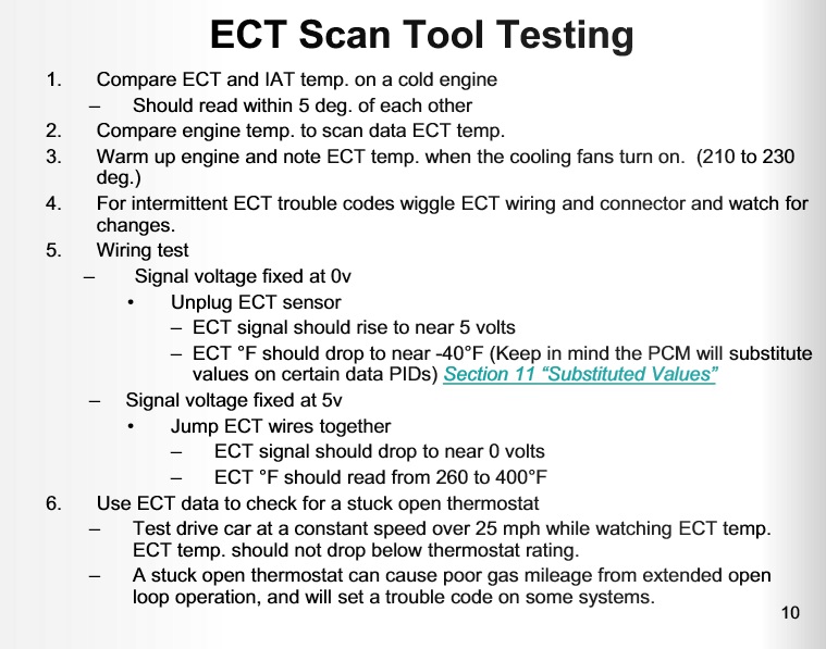

8 years 11 months ago #12782 by Tyler
Replied by Tyler on topic P0118 non start issues
If you're positive that you're on the correct ECT signal wire, then you might be headed for an ECU. :-( Thermistor signal circuits can't share a direct 5V reference source with other sensors, so there's no need to go around disconnecting other sensors. The video below perfectly explains why this is:
The last test I can suggest doing is checking the ECT sensor signal wire for a resistive short to ground, which would cause the 5V signal to get partially pulled to ground. You can test for this two ways. One would be to disconnect the ECT and the ECU, and use your ohm meter to check the wire for resistance to B-. There should be ZERO continuity.
The other is to cut the ECT wire close to the ECU connector. Somewhere easily repaired once you fix the issue. ;-) Now recheck the ECT signal wire voltage at the cut end of the wire. If it's still 3.3V, then the problem is in the ECU connector or the ECU itself. If it's up to 5V, then there's a resistive short in the circuit.

8 years 11 months ago #12810 by mckenzie
Replied by mckenzie on topic P0118 non start issues
Thanks for taking the time with this, the video makes sense.
I didn't mention that I already cut the wires close to the ECU & still measured 3.3v. I also managed to probe the ECU pins directly with the connector unplugged, still 3.3v.
I've just taken your advice as well & disconnected b+ & ohm tested from ECT signal wire to B- & I am getting 1.175k.
If your 100% sure that this is conclusive that the ECU has developed an internal fault then I will go ahead & arrange for it to be repaired.
I am still left wondering what has caused it to fail. The way the thermistor circuit works appears that the internal resistor should keep it fairly full proof if anything happens externally , I guess not?

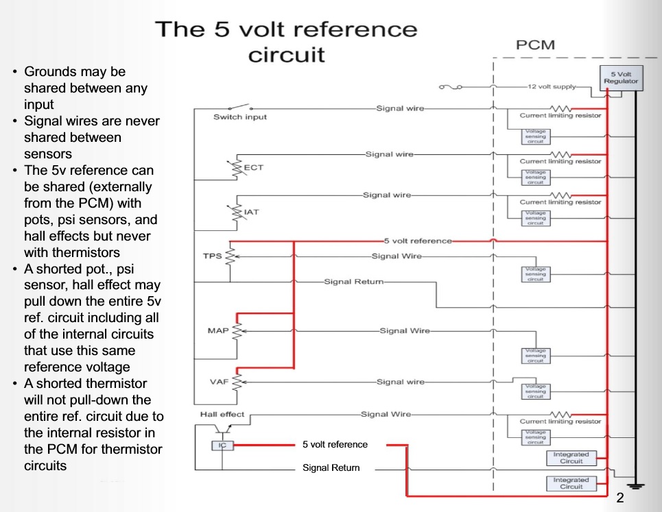

Thanks. Just to make sure I really understand the voltage divider circuit, is it the case that in order for it to function properly it needs its own dedicated 5v & this 5v cannot be shared with any other sensors. The ECT then will have its own dedicated 5v regulator? This is probably what you were pointing out with the video but I want to be absolutely sure I get it!

Actually I've just learned that any 5v thermistor reference cannot be shared with a potentiometer reference. But, could it be shared with another thermistor like the IAT sensor ? It doesn't appear that way on my wiring diagram though, the ECT goes straight to the ECU.
Sorry for my lack of knowledge !
8 years 11 months ago #12847 by Tyler
mckenzie wrote: Actually I've just learned that any 5v thermistor reference cannot be shared with a potentiometer reference. But, could it be shared with another thermistor like the IAT sensor ? It doesn't appear that way on my wiring diagram though, the ECT goes straight to the ECU.
No worries at all! :cheer: The relationship between potentiometers, thermistors and the 5V reference is kinda weird if you're unfamiliar... This diagram from Engine Performance Diagnostics really helped my personal understanding of these circuits:
It's the high value resistor (current limiting) on the thermistor signal circuits that makes them unable to be shared with other 5V sensors. It doesn't have it's own 5V regulator, but each thermistor does need to have it's own signal wire.
This is somewhat related to what I think is wrong with your ECU. ;-) It's possible that the circuit from the 5V regulator to the current limiting resistor (or the resistor itself) has developed TOO much resistance, and is now bordering on an open circuit. Or, the ECT signal after the current limiting resistor is getting partially shorted to ground inside the ECU, before it leaves the board.

One last thing, I've seen on some cars there are ref1 + ref2 circuits, does this imply two separate internal 5v regulators ? If so, is it possible that my ECU has two 5v ref circuits & that one of them is indeed being pulled down externally some how & for whatever reason hasn't thrown up any more codes on the Diagbox ?
My (french) wiring diagram isn't too helpful & doesn't show voltages.
Sorry if this is a dumb question given what you have told me in your last post, but it's bugging me nonetheless!
I promise I won't bug you again after this :)
Last edit: 8 years 11 months ago by mckenzie.
I find that the distinguishing feature that defines if a ECU has multiple 5V regulators is if the engine uses a drive-by-wire throttle. Because drive-by-wire systems use multiple potentiometers on the throttle and accelerator pedal, the ECUs are designed with multiple 5V regulators, a safety feature in case there's an issue with one circuit or the other.
As an example of multiple regulators in action, check out this thread:
scannerdanner.com/forum/post-your-repair...am.html?limitstart=0
This Dodge uses two 5V regulators, and one of them is producing 5.81V. :silly: We determined that by looking at all the 5V users on the wiring diagram, and saw that some got supplied by one pin on the PCM, and the rest by another pin. The other regulator was producing 5V as designed. Weirdness. :lol:
That's all a bit off topic, though. The cool part about thermistors is that, because of that current limiting resistor, they cannot cause issues with other 5V sensors, or the 5V regulator itself. Even if a thermistor was shorted directly to ground, the 5V regulator wouldn't notice one bit. ;-) That's because there'd still be 5V on the other side of the limiting resistor.
Actually, one of the universal quick tests for thermistors is to short between the two pins, and watch for the scan data to change accordingly.
If you want to make absolutely sure that your 5V regulators are still healthy, you can always check other 5V sensors. Or, if your engine uses a drive-by-wire throttle, you can go to the APP sensor (the gas pedal) and check all pins available. At least two of them should have 5V.

8 years 10 months ago - 8 years 10 months ago #12885 by mckenzie
Thanks! The car does have electronic throttle yes. I don't think I asked the question properly though. In the 5v reference diagram you posted there is a 5v regulator that feeds both the ECT & IAT but the same 5v also feeds other sensors as well internally, TPS MAP etc. What if one of these other potentiometer sensors or the external wiring to one is the pulling down the voltage?
I get that externally the 5v can't be shared between pots & thermistors but the diagram shows the 5v is shared internally. What if I have a second 5v ref regulator that is, like the diagram shows, internally feeding both the thermistor & also some other pot sensors.
Basically to me it seems to appear that a 5v reference can indeed be shared between thermistors & potentiometers, so long as its internal & before the current limiting resistor. In this scenario it seems possible that a pot sensor could affect the voltage supplied to a thermistor?
I've only managed to find two other sensors which were camshaft exhaust & camshaft inlet, these are both a good 5v. This engine is bay is super tight!
Sorry, not trying to be smart here or anything!

8 years 10 months ago #12936 by Tyler
Ah crap, you're right, I misunderstood your question. My bad!
One regulator or the other could be supplying low voltage. BUT, I think this is unlikely because you're not seeing any other fault codes. If the 5V was truly that low, there would be other sensors that would never read correctly. ScannerDanner: "Make sense?" :lol:
The best way to check this would be to find the APP and check both 5V reference wires there. If you have 5V on both, I'd say you're in the clear.

8 years 10 months ago #12941 by mckenzie
Thanks, so if any other sensors saw 3.3v they would just not read correctly or read out of range & throw a fault code? Any chance they would just continue to function but read an inaccurate value because the reference is wrong ?
I will have look at the APP like you advise.
Thanks again for the great help here :)
8 years 10 months ago #12952 by Tyler
It's possible some may continue to work? But you'd be guaranteed to have other driveability problems. All airflow, pressure sensors or potentiometers would be sufficiently skewed low that you'd notice some kind of problem.
Hall effects would definitely notice, and probably wouldn't work at all.
Let me know what you find at the APP! :cheer:
