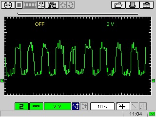

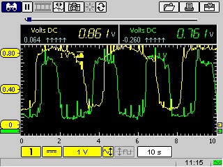

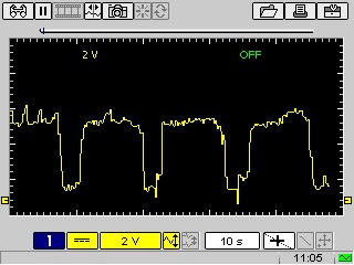

8 years 10 months ago - 8 years 10 months ago #13815 by John Clark
Replied by John Clark on topic Re:2006 Mercedes CLS55 AMG O2 Sensor Codes
I've got the vehicle back and have put the scope on the O2's. The MIL is off at the moment but the same codes are still stored. The downstream O2's seem to mirror each other so I didn't take any scope screen shots of them. However, the upstreams are significantly different. Bank 1 (bank with the codes) seems to cycle rich-lean much slower than bank 2.
Here is my 'known good' bank 2 upstream sensor at about 2500RPM:
Here is my bank 1 upstream sensor at about 2500RPM. As you can see it stays rich while the other bank drops lean and back to rich in the same time frame:
Not sure it's helpful but here is a screen shot of both banks at the same time at about 2500RPM:
So, what would cause the O2 to stay rich like that on bank 1 for longer than bank 2? Long term fuel trim on bank 1 at idle is about +4.8 and short term is around 0.0. If I run the RPM up to 2500 the long term stays around +4.8 and short term goes up to around +7-10%, indicating to me a slight lean condition on bank 1 at higher RPM's.
It doesn't appear to me to be a vacuum leak. What would cause a slight lean condition on one bank and not the other that gets worse with higher RPM? The two items Paul always talks about are MAF and fuel delivery. There is no MAF that I can find. Could it be a dirty fuel injector? It is supercharged and I cannot find a MAF on this engine. Does anyone have any thoughts?
