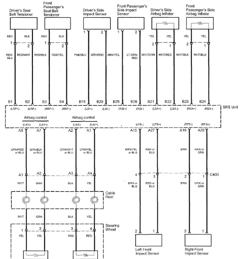

8 years 9 months ago #11566 by Tyler
Replied by Tyler on topic '05 Acura TSX DTC 54-50
Yeah that sure sounds like a death code to me. :( Is this a hard failure? Or, does it come back intermittently?
If it comes back immediately, then I'd suggest testing module powers and grounds. I attached the ABS wiring diagram for reference. B+ on pins 1, 16 and 38. Ground on pins 32 and 47.

I try! :lol: I'd go with a backprobe and an incandescent test light, KOEO. A DMM with work, too. Check the powers with the test light connected to B-, and the grounds with the light connected to B+. If they all shine bright, then it's module time.
I just noticed that you attached the ABS diagram and I am having trouble with the airbag light.
Is it throwing a specific code? I get these from the BBB Industries site , FYI.

I was trying to figure out if these were the front sensors or side, thinking that it just meant right-side, meaning the right side of the car in the front. The parts diagrams seem to call them front and rear. If both fronts deployed that would make more sense than both sides.
I had the same thoughts while looking at the diagram. Both side impact sensors going bad makes almost no sense to me. :unsure:
