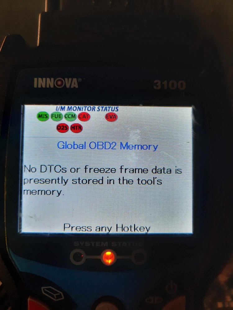

Ok thanks , I dont have a fancy scan tool, I do have a code reader ( Innova 3100 ).

Was looking at different scaners , what are your thoughts on the TAPDON AD500 ,
not sure if it will give me the info to me need .

1 year 7 months ago #66606 by Jerry McGillis
Replied by Jerry McGillis on topic coil pack
[img]454469990_1747765292515447_2050918322872189827_n[/img]
have had thies for over 5 years, can they have anything with the problems i'am havein ?
