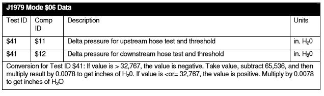

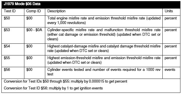

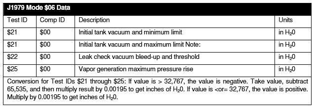

Here is some info from Ford that is free at www.motorcraftservice.com/FreeResources/OBD
Looks like $56 has to do with misfire events, not sure. Maybe someone could comment on this.
This one has to do with the EGR DPFE sensor.
This last one is for the EVAP system, obviously not a concern for what you are having problems with
The test id $53 id $04 is a cylinder specific misfire with 108 events. Cylinder number 5 if I am correct (I always get confused on the numbering).
